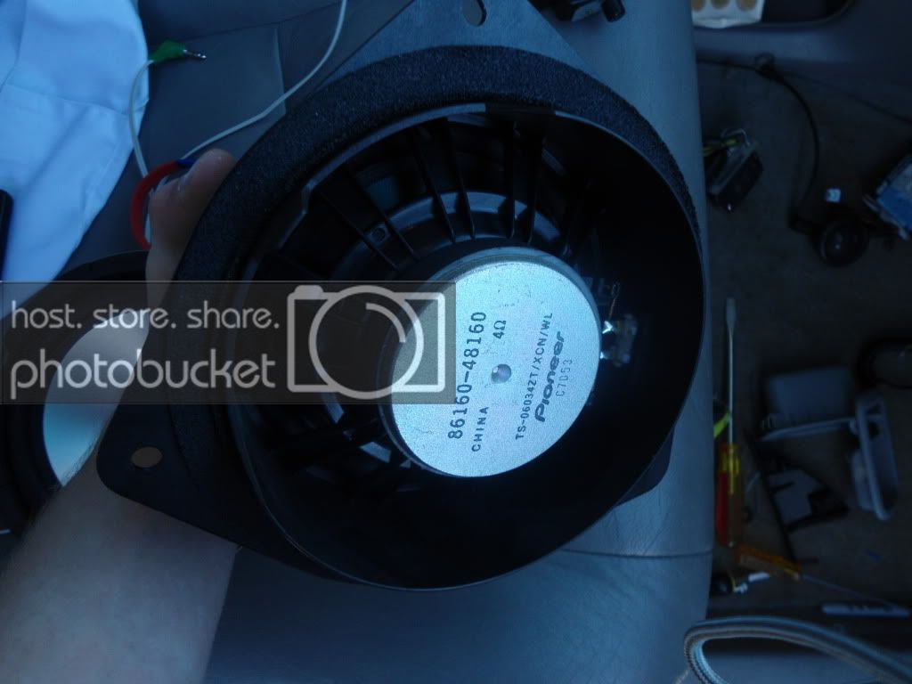

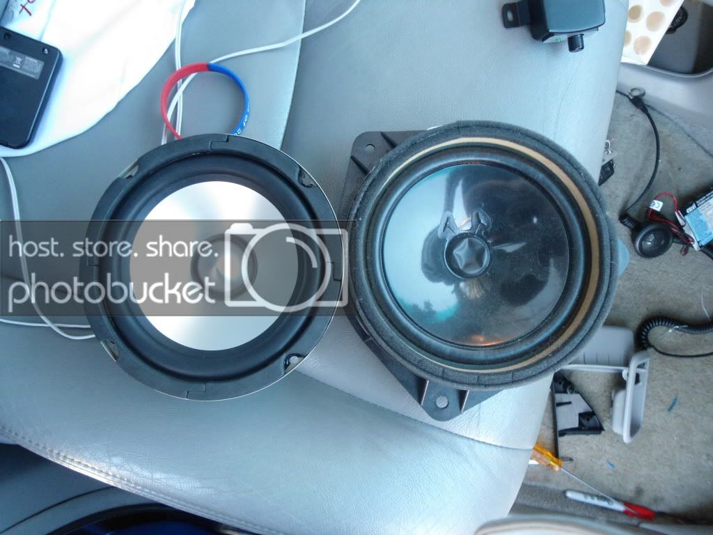

Just got some new speakers for christmas and i don't even have the bracket for them ( lol ) its my fault i thought that the speaker would come out of this stock thing but it looks to be the entire speaker??? kinda dumb.
it has to be pretty far out and this link i found for my car:
Speaker Brackets 5-1/4" or 6-1/2" speaker adapter plates for select 1999-up Audi, Buick, Ford, Hyundai, Kia, Lexus, Mercedes, Scion, Subaru, and Toyota models at Crutchfield.com
will not work i need a good inch and a half extra plus that bracket or so... so it doesn't hit the window.
are there cheaper ones or extended ones???
pics.
i was thinking ordering just a mount then buying some ****** wood or something or looking for some around my garage and just make like 3 spacers out of the wood and mount the speaker on it?
unless people make things like such ^^

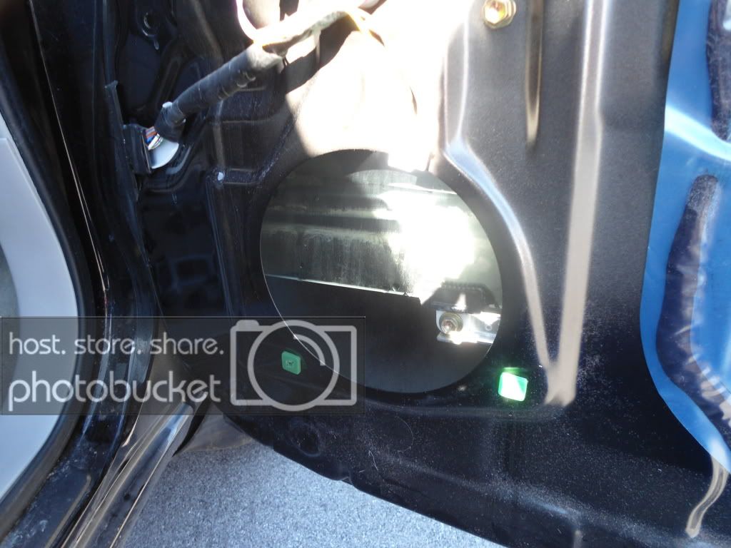

You are correct sir. Build a bracket out of mdf. Use the bracket from the stock speakers, trace it, then cut it and mount it in your car. If you want to create a nice seal, which you should to create the midbass I assume your looking for, buy some sort of air tight adhesive and put it on your door. Good luck!

Since all your doing is making a speaker adapter for a regular car and not an sq comp car any kind of wood will do.
I recommend using plywood for baffles anyway. Plywood does not soak up water nearly as easily as MDF does, even if you paint it. Have you ever seen a speaker box that got wet? Lots of black mold and it swells + falls apart. Paint your plywood baffle after you have made all cuts, holes, etc.
Use automotive autobody sealant between the baffle and door. You buy it at automotive stores or even some well stocked grocery stores have it. Use sheet metal screws and screw the baffle to the door. Do your wiring and mount your speakers.....done! Takes about 2 hours and you will have a very solid foundation for your speakers.....which this alone will improve the SQ considerably over mounting into the existing holes.
thanks guys! i will go out tomorrow as i think lowes is closed... i was thinking just making a flat piece that is basically a triangle with the circle in the middle, then making like 2-3 more circles and just stack them ?
