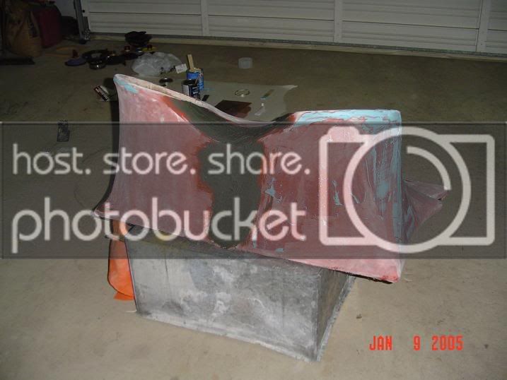

Not poo - That's Bondo-glass...for strength and it blends the seams very nicely //content.invisioncic.com/y282845/emoticons/handclap.gif.0c301076f534e244f0460706894f19e0.gif
Looks good Nick //content.invisioncic.com/y282845/emoticons/smile.gif.1ebc41e1811405b213edfc4622c41e27.gif
Pic 2 ... dead woofers in the background? //content.invisioncic.com/y282845/emoticons/tongue.gif.6130eb82179565f6db8d26d6001dcd24.gif
- Steve
yep thats some that didnt make it
LOL
what is wet sanding?
It is what you do when your finishing a surface..Use water and a tiny bit of automotive grade soap..keeps the paper from clogging up and you can see the surface that you are working on much easier...and feel the blemishes in it as well..
hahahahhahahalooks a little sloppy too
That's the natural texture of bondo right after spreading it when it's mixed a touch hot.... Nick!...lol
but just grab some 120 grit and go to town and it will be somewhat smooth....then the process will prolly be sand it all down wet style with 240, the next part is going to **** though - hunting down all the tiny pin holes here and there and filling them with automotive putty filler, then resanding...
Glass/bondo is EASY, but a total pain in the ***...lol

120 grit? dude you have no balls
40 grit all the way on that shit //content.invisioncic.com/y282845/emoticons/smile.gif.1ebc41e1811405b213edfc4622c41e27.gif
BTW - it's 5min glass or none at all..i don't play around waiting on stuff to dry //content.invisioncic.com/y282845/emoticons/smile.gif.1ebc41e1811405b213edfc4622c41e27.gif
