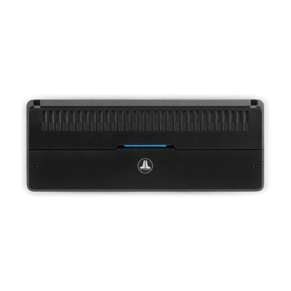

I was actually just about to email you about your thoughts on these. Figured it'd be more cone area than that 15" and would actually fit with no issues. Just curious if that 1500 watt amp would be enough for 2 of these.
What do y'all think? How would this do on 2 of these?
If you mean the 800w subs, it would be a little underpowered, but would probably still sound good. Let me know if you still want to look at other woofers.
