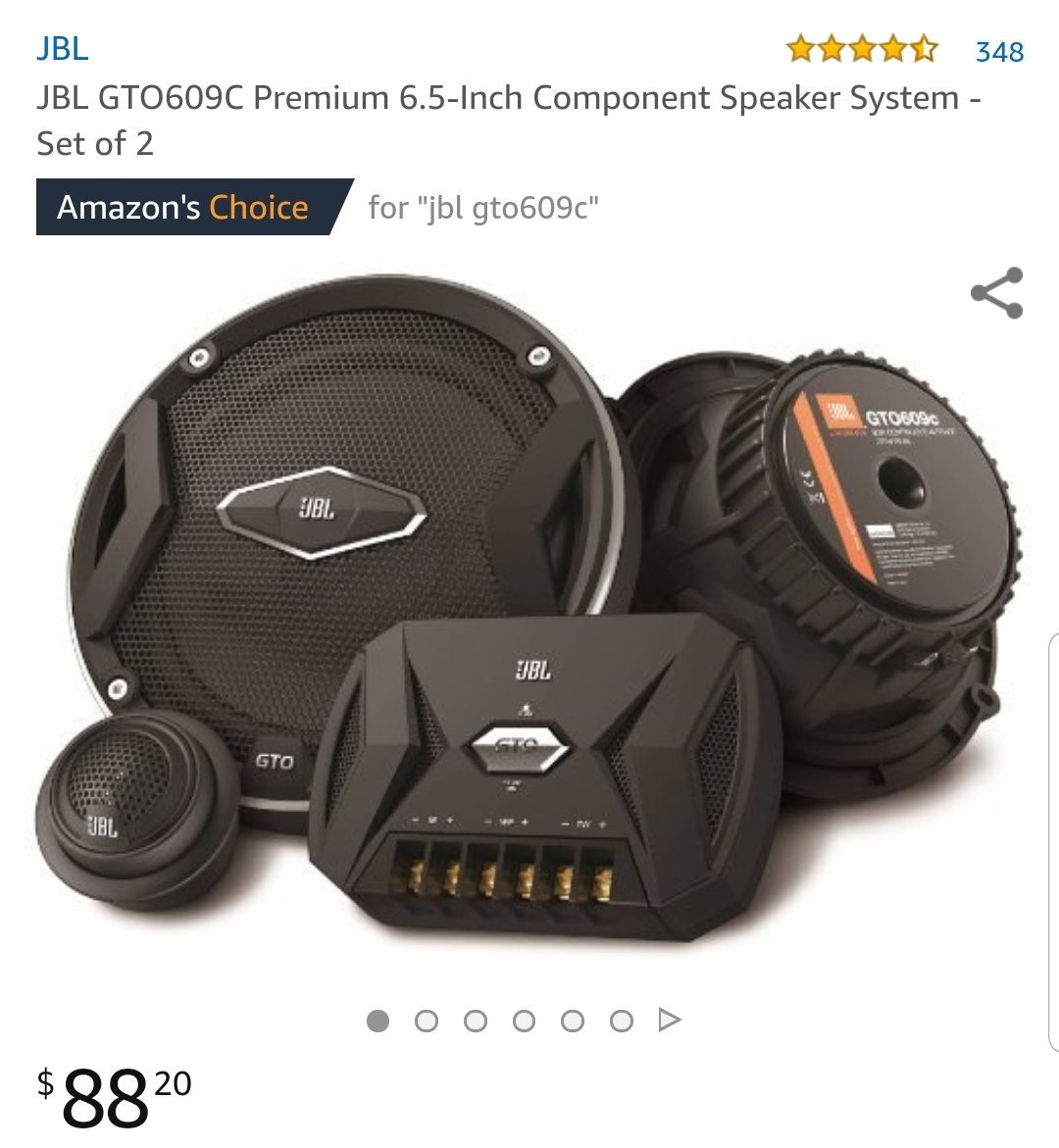

I would suggest that you sell the front speakers and grab a decent set of 6.5" components. Like these JBL. Get the tweeter off the floor for some better imaging.
I don’t think that hu is active. That said (unless I’m wrong) and your effort not to spend a bunch of money a Comp set us a good option run off your amp bridged. Rears not needed.

I thought this might be the first suggestion. My RF’s are brand new but I can consider this if I could find a buyer. They were about the same price. What is your opinion on adding a DSP or EQ with time alignment ?
