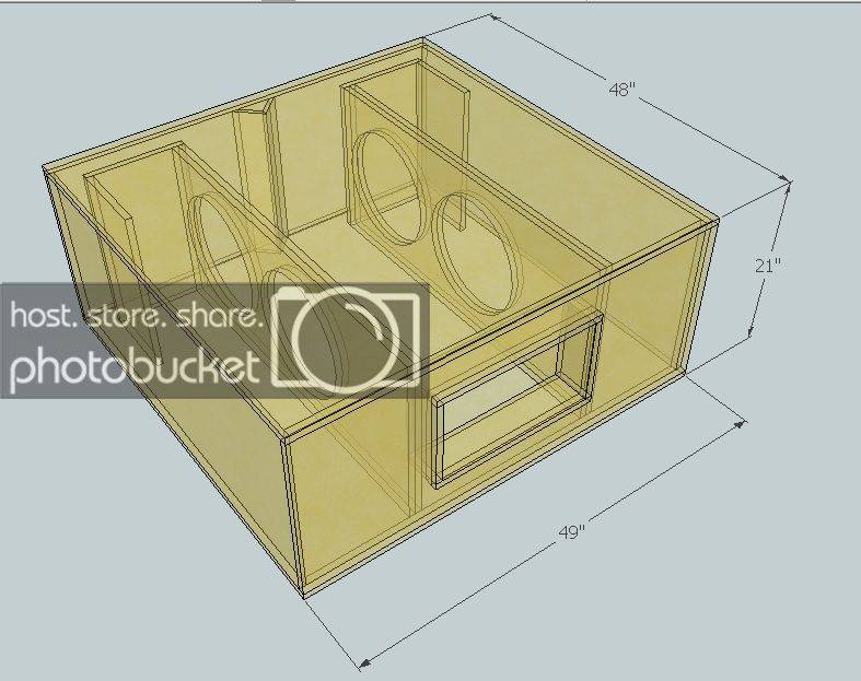

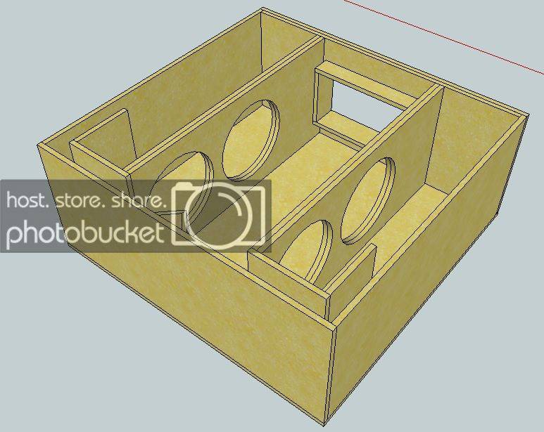

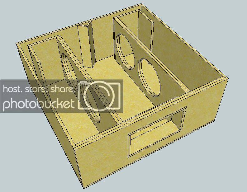

New box to build in the next week.
What is the volume of the chamber tuned to 29 and the volume tuned to 56? Also what size subs? Looks awesome!!! I really would like to get an Avalanche due to all the great box options it would offer.
Ea side chamber is 5.08cu tuned to 29Hz. The center chamber is 9.89cu tuned to 56Hz.4 15"s will be in this box as a blow thru into the cabin.
