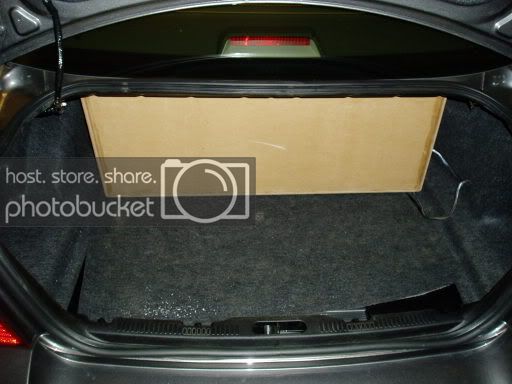

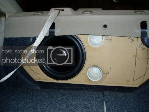

Here is the latest box for my 15 inch Mag, the box is about 3.7 cubes tuned to 28hz using two 4 inch pvc pipes. There is some port noise when I have it cranked on low bass like late nite tip but you cannot hear it from the drivers seat. On 95% of the music I listen to it will not be a problem. It sound great and gets very very loud to my old ears.
The car is a Ford Fivehundred, the Mag does not need that big of a ported box 3.5 is what the site says and the sealed is between 2.5 and 3.0
I am probably going to cover it with vinyl and build a false wall. It sounds good facing this way, when it faced the tailights I had some nasty noise I did not want to spend hours and $$ on this car to deaden the trunk like it needs to be, it is a company car and I will not have it in about 1.5 years.
