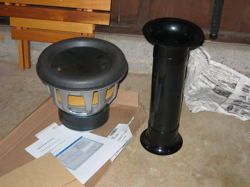

12w7 & 4" Precision Port next to it to give an idea of how big the port is.

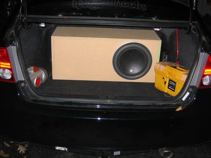

Finished Box: Roughly 2.3 Cubes internal. Tuned to 28hz.

Better perspective of what my trunk space is now.
I listened to some low-tuned songs and this thing plays them pretty dang well. I'm going to adjust the settings on my amp and try to fine tune it but overall I'm psyched on the playback. Everything sounds VERY clean and precise. Got rid of that extra boom that I was growing tired of but still plenty enough in reserve (I have the subwoofer setting on 4 but can go up to 15 on my headunit) in case I want to bump some music.
I'm very impressed at the fit. Also, the new box is 30 pounds lighter. With my previous box I couldn't even lift the thing out of the car without help and I had to use a wheelbarrow to carry it into the garage this morning cause there's no way I could carry that thing myself. With the new box, I carried it to the car and sat it in, pushed it back and that was it. I'm going to carpet it soon. I'll have to deaden my trunk lid tomorrow with the excess from my door deadening project last weekend. I only have about 6 square feet left though so I'll be ordering more later.

I honestly don't know if it pounds yet. I'm letting the wood glue dry overnight before I crank it up too loud. Plus, even if it does I won't be doing it much since I don't have the trunk deadened yet.

you only got one port?
Yea. 2 wouldn't work because I don't have enough room in the box for two. I listened to the port at max volume and there was some port noise, but nothing that I wouldn notice at all from the inside of the car.
