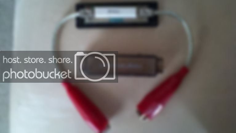

Almost yes with batt+(fat red one) being the very last thing hooked up. Here's the almost: If you hook up all your amps, and leave the main fuse out until the very end, when you put that fuse in you are going to get some nasty arcing due to the caps in the amps filling up. This is why ol' brooklyndouches idea was never brought up by me, because doing that can cause the fuse to possibly pop. At the very least, it's scary( a little) and can ugly up your fancydancy new fuse holder. If you instead put the fuse in, THEN hook up the batt+ terminal on the batt, the sparking will happen there instead and it will be less noticeable. Warning!! If you have been charging the batt for some reason, there may be some gases around the area of the batt which could explode. Just make sure the area is well ventilated and you will be fine.
To answer the possible question coming up: to be able to hook up the positive without any sparking you need a large resistor in line between the batt and the wire. This will cause the caps in the amps to slowly fill up thereby stopping the arcing.
This is an example of such a resistor:
This particular one came with a Lightning Audio 50 farad hybrid capacitor. They are available through any electronics supply type store ( think Radio Shack and the like) or your local electronics repair guy will have them or be able to order them.
