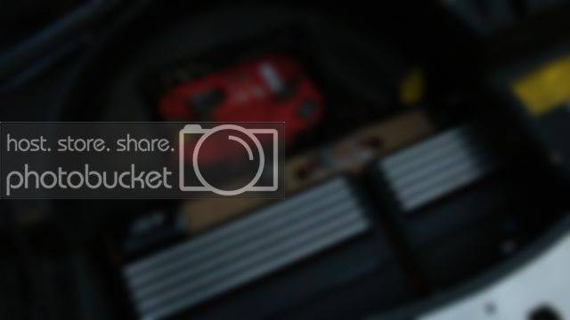

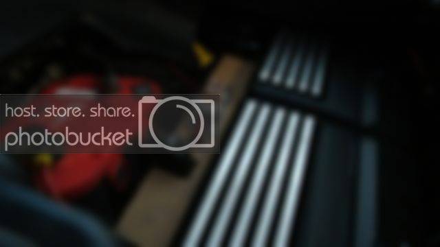

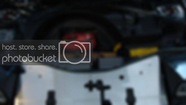

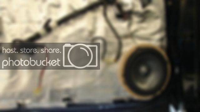

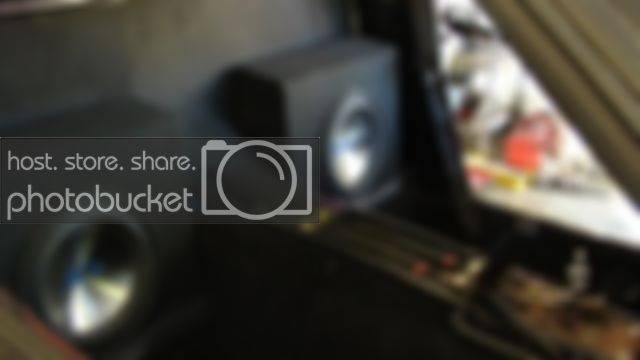

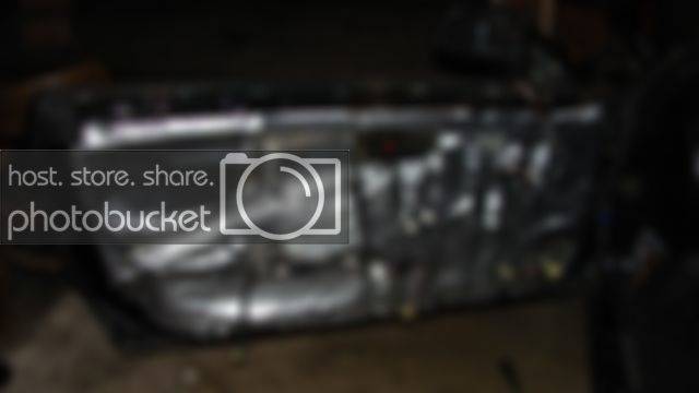

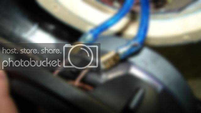

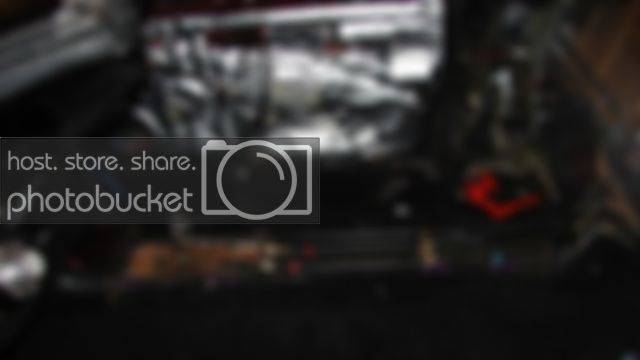

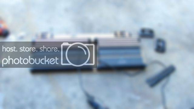

Whats wrong with that! lol. It gets so loud in there now...but still not as clear as I hoped. Here are some pics of my semi-clean install. Hey, its an old car what do you expect. But man o man. BOOOOOOOOOOST. =D
-Aaron
