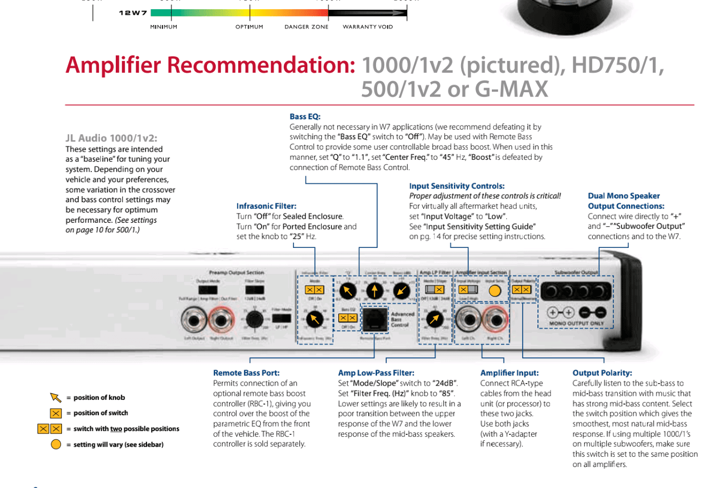

These are the settings that JL Audio recommends for the 12w7, but I think should also work for the 12W6.

for crossovers, 80hz is a good starting point but depends on your gear
did you set your gains right? heres how. test tones are at the very bottom...
Thank you it sounds way better then it was And I fixed why it was cutting off it was because of bad power because the full range amp was losing power to
