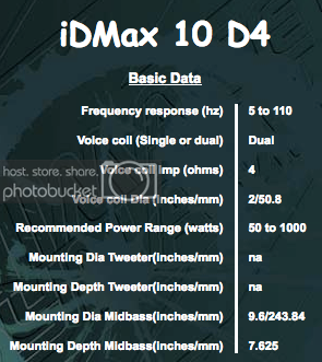

EDIT: (Changed my order to 2 IDMAX10 D4's)
Just copped 2 of these and need sum advice on what to power em up with.. specs below. THANKS!!

Good luck matching power with dual 2 ohm subs and a single amp since your final load will either be .5 ohms or 2 ohms.
Then again, in your case I would either run dual amps.... one per sub @ 1 ohm each, or strap a pair together at 2 ohms. Regardless of what anyone else says on here.... I don't recommend .5 ohm as a final load for ANY amplifier on a daily basis.
ETA: If you were competing and had a strictly dedicated competition vehicle, .5 would be fine and there are a few amps that are designed with a .5 ohm load in mind!
kicker zx1500.1 peaks at 2 ohms and would provide 750 watts per sub. im not a fan of kicker by any means though.
i would just run 2 amps and put each sub in a different enclosure unless amps are strapped.
