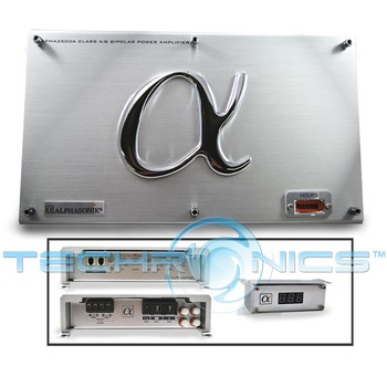

This is a factory refurb Class A/B by one of the best in the business. It comes with a remote voltage meter to help ensure you keep power within it's recommended operating range of 13-14.5 volts. If you are willing to pay a little more attention to voltage fluctuations and can understand the included directions for use in bridged mono operation. This amp was $700 new, it is big and has no problem doing clean rated power down to 2 ohms. As long as you do the required electrical upgrades it would take for that HiFonics, SS, or Quart to operate without failure. Why did the SS fail??
Alphasonik PMA2500A-RB 2-Channel Class A/B Bi-Polar Power Amplifier
you cannot hardly find a used one for $200 bucks.
Features:
Alphasonik PMA2500A 2-Channel Class A/B Bi-Polar Power Amplifier
RMS Power Ratings:
500 Watts x 2 @ 4 ohms Stereo
800 Watts x 2 @ 2 ohms Stereo
1500 Watts x 1 @ 4 ohms Mono
Hour Meter
Remote Mount Digital Voltmeter Included
Heavy Duty One-piece Extruded Aluminum Heat Sink
Beveled Clear Acrylic Protective Cover
Tiffany-Style Input and Output RCA Jacks
Parallel Line-out RCA Jacks
MOSFET High Speed Switching Power Supply
Milspec Double-Sided Glass Epoxy Circuit Board with Through-hole Plating
Heavy 4 oz. Pure Copper PC Traces at All Preamp and Amplification Stages
Solid Brass Nickel-plated Terminal Blocks (4-gauge Power, 8-gauge Speaker)
Terminal Blocks are Compression Type and Soldered Directly to the PCB
Built-In Crossover:
Variable Low Pass Filter: 50Hz~250Hz, 24dB/Octave
Variable High Pass Filter: 50Hz~250Hz, 24dB/Octave
Variable Subsonic Filter: 20Hz~60Hz, 24dB/Octave
Variable Bass Boost at 45Hz: 0~+ 18dB
Variable Phase Shift: 0~180 Degrees
THD: 0.05
Signal-to-Noise Ratio: >100dB
Frequency Response: 5Hz~50kHz
Input Impedance:10K ohms
Input Sensitivity: 200mV~8V
4-Way Protection Circuitry: Thermal, Short Circuit, Overload and DC Offset
Optional PMA10B Remote Bass Boost Controller (not included)
Thermal Cooling Fan
Dimensions: 21-1/4" L x 8-1/4" W x 2-5/8" H
