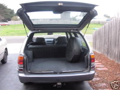

the box is going in a commodore station wagon, i thinking of having the subs up and the port/s facing back. will this sound the best?

Assuming you can make it fit I'd do subs up/port back. 8.5cubes @ 38Hz with 136^2 of port area. Feed the subs 2k+ each and you'll be loud.
Slot port in the middle will be fine and add extra bracing to the enclosure.
i dont know the exact dimensions are. here is a pic of the type of car it is going in:
i want the box to take up the whole boot, but i want it level with the seat so i can still see out the back window. i was hoping to go 35hz. how many auroports should i need? what size? does it matter where on the box they go?
