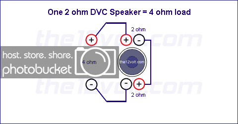

Need help wiring kicker cvr 12"
Wire the sub @ 4 ohms and bridge the amplifier.
Knowing the model of your amp would help tremendously too. If it's capable of 700+ watts rms @ 4 ohms, it could possibly damage your sub....if you don't know how to properly set your gains...
The amp's rated @ 380 watts x1 @ 4 ohms. It may or may not actually do that power, but I don't think it's too bad for a single CVR.
Wire your sub like this:
and bridge the amp...
