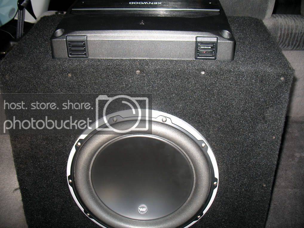

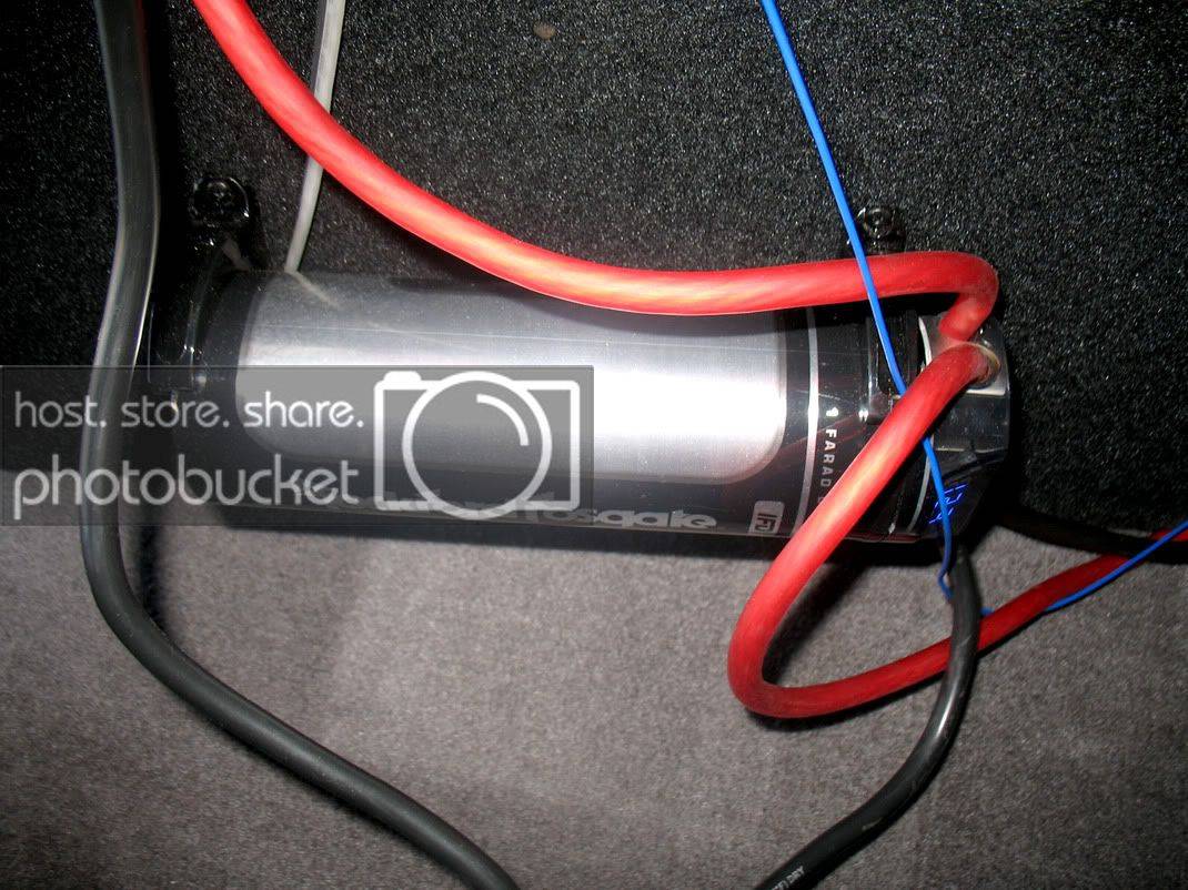

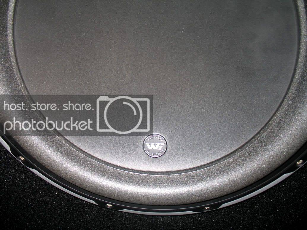

and the box is sealed, me and my friend made it, here are some pics:
