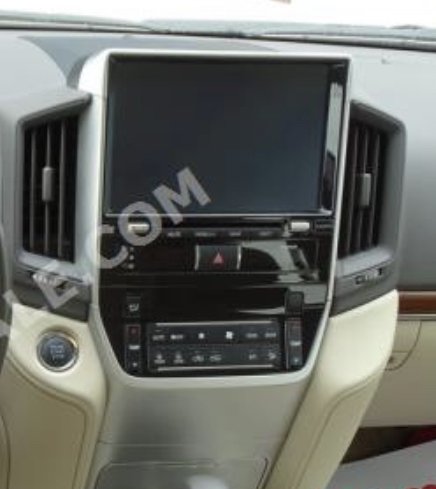

What year is your lc? What is your headunit (pic is better). I have a Landcruiser
It's a 2018 Model. and this is what the head unit looks like.

Big screen...new car...likely separately amplified and factory eq...unless you’re pot committed to a real $$$ upgrade you don’t want just swap speakers. Doing just that will be expensive and in the wrong direction as far as improvement
