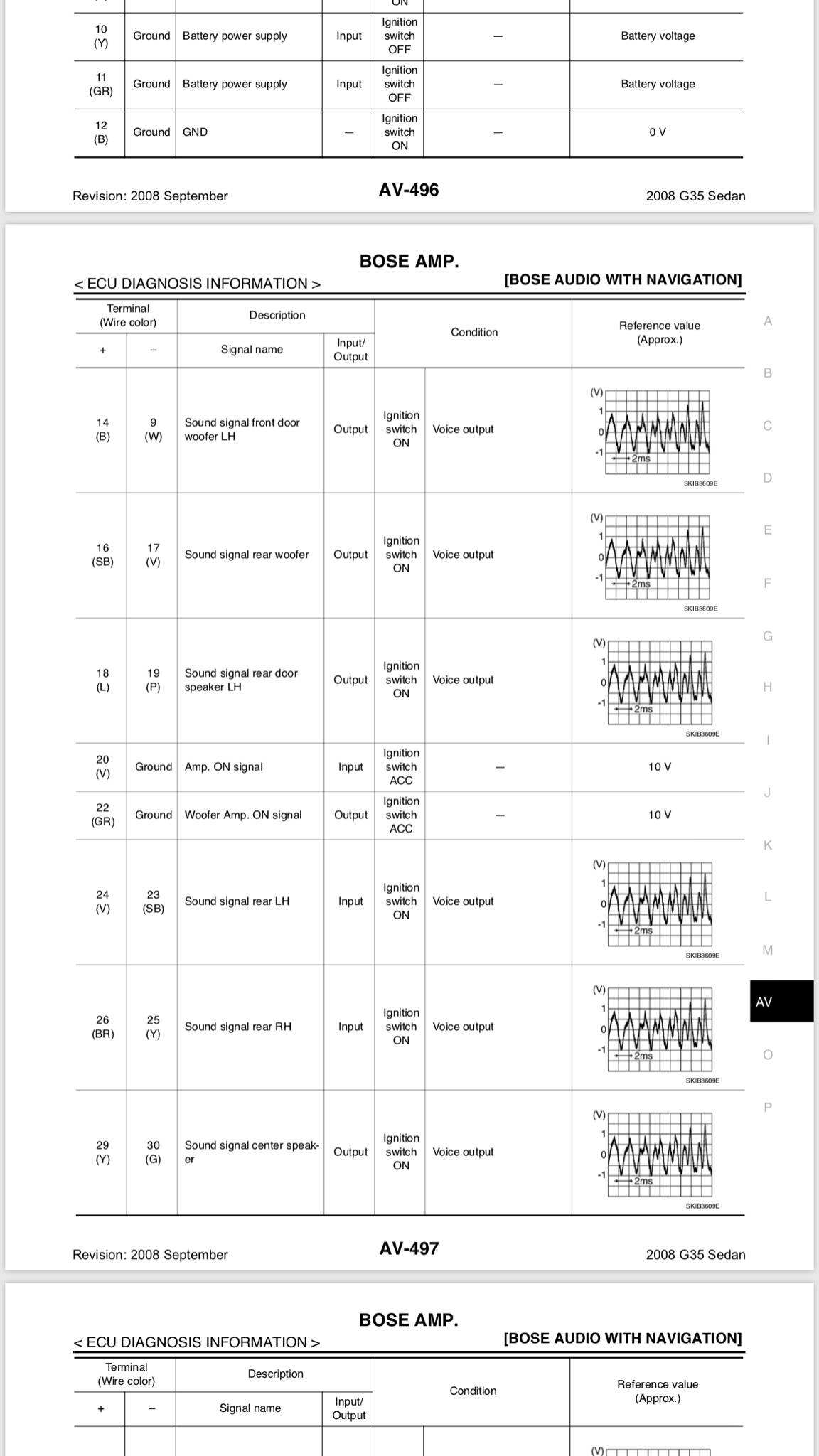

Need help to know what wires go to loc

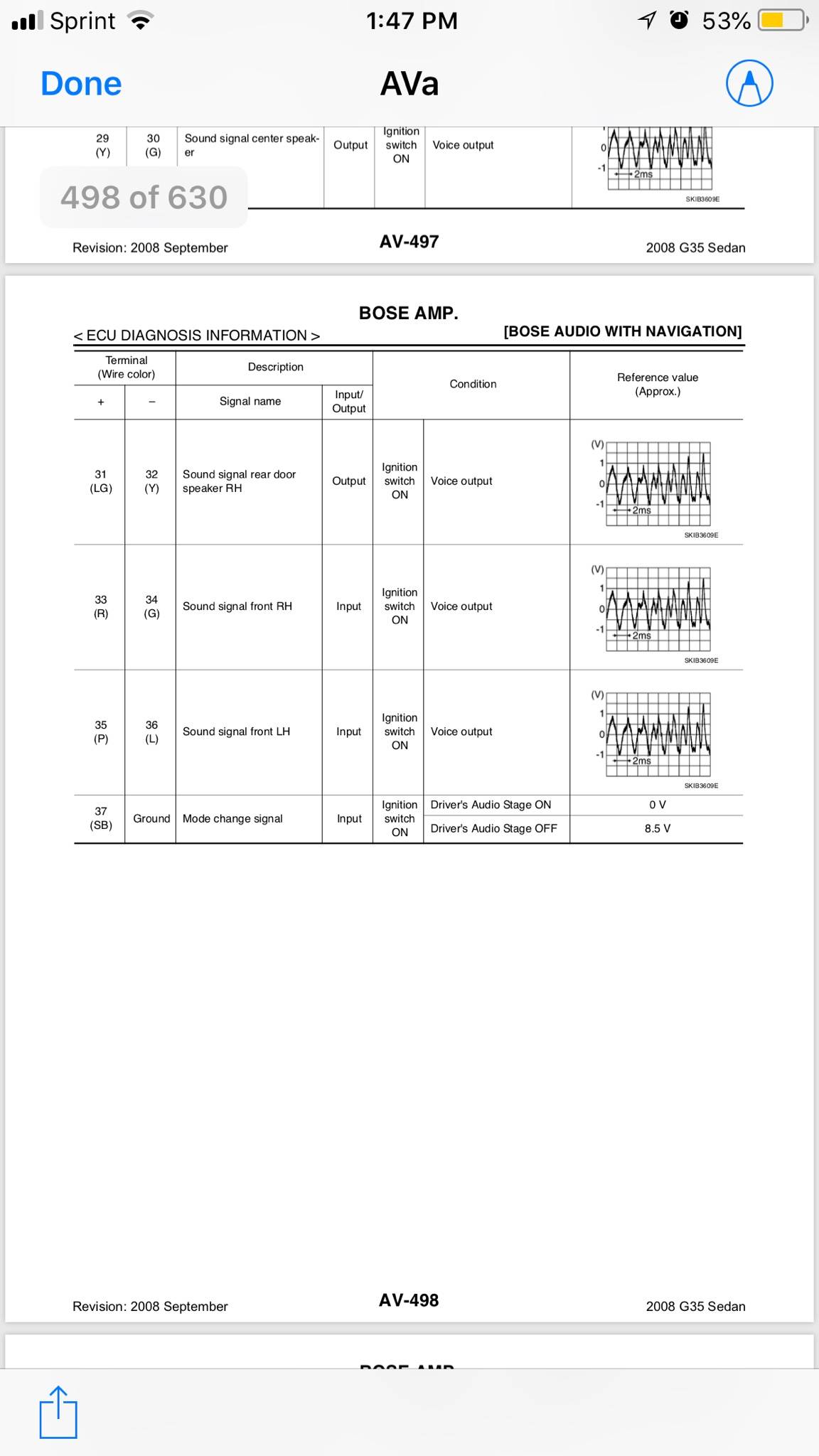

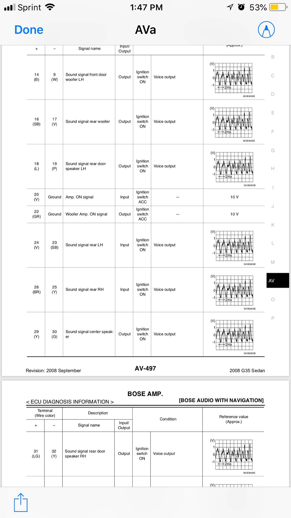

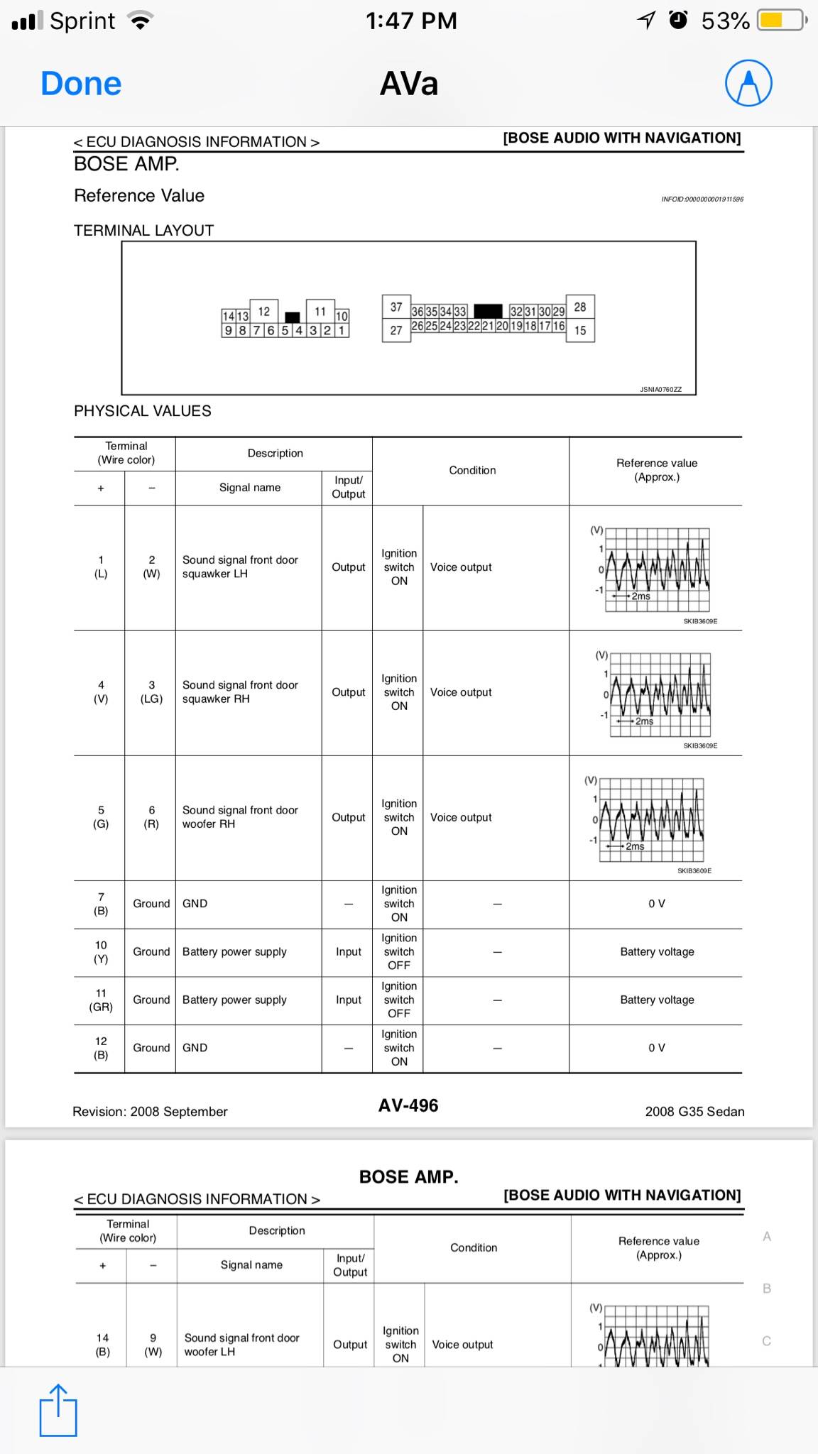

Do the inputs go to loc or do the out puts and this is tapped in to the bose amp wiring harness on a g35 2008 I have included one of the 6 pages of wiring
Ok trick is on the bose system you have to have all the inputs in for it to work correctly I just got done with 8 hrs of standing to figure this **** out all inputs on bose g35 go in to loc rest go to speakers 11 different speakers to hook up
Doesn't surprise me that you'd have to use all of the outputs for the Bose system to work correctly. But basically you just wire all the corresponding +'s and -'s from each speaker to it's spot on the loc
