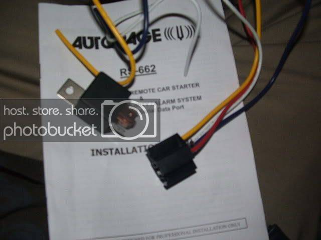

I bought an RS-662 a week ago and it came today. I went to work. I took out the bottom portion of my console, and started to take off the tape around the wires [there was another alarm installed prior. It was done extremely poorly]. Anyway... There's this... which I can't find any info about it on the installation manual...
Colors go as followed: Left: White, Middle: Violet/Purple [A bit on the color-blind side, forgive me], Right: Red, Bottom: Yellow.
I'm not really certain what this is for. But odds are I'm supposed to install it.
What wires do I hook it up to? //content.invisioncic.com/y282845/emoticons/confused.gif.e820e0216602db4765798ac39d28caa9.gif
That is the starter kill relay. I cant see which colors are which but if you take a picture of the bottom of the socket with wire colors where or give me the pin numbers of the relay I can tell you which ones go to which.
not sure if you got your answer yet but red goes to ignition, cut your starter wire and violet goes to starter side, yellow goes to key side, and white goes to the small orange wire from brain. If you look in the install manual there should be a small diagram.
