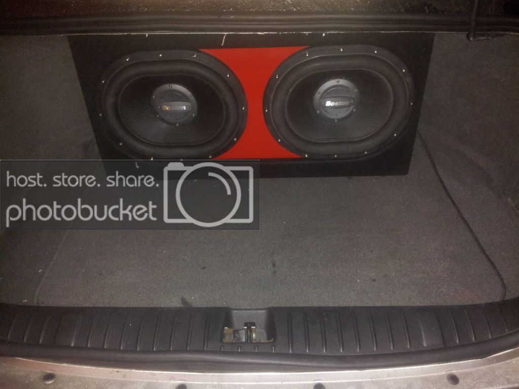

if you dont mind taking up half your trunk 2 12's, if not that one really nice 12 depends. only other option would be the 2 ba spg 13's they only need 1 cube sealed and get some passive radiators direct from them. this is what i did for my install i can pst pictures in a sec
2 cube is this size of a box in my grand prix which is the general size you want for a single 12 ported. so 2 12's would take a box twice this size plus port area. i have the 2 boston acoustics i recomended and 2 spg-tr's tuned to 30hz. so i get a small box like mine plus the output of a ported box. i love me setup for a little under 660 bucks for 2 subs and 2 pr's and its amazing. it was the loudes cleanest setup i figured for a 2 cube box to save trunk room and weight
