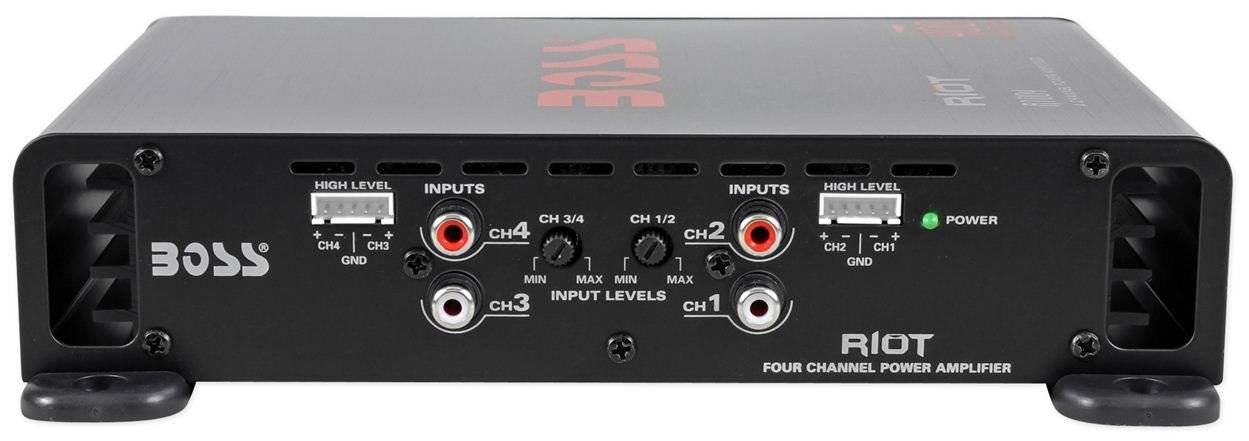

This is the "configurable side" of the amp. There's really nothing to it. I've tried adjusting the gains up and down the line and too high and it's distorted beyond belief and down just a bit is too soft with no mid-range bass.
I was afraid of that. It was given to me. It comes with 2 high pass adapters but yeah there's no filter. It's pretty basic. I was just hoping it would send some extra power to those 6.5"'s and make them sound decent. I don't understand why there's 0 bass or distorted bass though.
