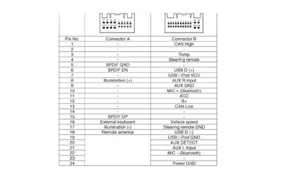

Hi, I have a Kia Sportage, and bought a "complete" audio conversion kit that is less than complete.... :-(   There is USB, Analog and Microphone inputs on the connector block, but none of them are wired.  I really want to use the in-car services, and not drill holes for USB and hang in ugly aftermarket microphones.
I have found the pin-out, and I know I need to put my mic 3.5mm jack wired onto pins 10 and 22, I just need to source some of the small pins.   However I don't know what they are called, or where to source (in the UK).
Thanks for any help.
