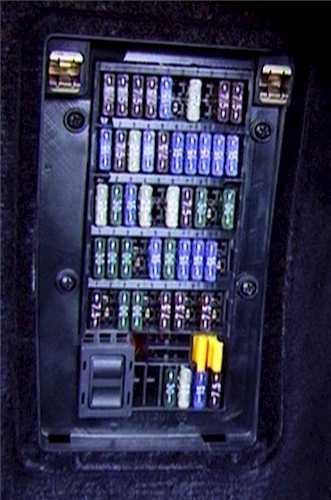

check your fuse box, its usually eaither under the dash where the drivers feet are, or on the side under a little pull-out-flap between the driver door and the dashboard.
will look somthing like this

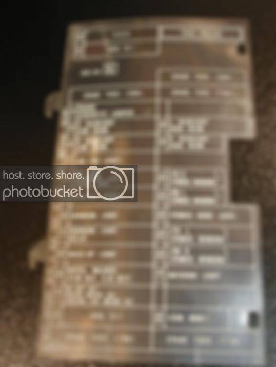

there is usually a label on the cover that you have to remove that looks like this
find the one that says RADIO and pull out that corresponding fuse
