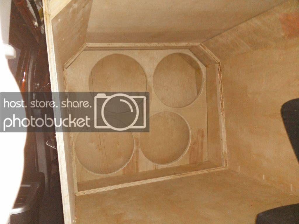

OP los33 10+ year member Car Audio G 3,617 21 Houston, TX Aug 31, 2015 Thread Starter #17 Just found a place that sells birch, god dammm forbid this city haha.. View attachment 26553464 The prs/rs birch is unsanded and is not good under prolonged exposure to weather.. (Does it matter since its in my truck) The BC Birch is sanded on one side seems to be treated wood and great for normal use. Its not cabinet grade, but pretty good. Sent from my draconis using Tapatalk

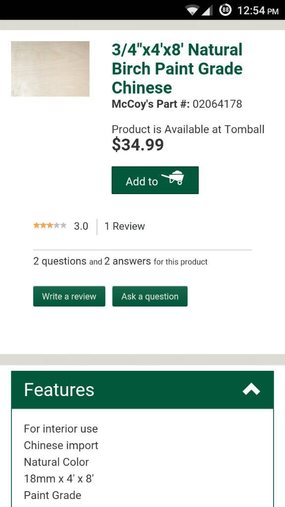

Popwarhomie 5,000+ posts RIP CA.com. 11,798 4,767 Central FL Aug 31, 2015 #18 If you can't find "birch" then go with sanded pine. I normally pay $35 a sheet for 11 ply chinese "birch" But lowes had it on sale recently and I got it for $30 a sheet.

OP los33 10+ year member Car Audio G 3,617 21 Houston, TX Aug 31, 2015 Thread Starter #20 Heres real birch that would need to be special ordered. View attachment 26553465 Id need nearly 12 sheets so 600-700$ worth of wood. Also this chinese birch Sent from my draconis using Tapatalk

OP los33 10+ year member Car Audio G 3,617 21 Houston, TX Aug 31, 2015 Thread Starter #22 You don't need anywhere near 12 sheets for 2 18s… We are building a 4 18" 4th order thats a total of 40 cubes and it will take around 6 total. Click to expand... Im doing a wall now.. Double baffle all around and triple baffle port wall and triple baffle face for the subs. Gonna do 4 18's on 5-12k watts. Total should be near 22-25cuft net, 30cuft gross. Sent from my draconis using Tapatalk
