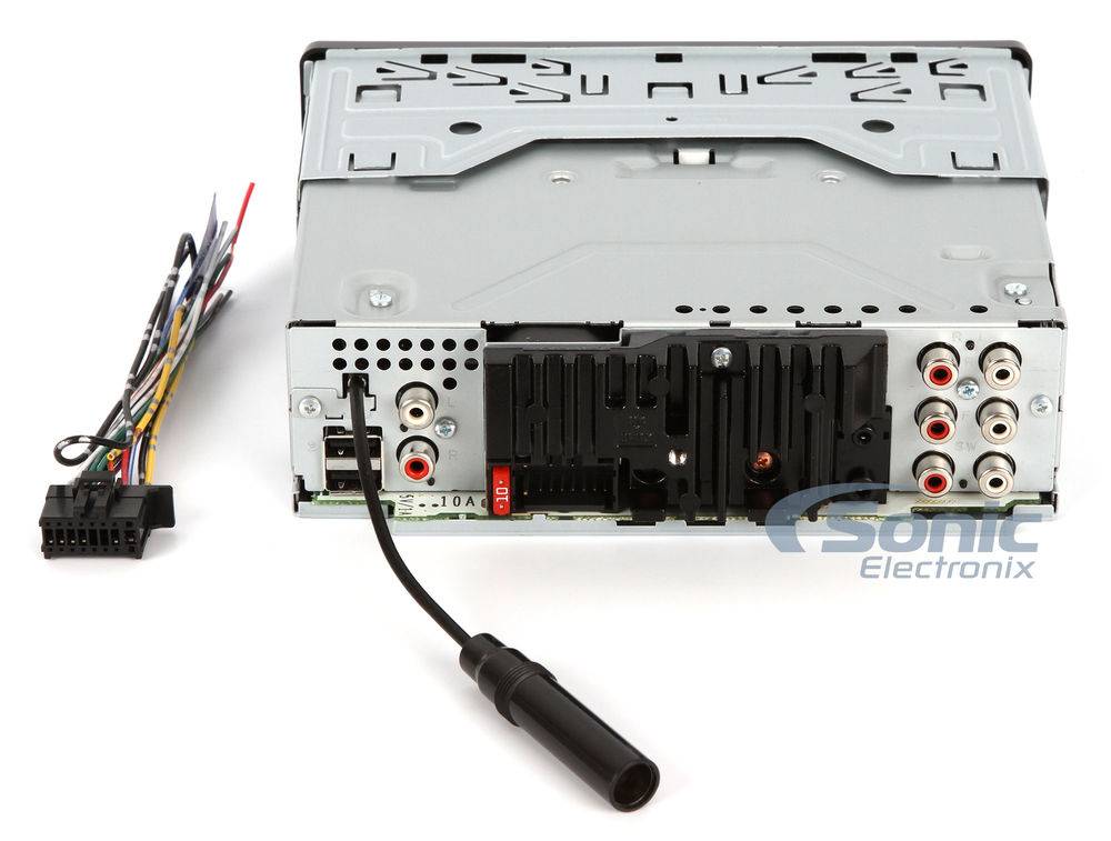

That HU won't fit. I've only got a single DIN opening inmy 95 E150 and I'm not tryna get into cutting up the dash. Is that what that bandpass setting is for? I would run the tweeters on the rear channels HPF and the Mids on the front channels bandpass which let's me set both a LPF and HPF?

the 80 prs is a single din head unit and if your 6700bs fits, the 80 prs will fit right in just fine. Your current head unit is not a good head unit. The internal DAC and circuitry is weak(which means poor quality sound from the start) and has basically zero Real sound tuning capabilities especially with only a 5 band EQ and no time alignment.

It looked like a single. But the site I looked it up on said double. Sooo.. what yall are saying is there isn't a similar tweeter that could complete this set? And to make a different tweeter work I have to add even more adjustments to spend hours upon hours tinkering with? Maybe I'll just steal the Polk coaxial out of my truck. I just wanna bang my head!

the site is utterly stupid then. Its a single din and always has been.
