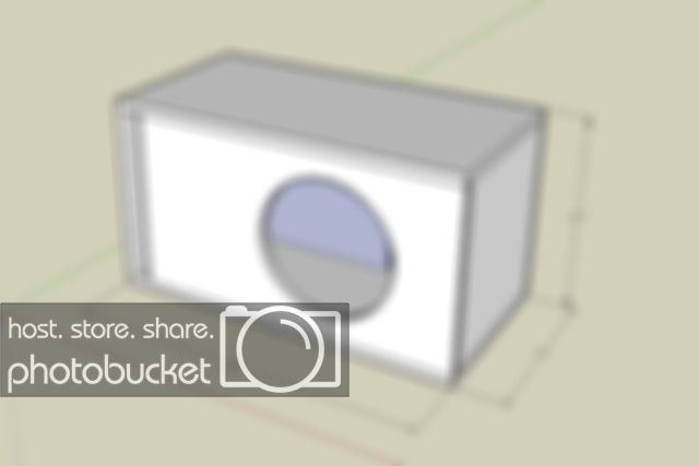

your box:
outside box dimensions 29x15x16
port dimensions 14.5x2.5 port are 36.25in^2
2.44ft^3 @ 33hz

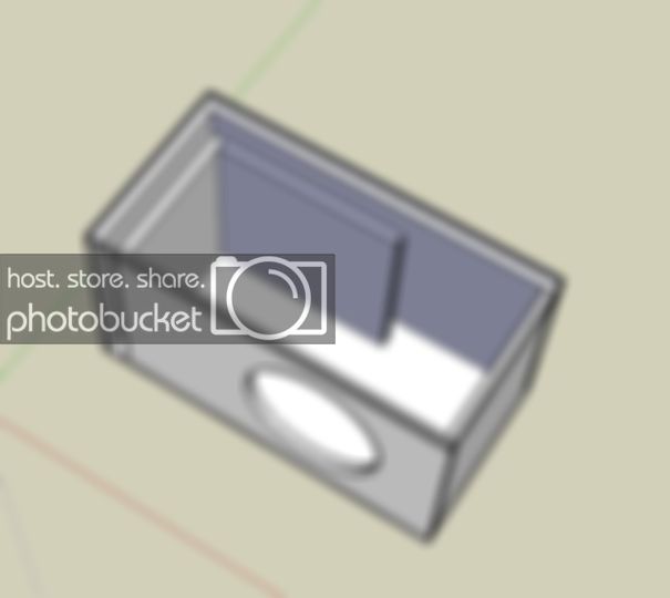

now for what the port looks like
port view
now the pieces you need to cut
Bottom plate 29x15
top plate 29x15
box left plate 14.25x14.5
box right plate 13.5x14.5
back plate 29x14.5
front plate 25.75x14.5
port piece parallel 11x14.5
to the sides is
port parallel to 15x14.5
front is
thats it!
