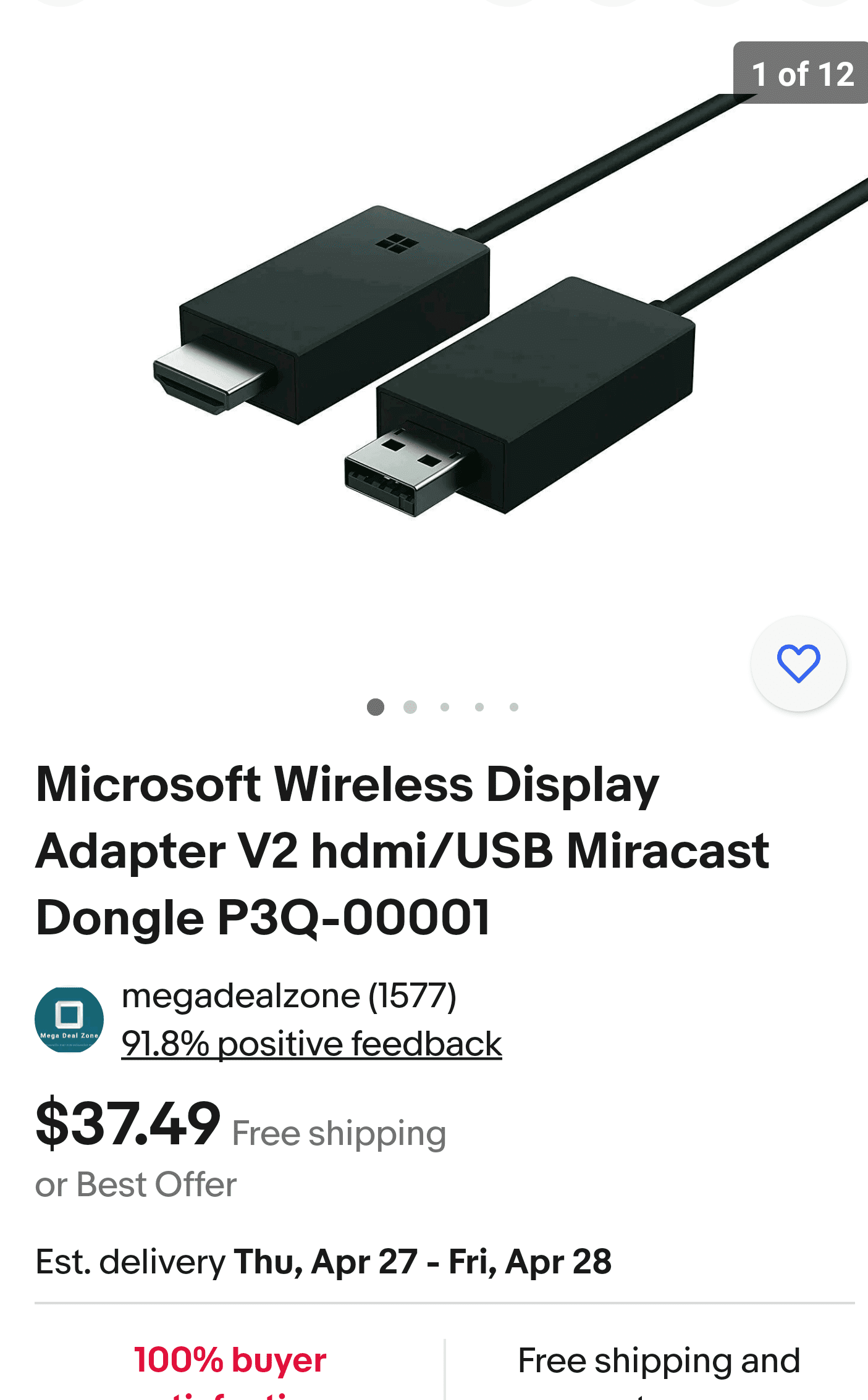

Try a Microsoft Display Adapter. I use an old LG G7 and it works fine. I used to have an OBD2 bt scanner that would cast a nice display onto the screen. It would show speed, RPM, voltage, engine temperature, et cetera. It was the OBDlink MX+.

It's really annoying 🤣 I did get it to work with a firestick but it was to laggy and didn't work with the touchscreen on the unit plus had to use dex to get it to do anything
