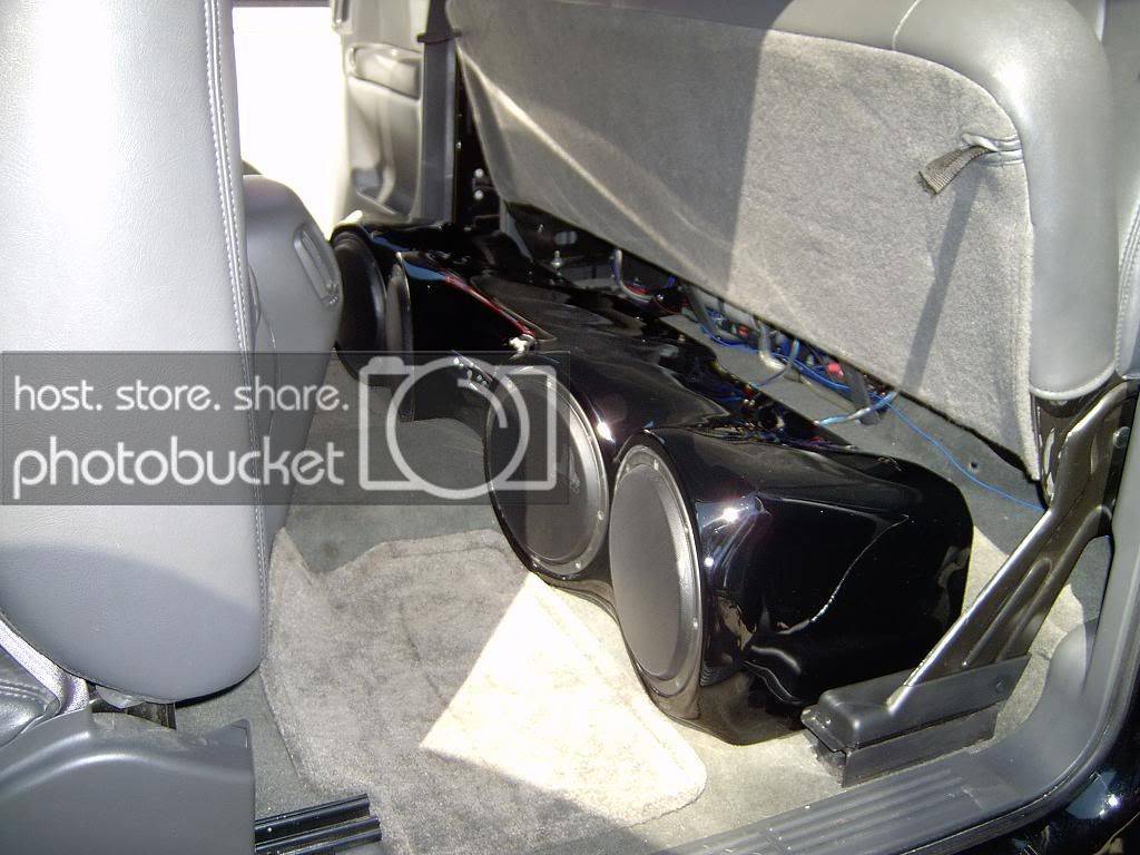

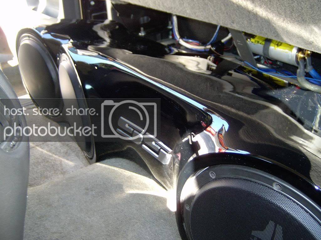

I actually lifted my bench and had a fiberglass box built underneath the seat. If I could do it all over again, I'd go with your idea so i could've maybe went with 12's.
I had two idmax 10's ported, and also tried 4 jl 10w3's sealed. With your box/seat idea, you might be able to squeeze 2 12's(that would be soooo sick). Good luck with w/e u decide!

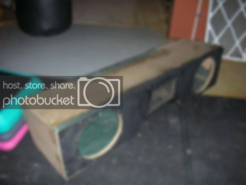

These boxes both looked great, but didn't sound good until I turned them toward the back(they stuck out into the footwell, so it was only for testing purposes, but I should've had a box made so that I could permanently face them backwards - I was just tired of fooling with it and decided to go back to an suv)...
the 4 10's sealed sounded better than the 2 ported, but there was more output from the ported box. I'm sorry I dont have any pics of the downfiring box, but it was too muffled and only slightly better than forward-facing.

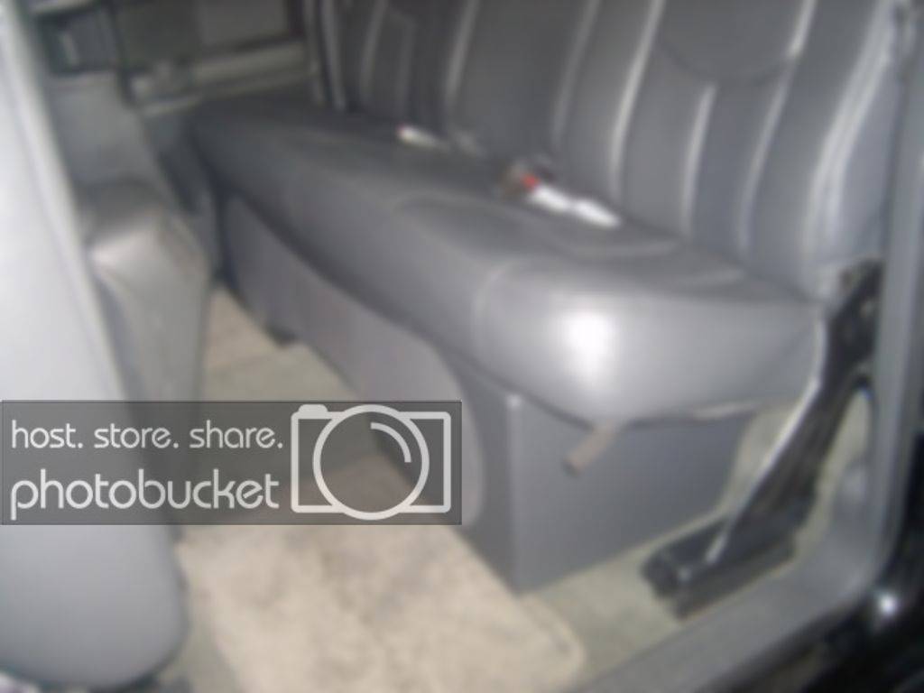

I would never put amps in front of the box on the floor - I thought u meant under the box/seat...you can see the "riser" that I had made out of steel square tubing - it lifted the whole seat about 3 inches...
hope this helps...
yea man i like it, what are the deminsions on the square wood box, also how much can you lift the seat with the stock Screws? after lifting the seat 3 inches did it help fit it better and if i lift the whole seat how does the back rest stay up with out clipping the stock hook? and do you have to put a lift on the straps that hold the seat down on the bottom to? did putting fiberglass in the box make a difference in sound? thanks
