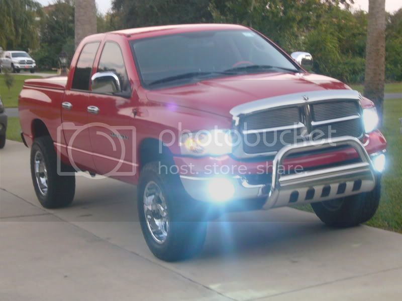

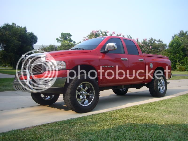

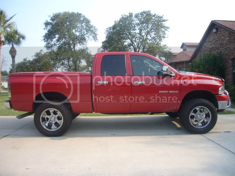

PS: this is what I'm working with...

What brand and what are the specs of the speakers you got, they sound real nice! This "set" that you have for sale, is it a set of 2 or 4 or 8 or what? my truck is like 2x the size of yours so if you are using 2x sets, I dont know if 1x set will be enough ya know? I frequent the UCF area but im actually on the east coast of Central Florida.
