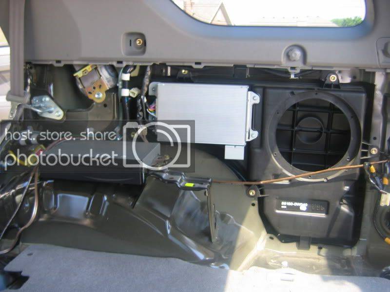

There is a panel that goes over the sub, and without modifying the panels I have no room for baffles. I've looked into 8's for a previous ride (sold it before I got the system) and looked at many that have been mentioned (Sundown, ID, etc). Like you all, the mounting depth is what I'm having an issue with. A replacement OEM JBL is an option, but from what I can tell even through a discount online store it's over $350, so aftermarket seems to be the way to go.
Here you guys can see what I'm working with. The first pic you can see the panel over the sub, and the second shows my area to work with.

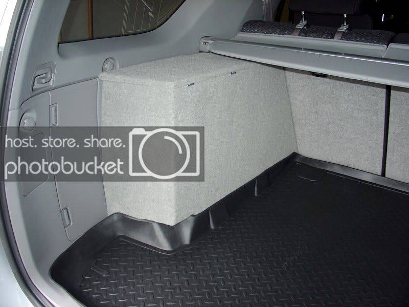

The ED sub is close, but at 4.3" depth just won't fit. I've considered a custom box, but the biggest thing is cost as I'm on a low budget (wasn't expecting this to come up). A custom box wold be something I may consider, but I don't have the know how to build it. I have an idea that I love, but I don't have the ability to build it and it is too pricey to have built. I know a guy who built a cargo box for his 4runner. I would want the same size enclosure with possibly 2 8's or a single 10" sub mounted in the side (problem would be getting it sealed properly). You can see the way the rear looks in the above pic, then look at this one to see the cargo box. Again, this is just something I'm mentioning, I'm looking for something cheaper and less visible.

Modify the door in a simple way. just remove the speaker grill area. baffle it. better woofer. then if you ever go to sell. Just re attach the plastic piece with some glue on the back. as long as you only cut on the seams of the plastic. wont be noticeable. Looks like the square piece (that is framing the grill) is detachable anyway. which woul work great. Just make a square baffle. GL.

Although it looks like it does, the grill/cover does not snap off. That panel is one complete piece, and I'm not quite ready to start cutting away at that just yet. In my last 4runner I has 2 JBL GTO 10's, and they were decent but not something I'd want again. I've spoken with another guy who seems to think that there is 4.25" of mounting depth, which completely changes things. I guess I may have to just tear it down and measure myself, but it's a pretty good job doing that.
