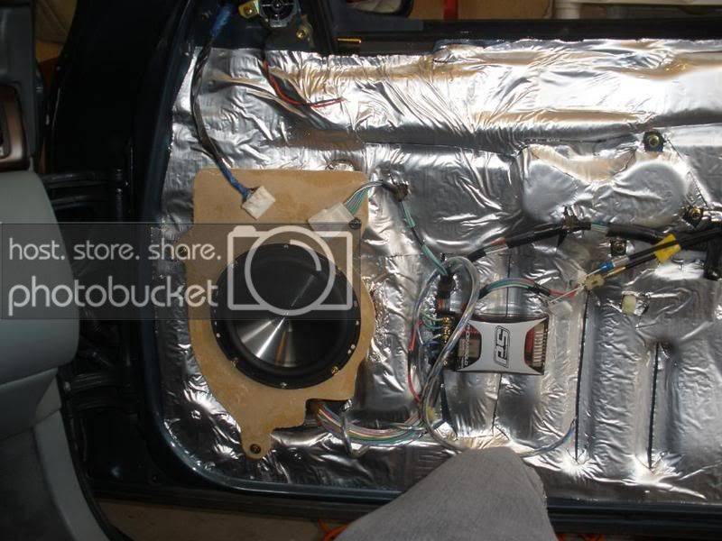

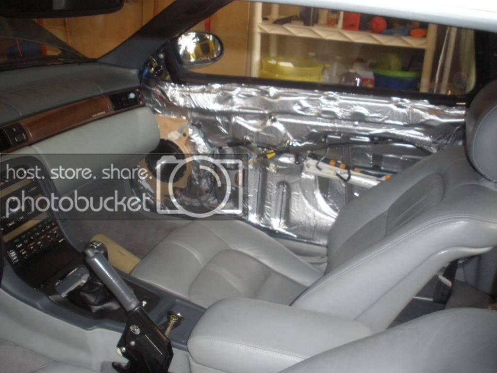

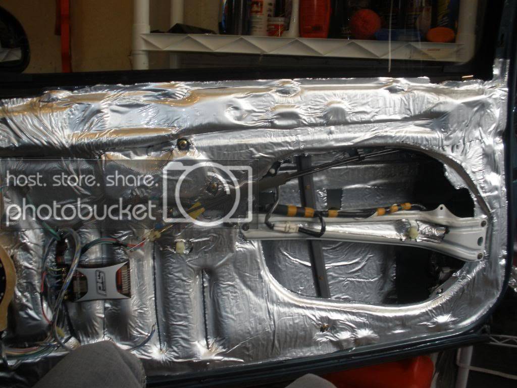

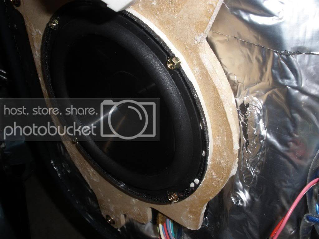

im in the process of doing my doors on my 95 sc300 i got the mdf prefab off ebay for like 40$ still have to foam around them a little to completely seal them up and then im gonna seal the big opening with some heavy mill plastic and some silicone...but even though im not done the midbass sounded great when i tested them out how it is now..i know the gs is very similar to my car

Wow, that looks awesome!! My car is no where near that, mainly because I dont know how to do it my self. i got someone that does it but I doubt we can accomplish all that. All I want is to make sure the speakers are sealed and maybe use some of the sound proofing foam around it.
im sure you guys could do it... just buy some deadener.. maybe like the extreme door kit off ebay..i think i saw the kit for like 57 shipped.dynamat the doors and seal your gaps with the foam your talking about...how do you have the mids mounted,did you modify the stock pods some how or what?

I was actually going to get the SC300(pearl white) but deal didint go through, it was my first choice. But then found the gs.As far as the speakers go, we had to cut parts of the original baffle to make the 5.25's fit.
