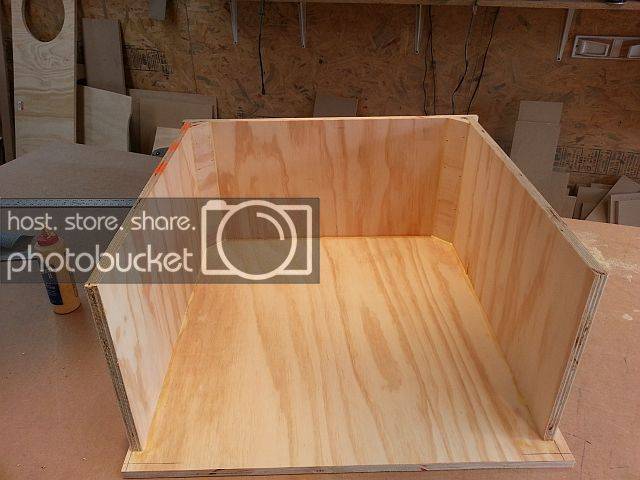

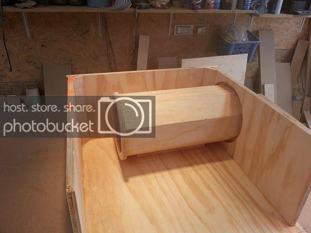

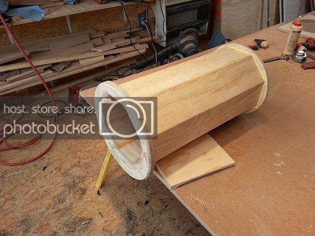

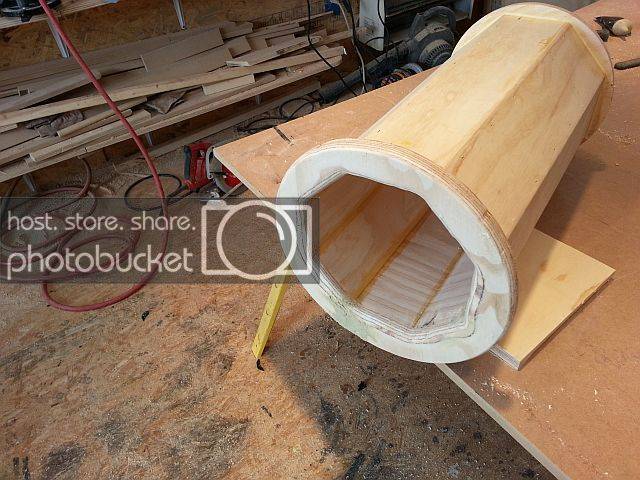

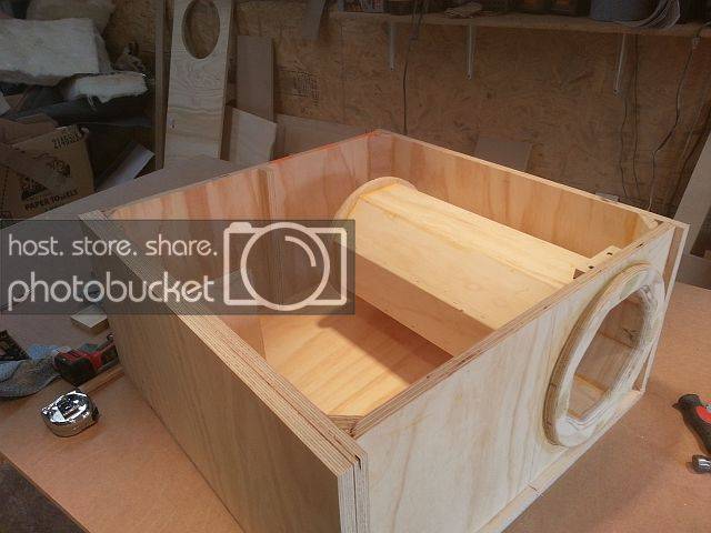

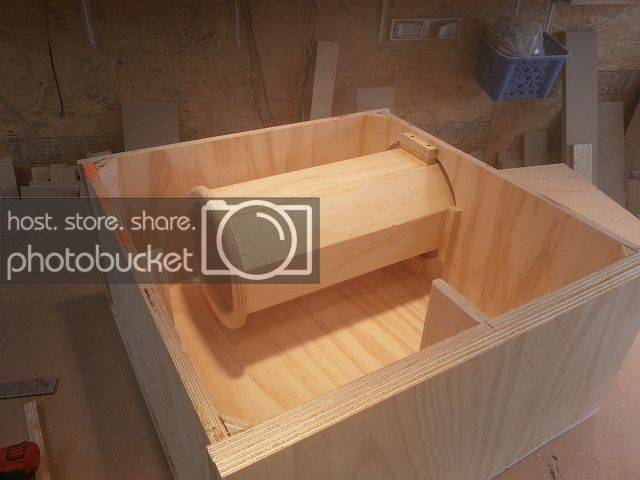

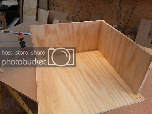

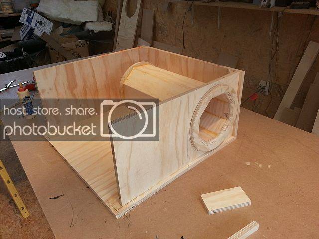

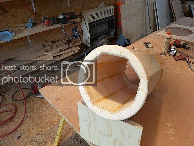

This is for a pair of Sundown Z4 12s that are up coming in a few months.....4.4 cubes net @ 32 hz.....Arauco construction...double baffled....subs forward custom sized octo to the side........
I only have octo work done so far.......thanks
Neighborhood of 15" x 29" x 29".......we don't give away all our secrets...lol
Not going to copy exact design. I want to do one like this for the two xls I just bought. Wanna make sure I have enough room to do a port tuned around 32
thats a sexy lookin port there. can i get a ball park on how much one of those ports would cost
