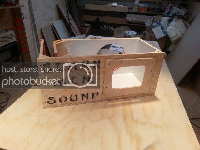

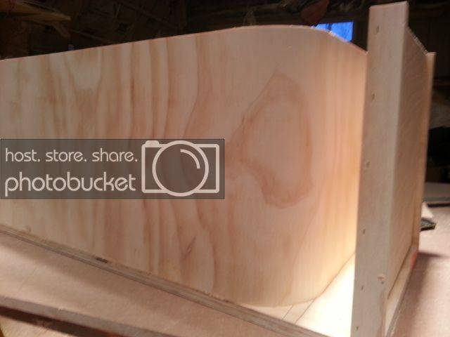

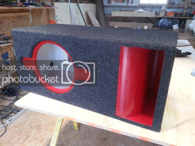

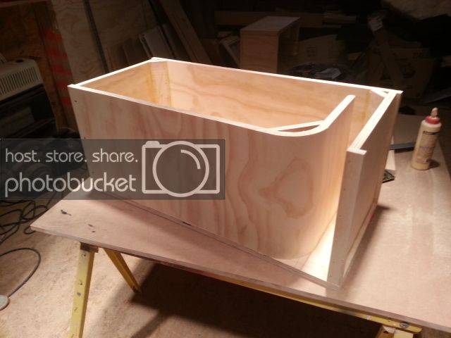

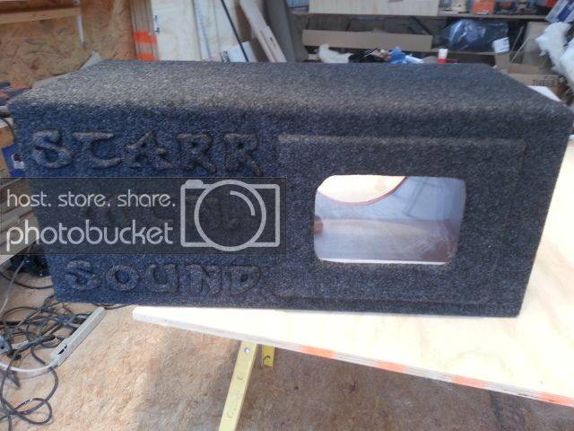

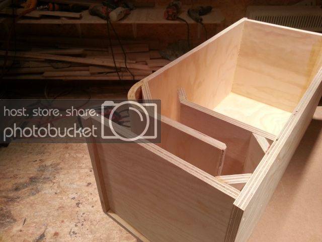

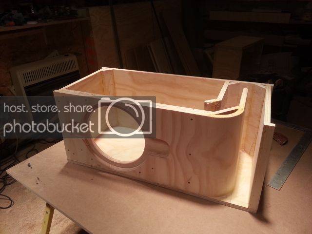

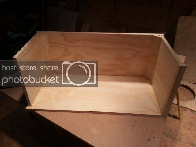

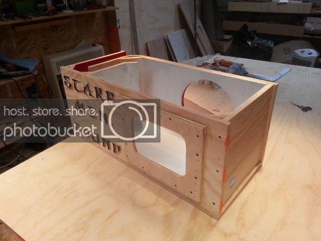

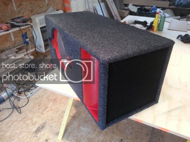

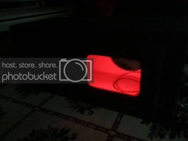

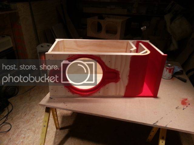

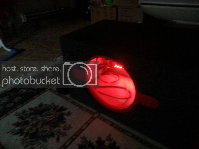

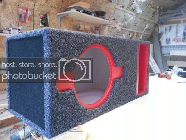

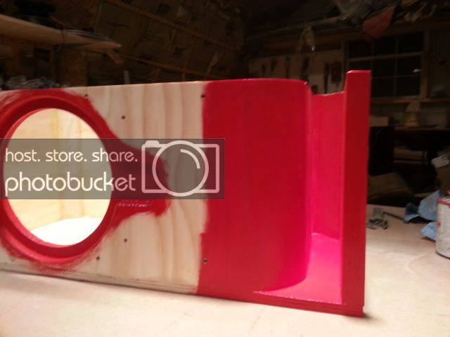

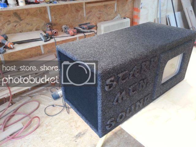

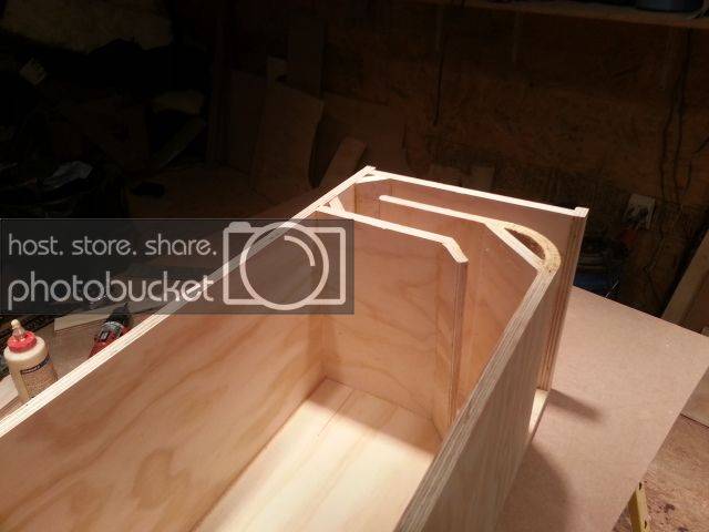

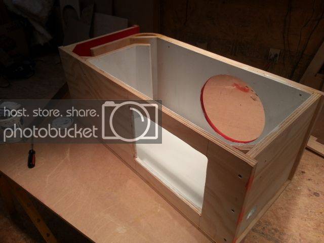

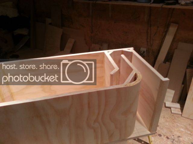

Single 12" RE MT....2.4cf net @ 33hz.......arauco....kerf port....flush mount......plexi window behind sub motor...white painted interior with red leds.....logo...charcoal/black carpet....cherry red kerf port eventually.......
You, sir, are not human. There is no way a real man could do what you do, unless you went to the crossroads and sold your soul...lmfao. I would hate to be lost inside your head. Nutthuggage is deserved on mr double 07.
