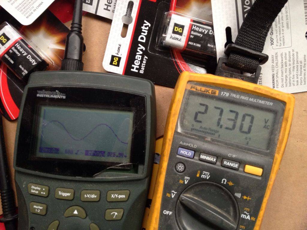

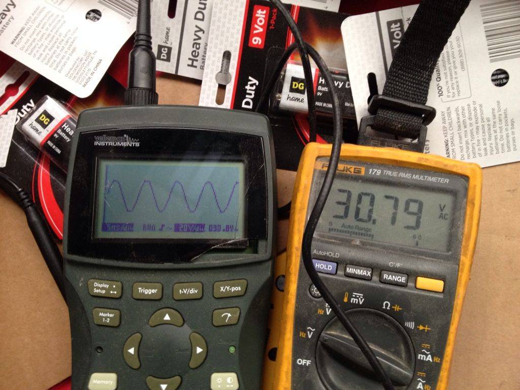

Setting unloaded. A lot of people feel like this is useless, but I like to see what an amp does unloaded so that's why I always include it. If you just used the DMM SQRT method here, you'd be at ~ 24 and leaving some power on the table. This is also why I advocate the use of a scope. Almost 31v here.
Sometimes you will see a highs amp tested and see them say, "all channels driven". This is why they say that. This is one channel driven at 5 ohms. This is almost 150w @ 5ohms but only a single channel driven.
