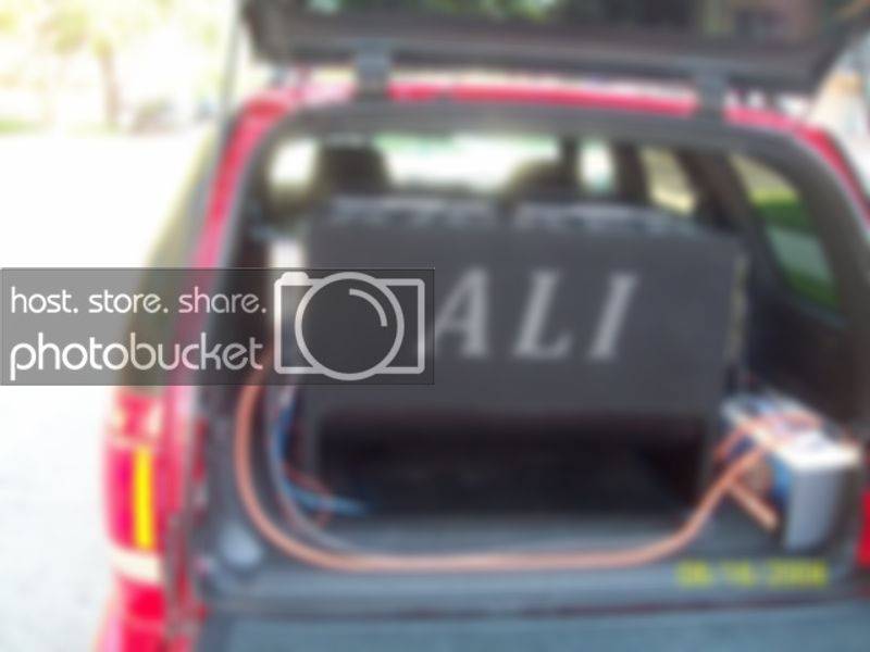

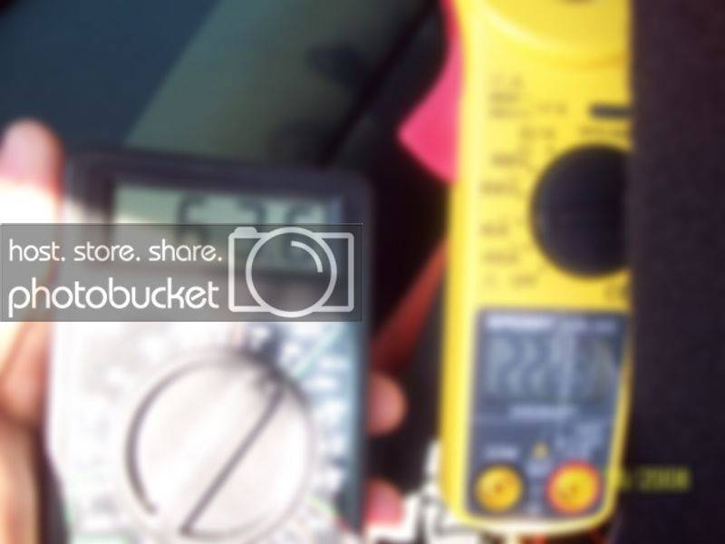

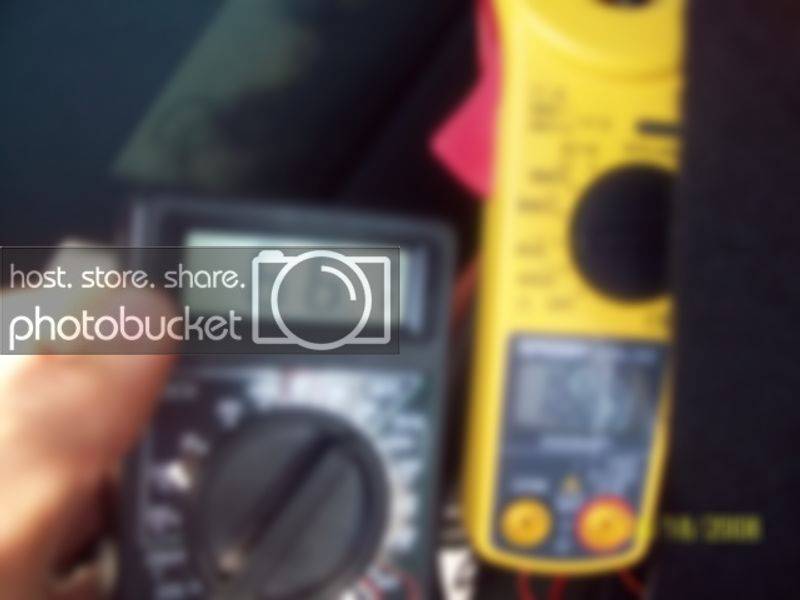

lots of rumors saying this amp is overrated, yet no proof, no test, no pictures. I recently installed two bxi2608s on a pair of L7s and came to the conclusion that these amps do rated power at 14.4v. if you feel otherwise, please post your results so we can compare. Nonetheless, gain was set my DMM, while bass on headunit at -7. Amplifiers were set at 50.9v according to the gain tutorial.... and here are my results:
VAC= 66.1
CAC=16.89
66.1 x 16.89 = 1116.429 rms
66.1/16.89 =3.9ohms (Reactive Impedence)
Voltage dropped to low 13s
amplifier did 1116.4 @ 3.9ohms, yet its rated at 850 @4ohms
further results.....
1455.1 @ 2.77 ohms
985.6 @ 5.4ohms
1803.1 @ 2.3 ohms
1319.7@3.03 ohms

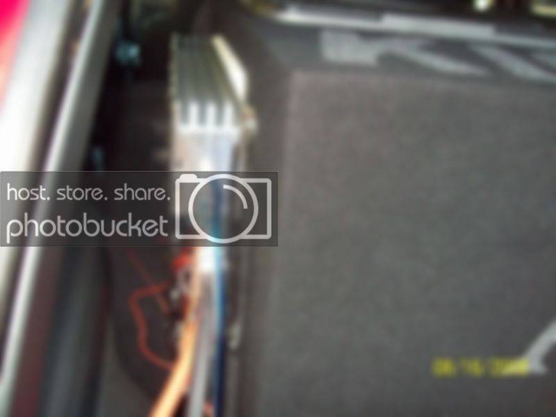

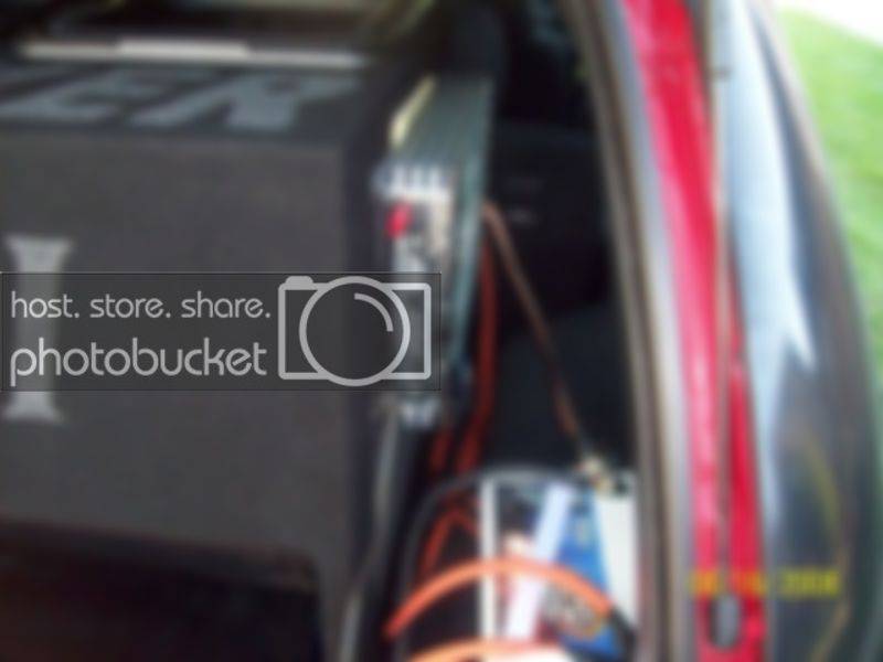

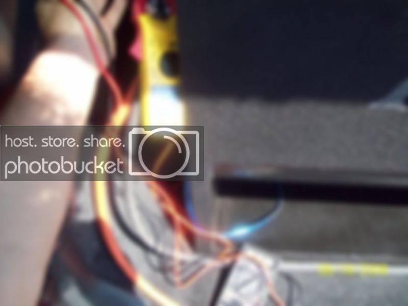

Pictures- wires are messy, but its temporarily until i figure out where i want everything. More results with lower ohm loads soon to come after i get my DMM back
Did you use the peak hold function?
no, i took the picture while they were constant.
