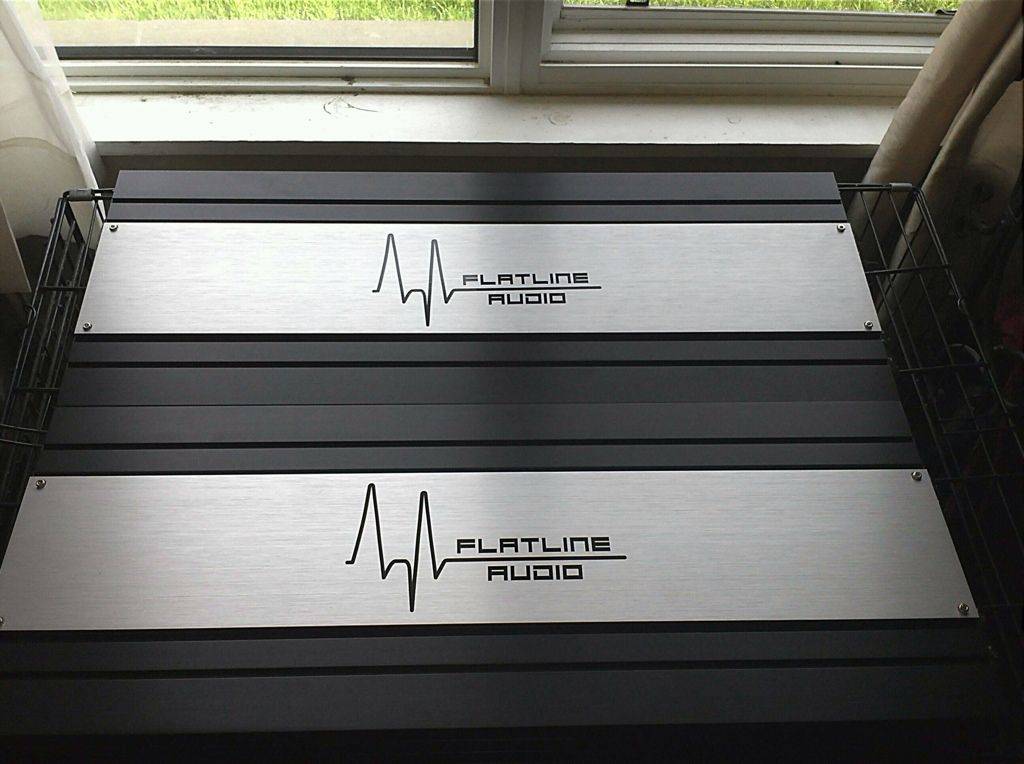

Beefy little pair of amps here. My amp was unbadged so this pic is courtesy of Hank. The rest of them will be mine.

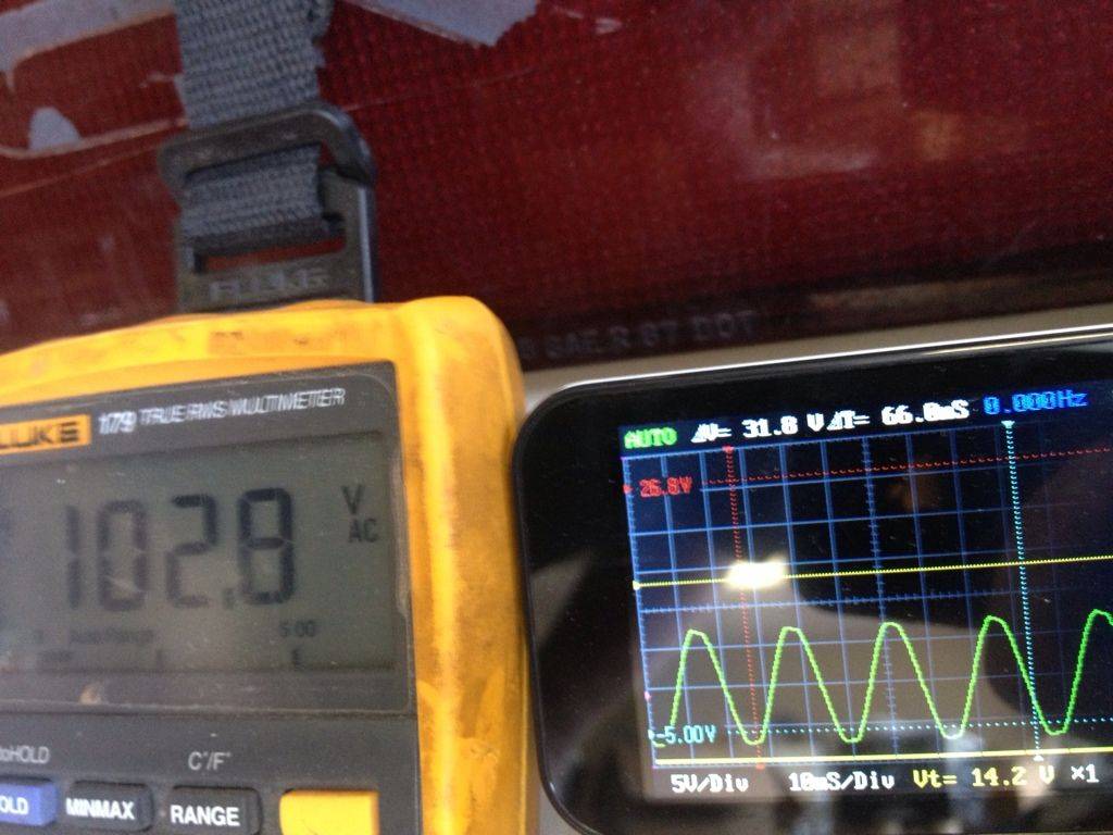

Set unloaded. It was doing between 103-106v clean. That's a lot of voltage. 108v was a very soft clip. I left it set at 103v for the clamp.
