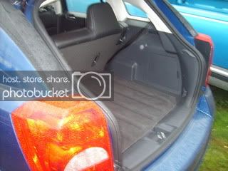

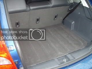

Whats the biggest subs you guys think that will work good in my hatch? Its about 39" wide. Top of back seat headrest to the curve at the back, depth is about 18-19". Depends on how high you go from the floor. Floor to the back of the headrest is 16.5-17".
Thanks for the options. I wanted to do 2 18's or 15's. But now it looks quite small my hatch with the dimensions. I wanted to try and get a 150, but it looks like it will tough. I was thinking two SSA Xcons off a sundown 3500.
I just put dimensions into bassbox pro. I used 16.5" height, 39" width, 18" depth. Says it 6.703 cuft. without any displacement.
