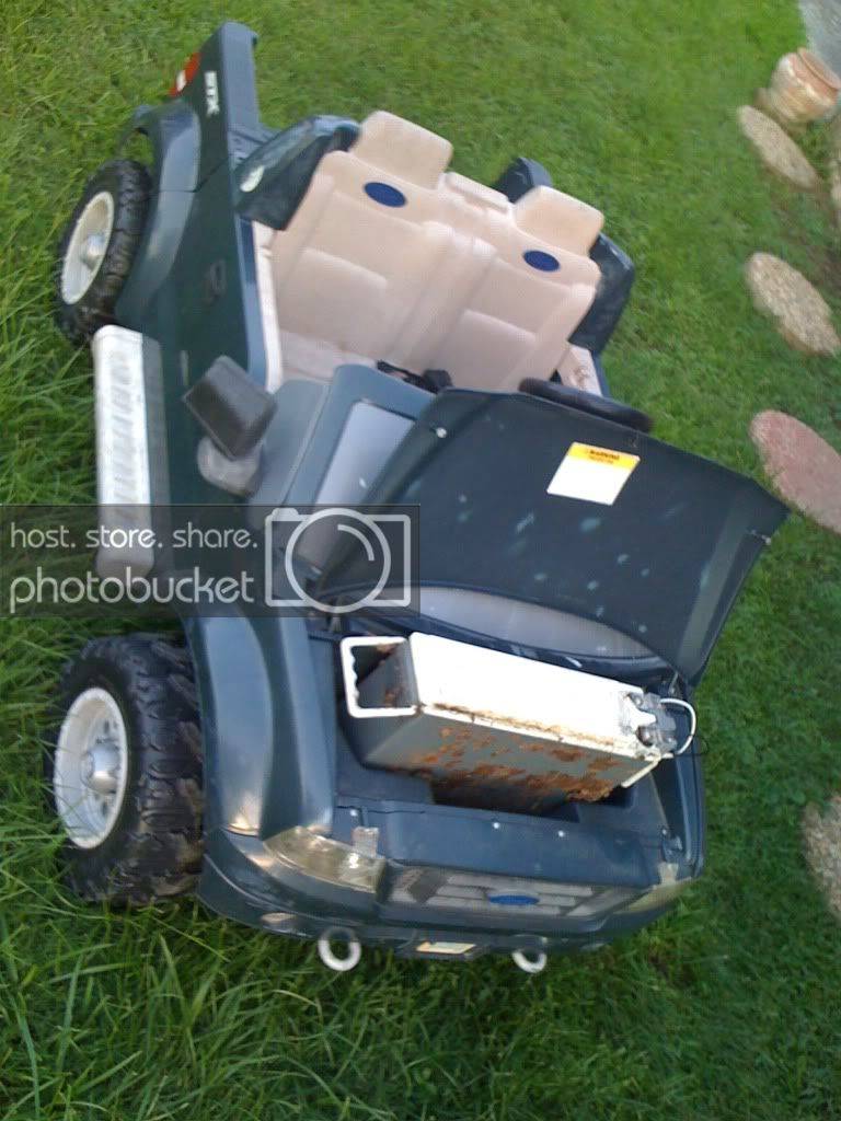

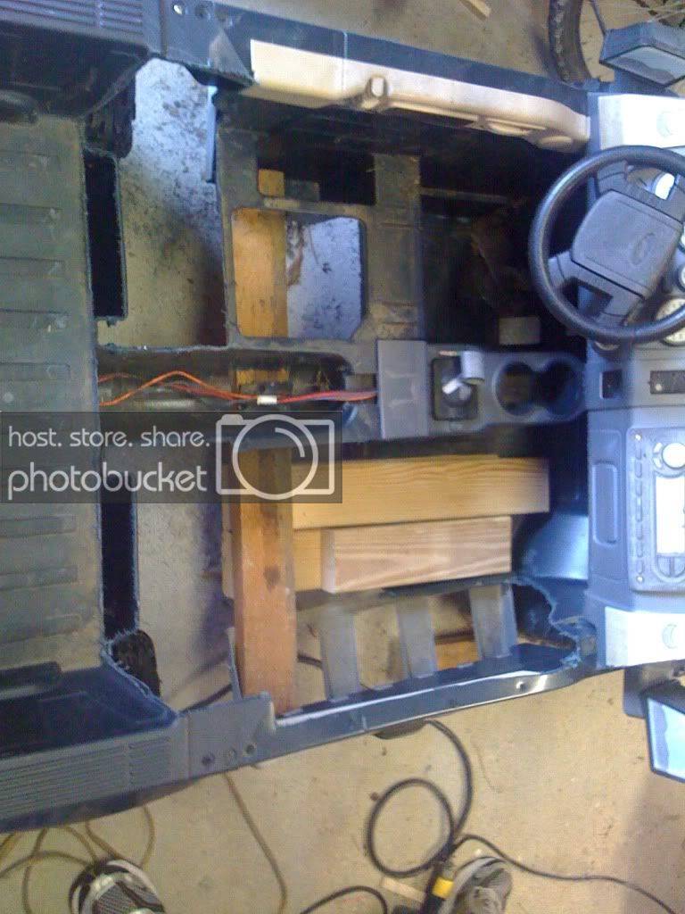

Virgin truck. Batt test fit.

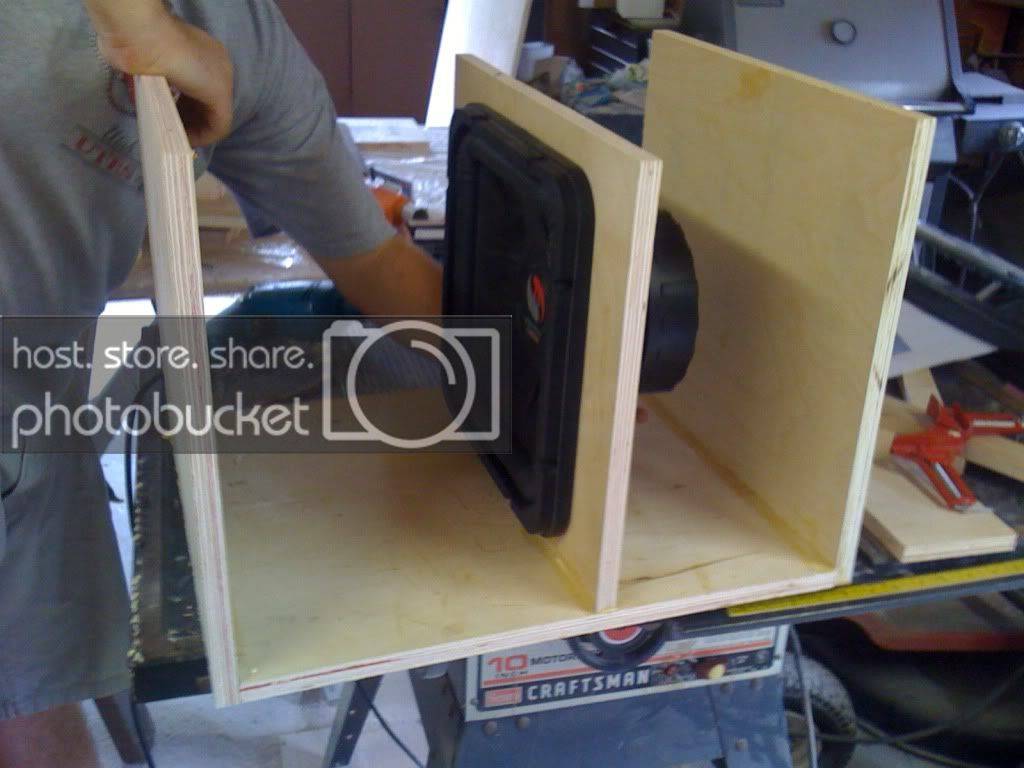

All cut up and ready for construction.

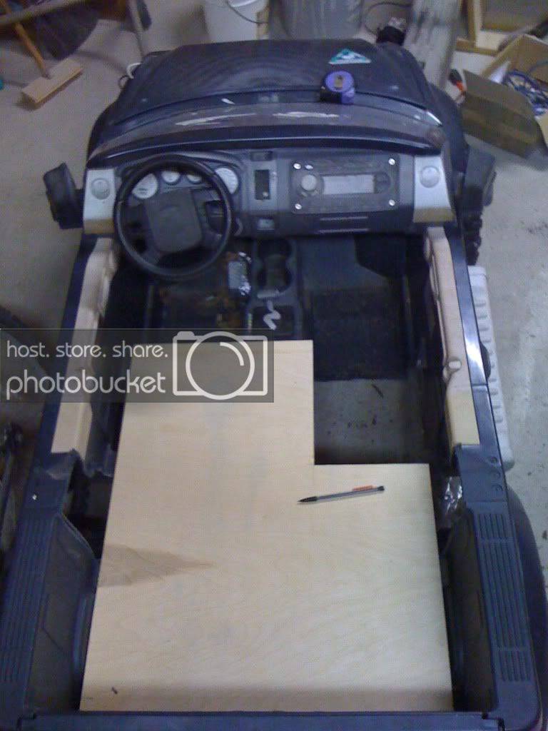

Floor layed out.

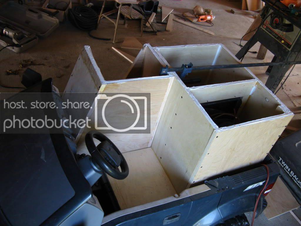

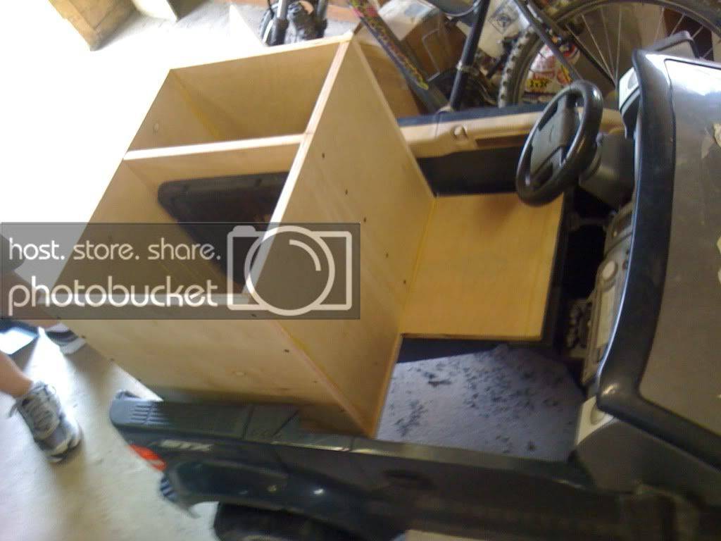

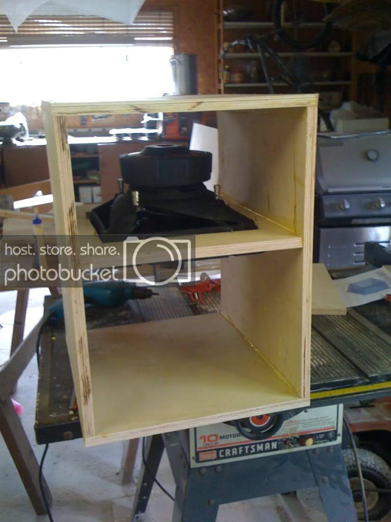

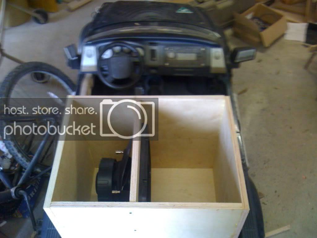

Begininings of the box. We decided on a 4th order for a Kicker L5 12.

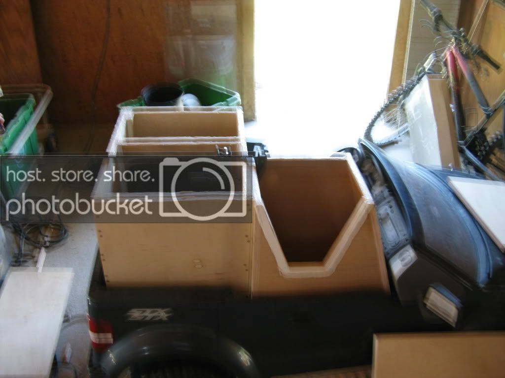

Fitment in the truck.

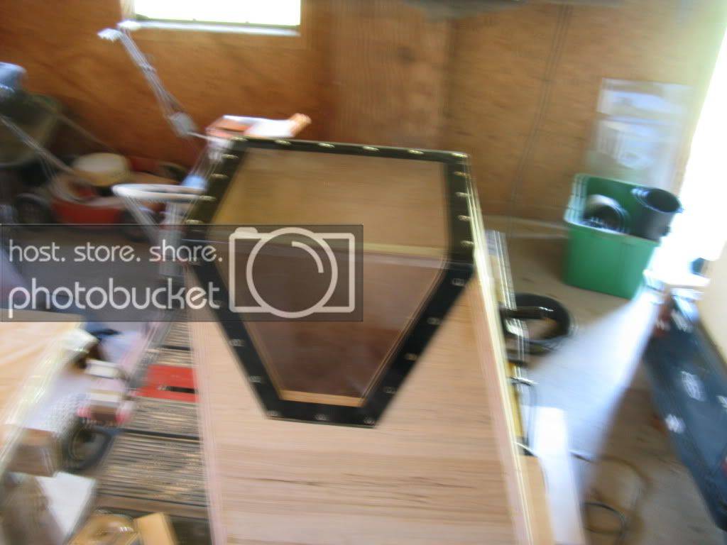

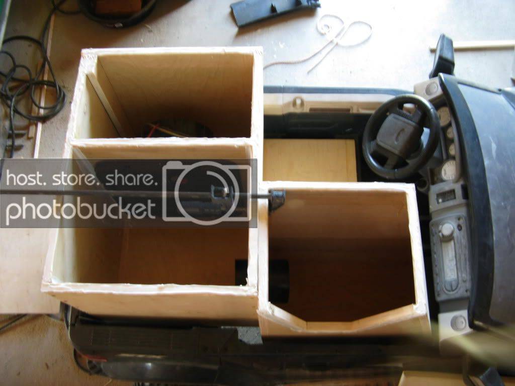

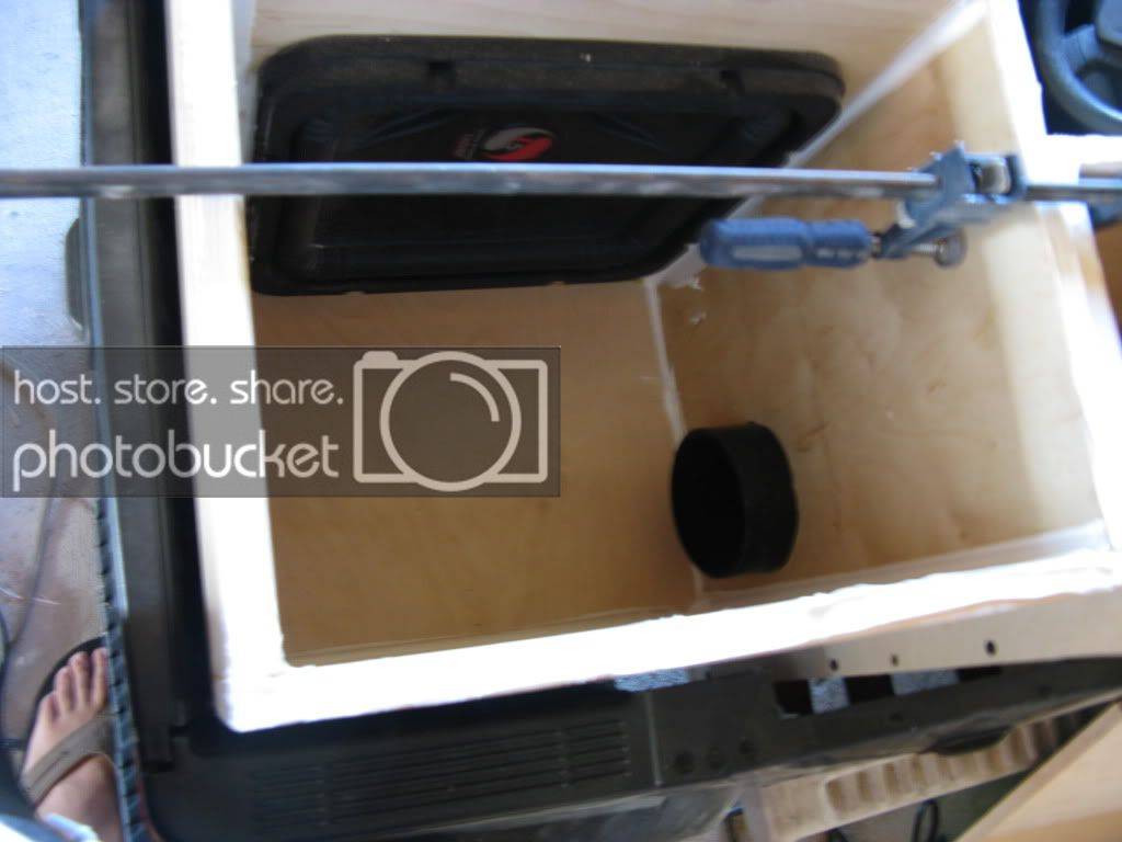

Used a piece of plexi from a 10 year old badpass that I used to have to allow the mic to get into the cabin.
Fittin it all together.
I didn't get any pics of it buttoned up and the amp mounted. I will be sure to add some later. We just couldn't wait to burp this thing. Didn't even have the aero for it so we just used a piece of tube.
With just a tube and no tuning or anything...
IMG_0656 by TaylorFade, on Flickr
160 flat @ 48hz. Lol. Not too shabby from an L5 and a Powerbass asa 1k. I know this little truck has more in it. And we have some pretty killer plans in the works for it, but Daddy has been busy with his own finals build.

Wow. That's you guys? I saw that vid on YouTube when I was looking around for ideas. That's awesome! Lol. Yeah, we're nowhere near 180 yet, but we have a lot left to do. I am reconsidering the 4th order idea now. I think we might have gotten better numers from a straight ported design so that all of the pressure from the sub AND port get to the cabin.
