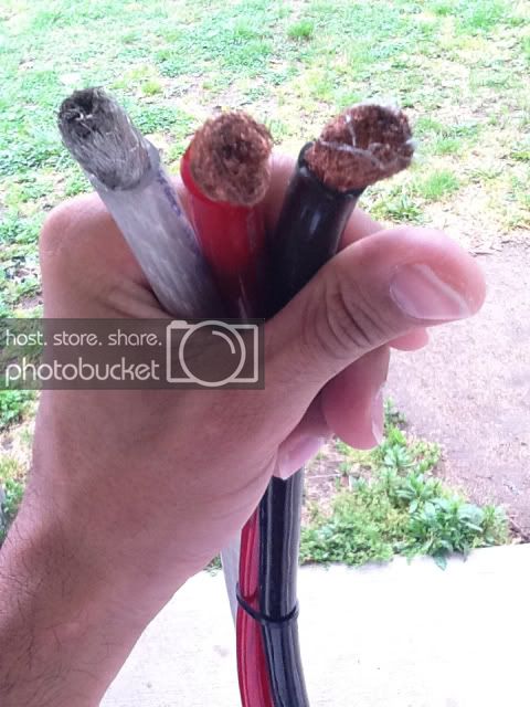

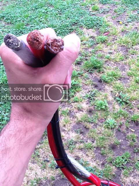

Here is 2 pics of my 1/0 wire that I have around the house.which are Cca and which are Ofc? I want to use Ofc so thats why I'm asking so that I can know whats usable.
Far left wire is silver looking ,the red & black are a bronze looking color .the silver wire looks more thin then the other 2
