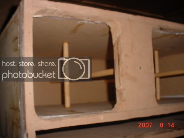

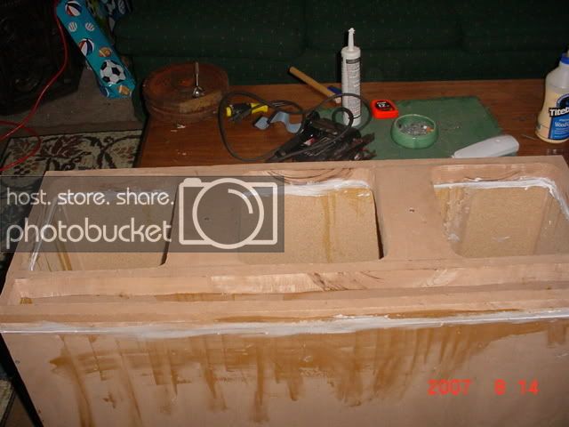

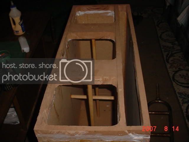

Well I just got the camera working today so I don't have any construction pics but I have some before and after carpet. To do the cuts and what not I only had a circular saw and a jig saw but it turned out decent after some major sanding... now for the show.

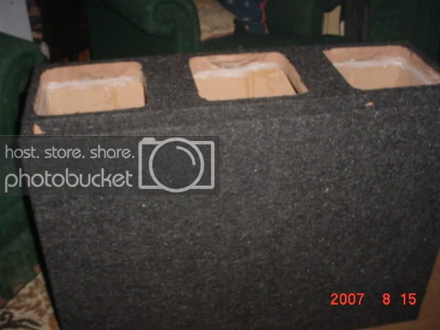

Now for after the carpet... FYI this is my first time carpeting a box. I would have painted the port black but I did not have any paint and it was too late to buy any so I'll mask it off later and paint it.
The side seam is kinda visible
But the bottom seam isn't at all

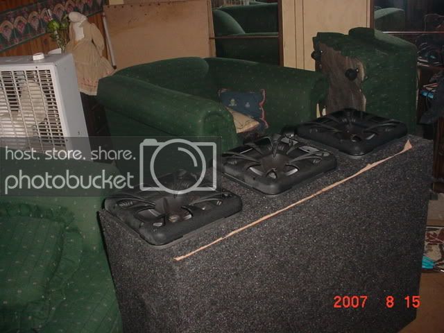

And with the subs...
LMK what you think
Looks pretty good. What are the specs on that box and have you had a chance to hear them in it yet? What are you going to power them with?
The box is 5.2ft^3 at 34 with 82in^2 of port. I will be pushing them with a modded visonik 4000xd set for 1800 watts at 2.67 ohms. I left extra carpet around the port because i wanted the edges really stuck I planed on comming back and trimming it down flush.
Looks good, have you played them yet?
Thanks, I just finished the build today so I have not heard it yet. I will be installing them either saturday or sunday though, and I will keep you guys updated.
