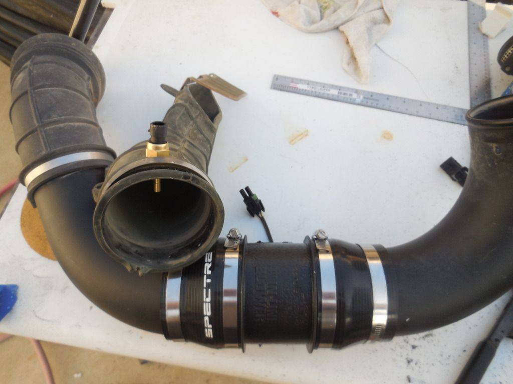

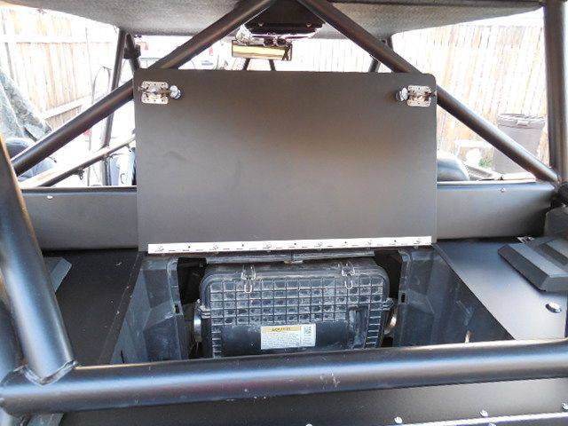

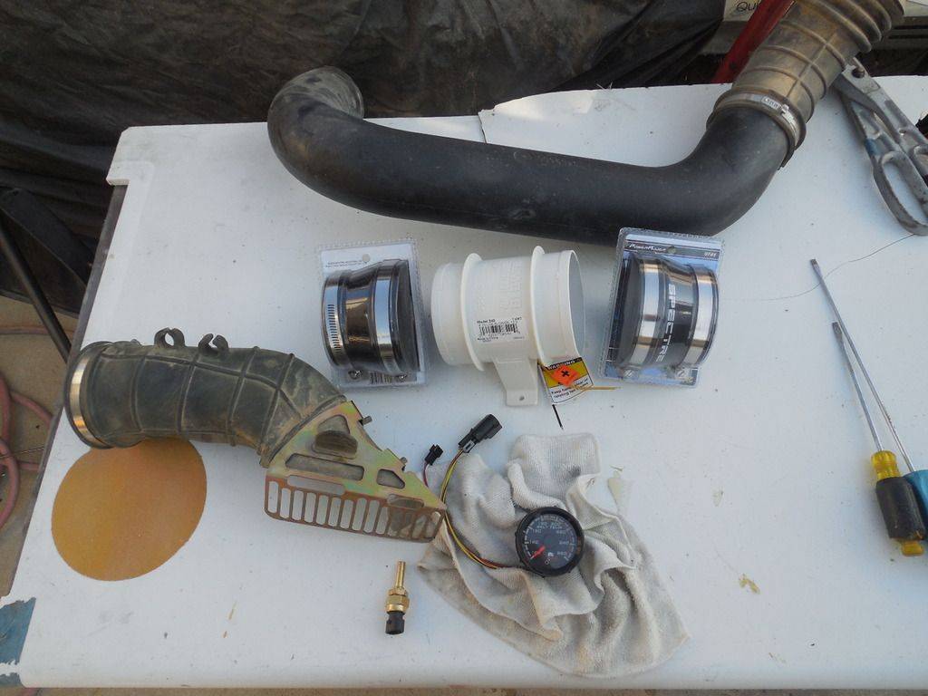

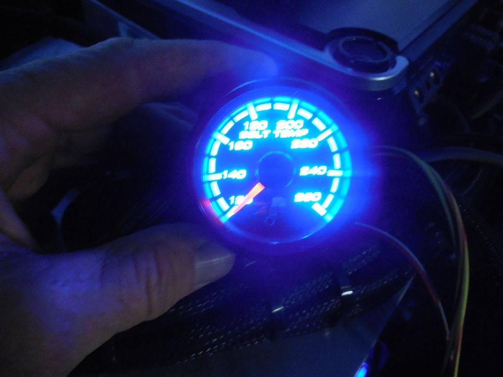

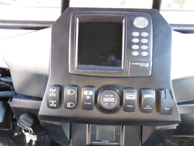

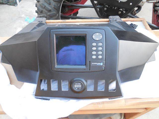

This is the air intake tube for the belt (cvt) drive. A portion is cut out and a Rule 240 bilge blower motor installed to force additional air in when needed. A temp sensor is installed on the exhaust side for the gauge.

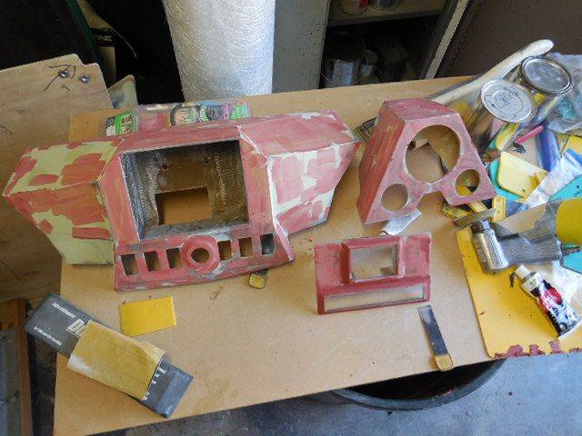

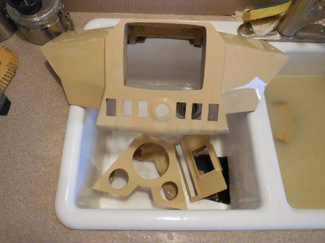

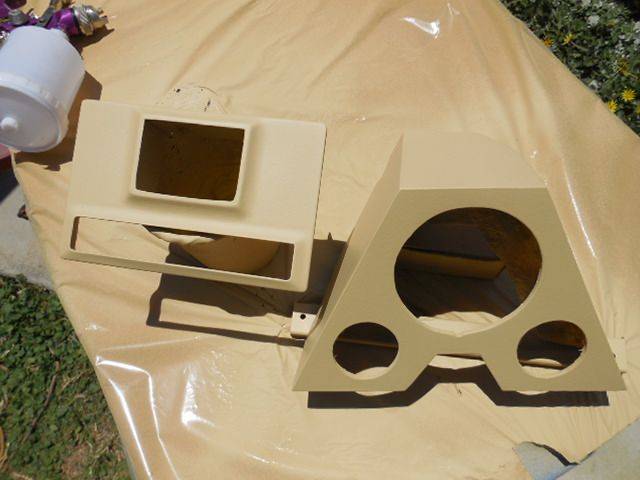

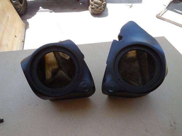

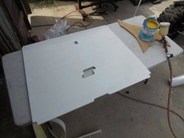

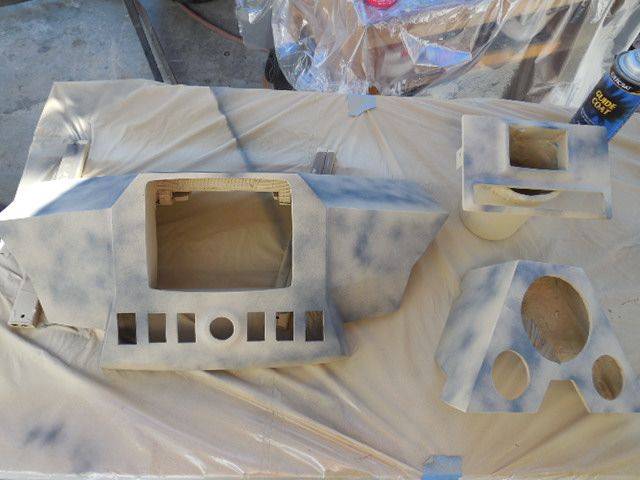

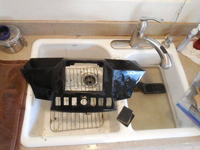

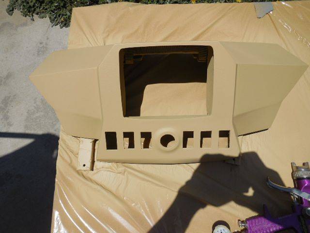

I'm getting my moneys worth out of these pods. I made them in '09 for my 800 then to the XP900, now modding them to fit the 1000 using marglass.
Spot puttied

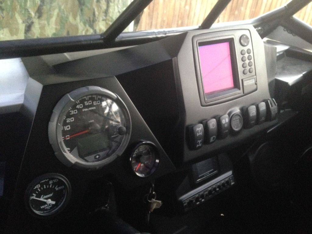

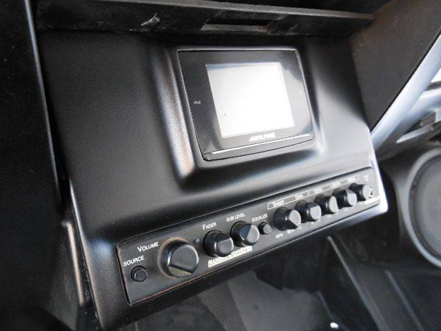

Cleaning up the edges around the Lowrance for more of a flushed in look
Polyprimed then guidecoated

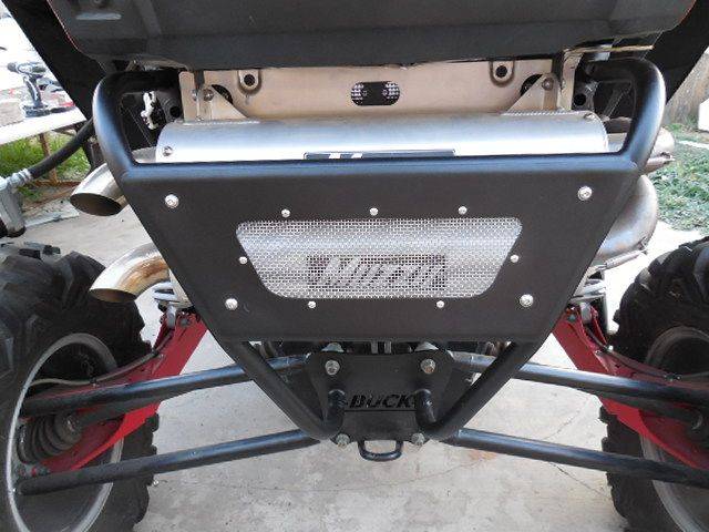

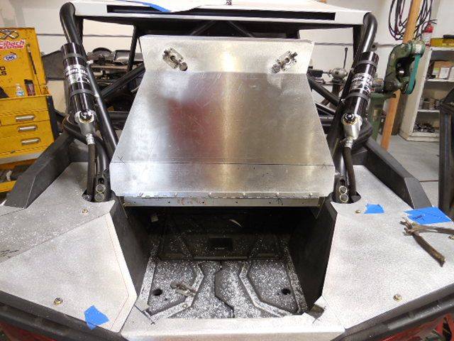

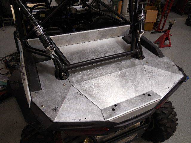

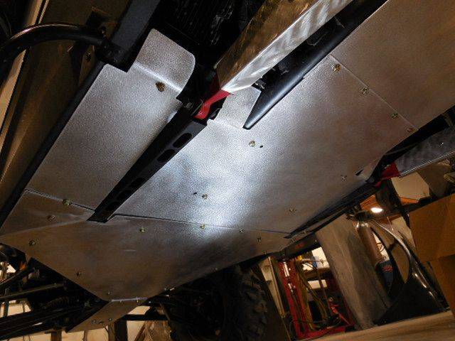

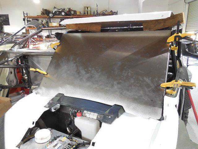

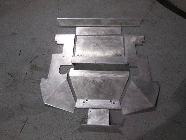

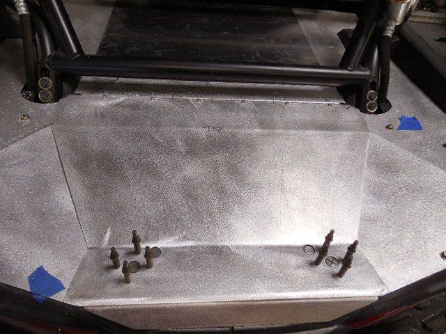

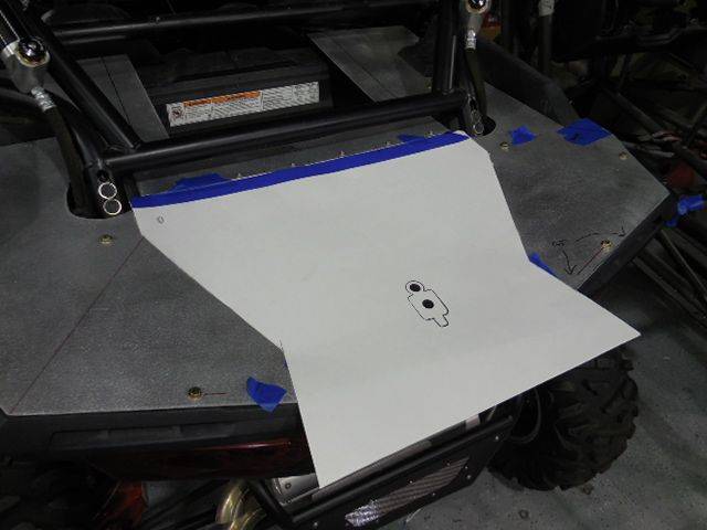

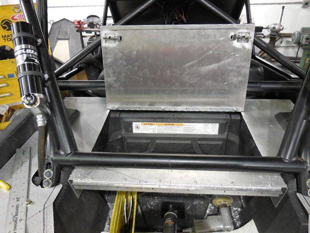

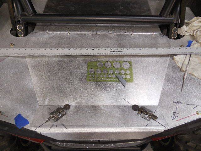

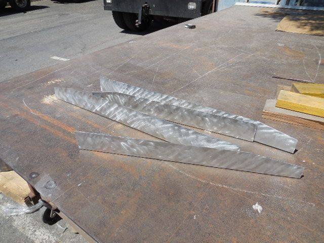

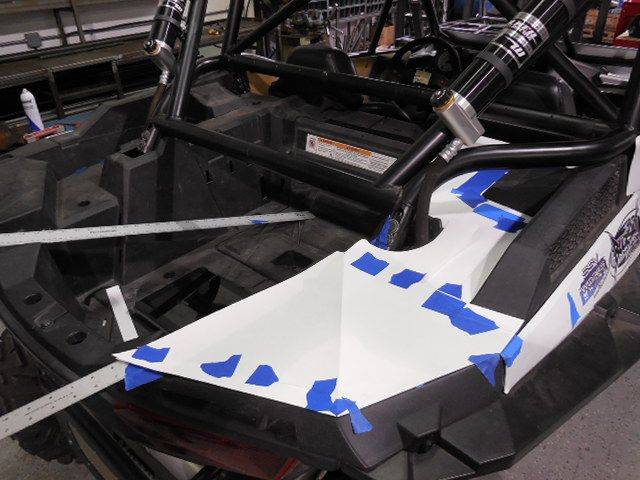

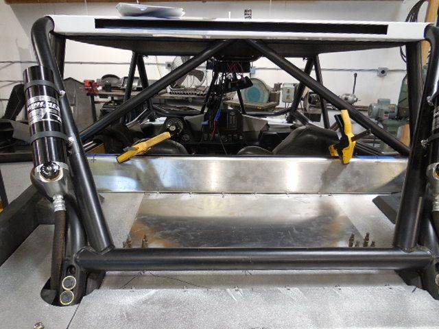

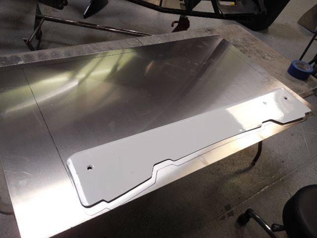

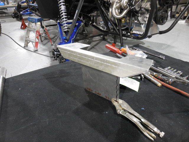

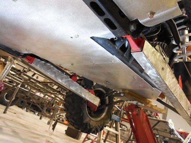

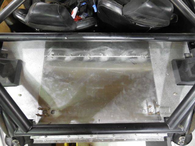

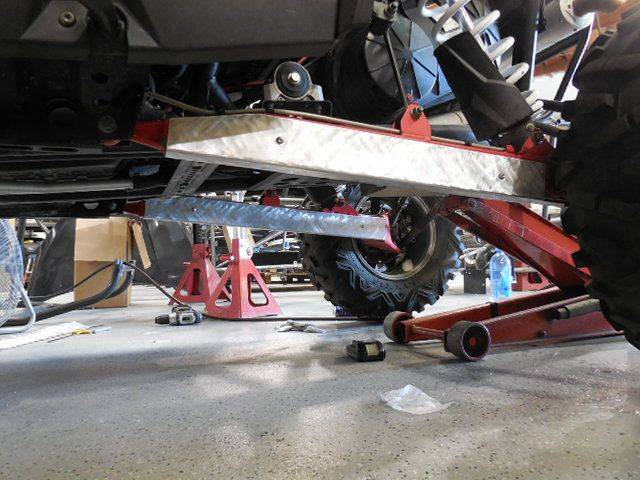

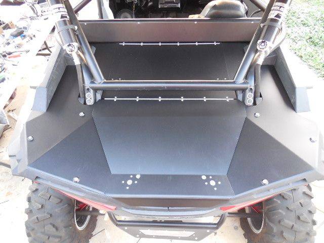

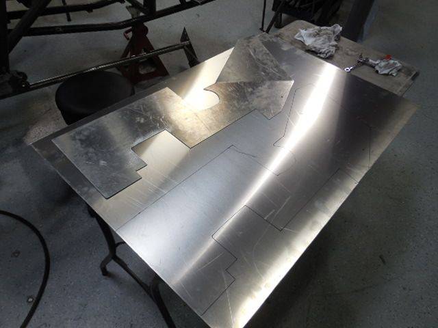

I work at Buckshot Racing in my spare time doing wiring and fiberglass but never have any time to learn and do any aluminum work. I figured I have a shop with all the tools at my disposal so time to take advantage of it. I started off with the easier stuff and I made trailing arm protectors, full skid plate and stared on the windshield. The part I was most excited about was doing the bed. This is where I called in for some help from the pros, other than the welding, a little hand holding on the brake and bead roller, this is about 95% me. These Klicos are a nice invention.

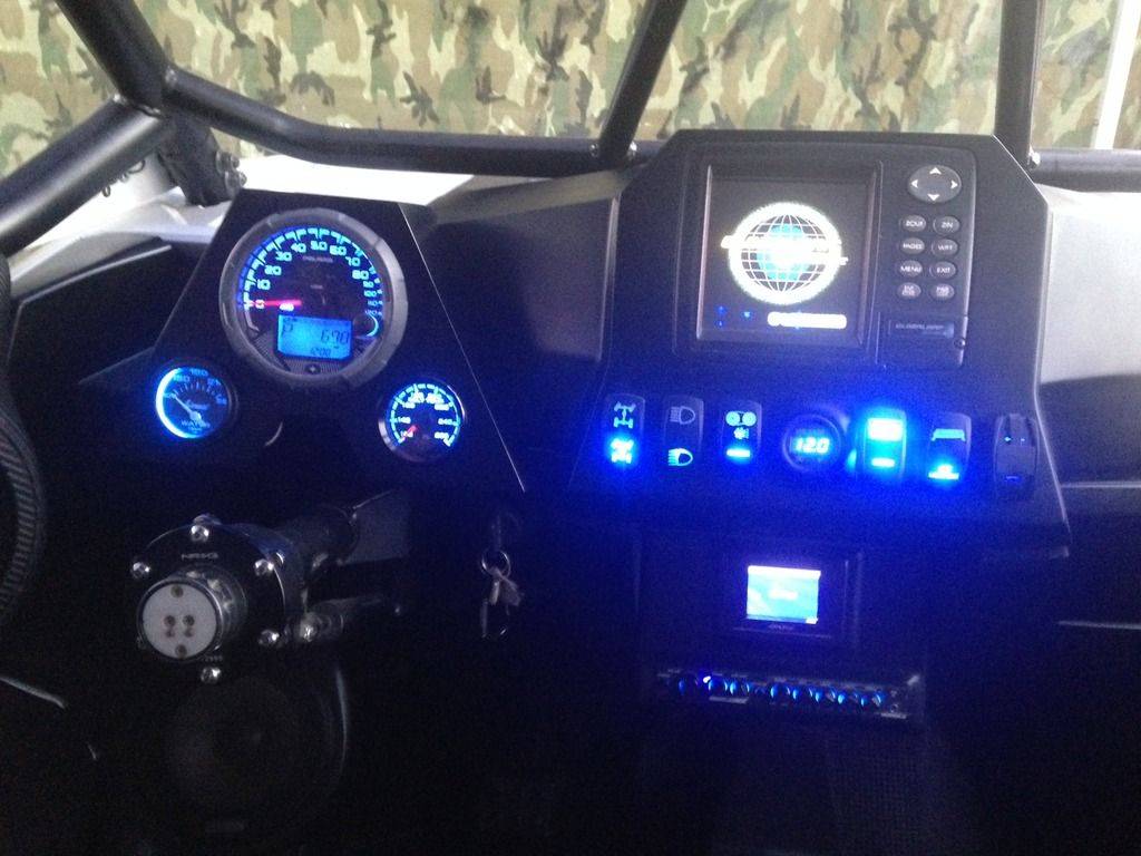

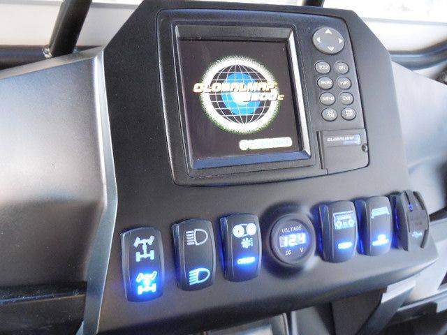

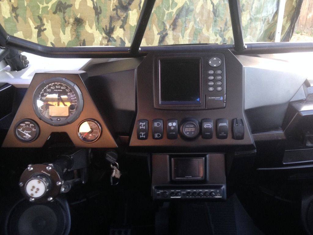

Dash done

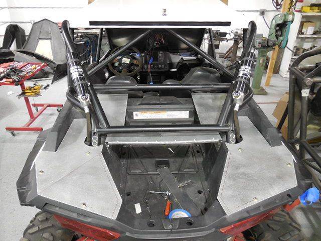

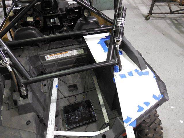

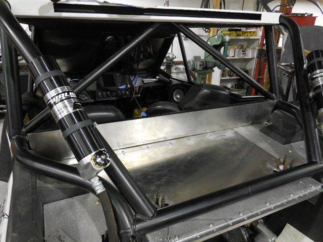

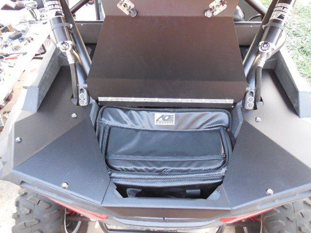

Bed tin done

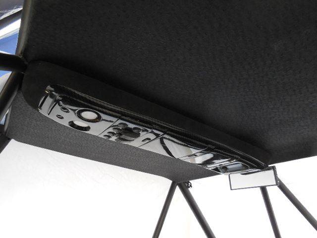

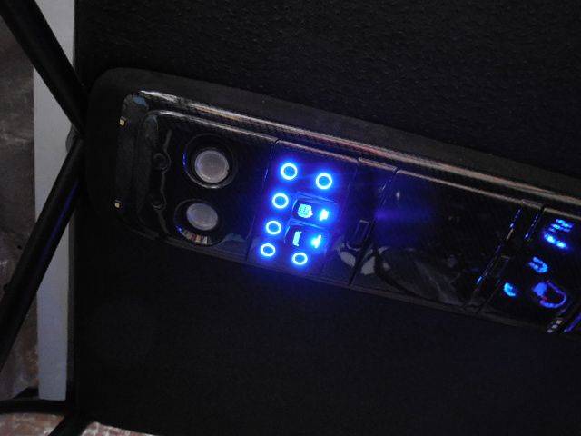

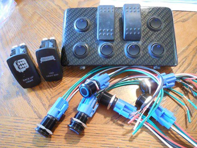

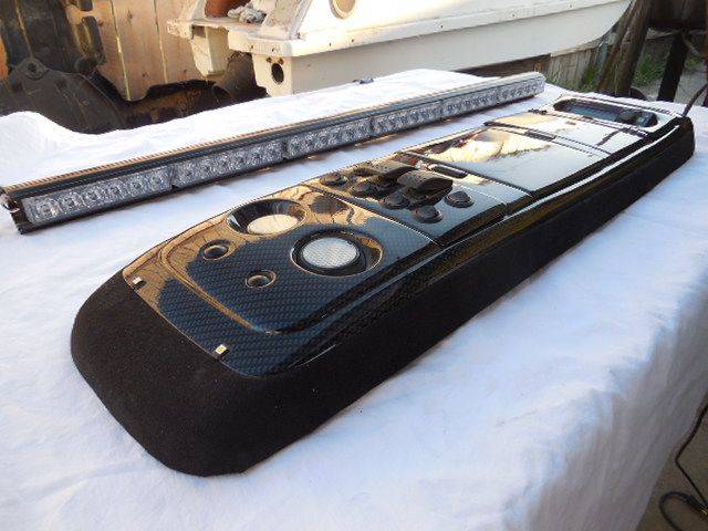

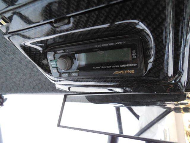

Updated 7 year old overhead console switches

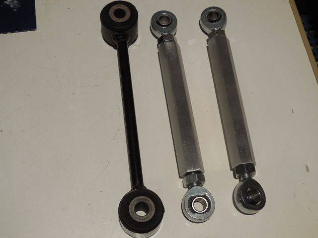

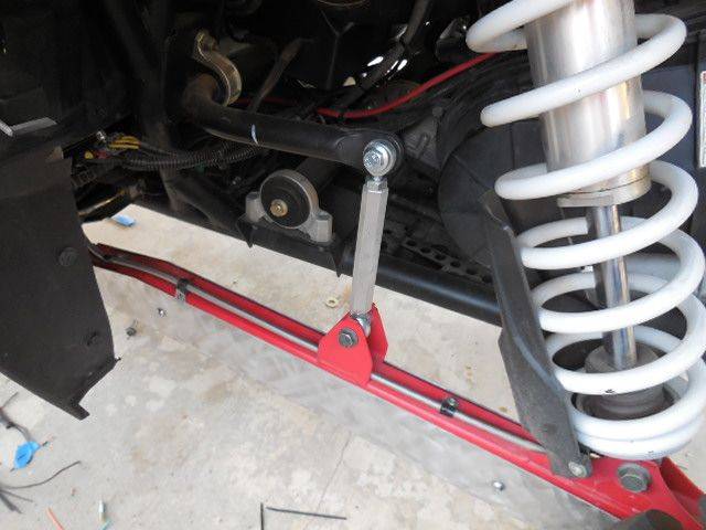

Made aluminum hex/heim sway bar end links

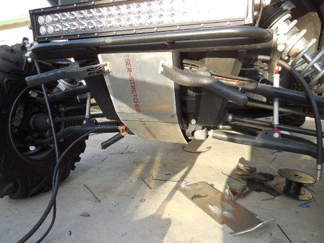

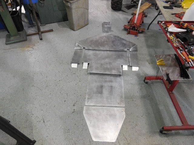

Front skid plate 2.0 in the works

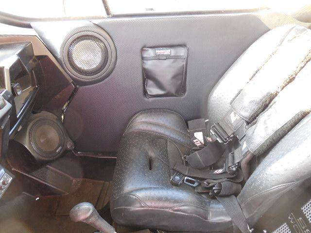

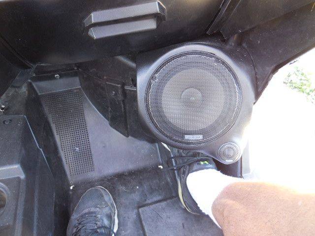

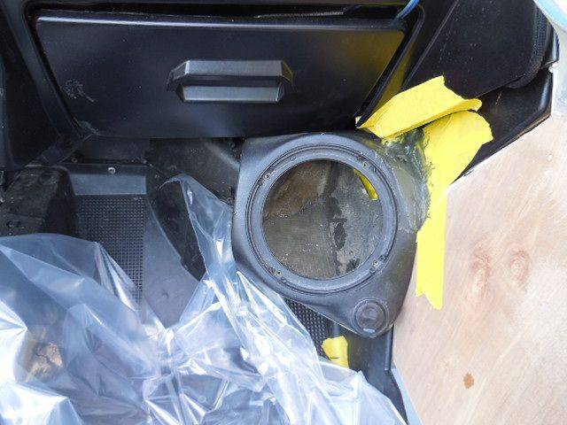

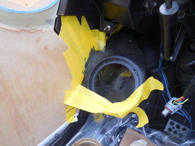

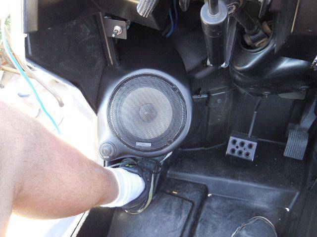

Passenger seat, door panel and door speaker in for final time
