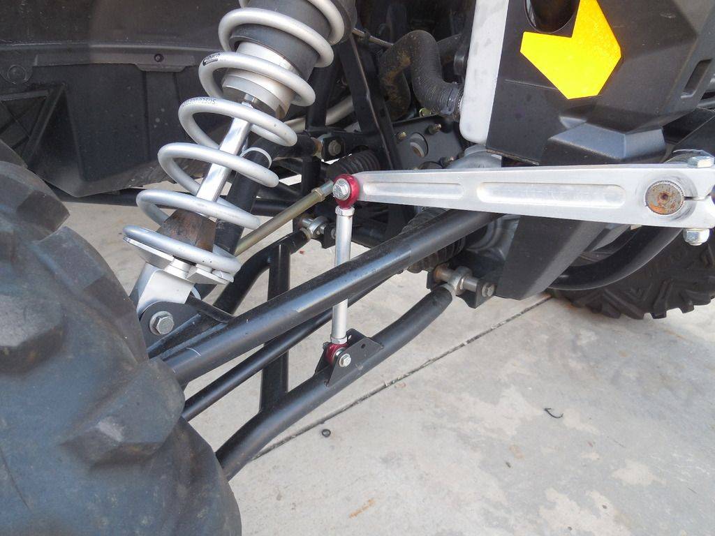

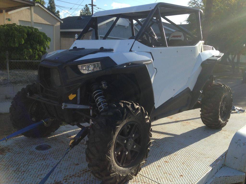

I just picked up a used '14 XP1000. Goodies it came with, CarrOne Worcs cage, Nelson and Nelson front arms with sway bar/bumper, full Muzzy's exhaust with controller, and chromolly radius rods with heims.

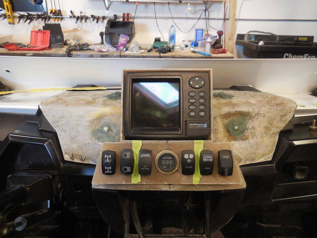

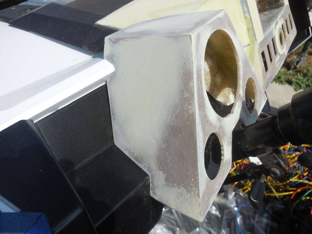

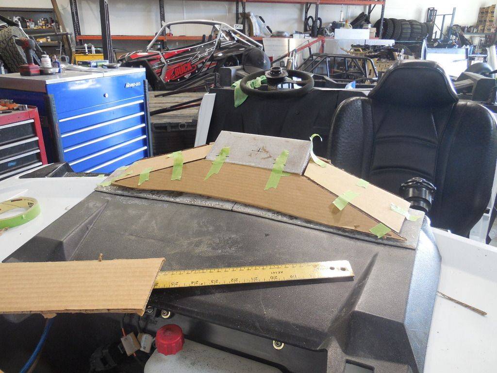

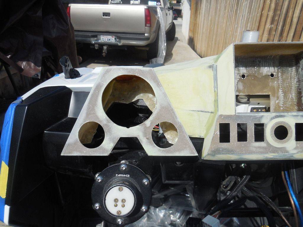

As with my two previous RZR builds I start off by relocating the instrument cluster to where I think it should be.

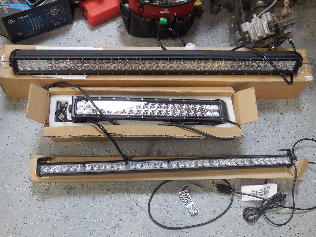

Lighting, 40" and 20" Totron Cree.
36" Rear led light bar with amber strobes

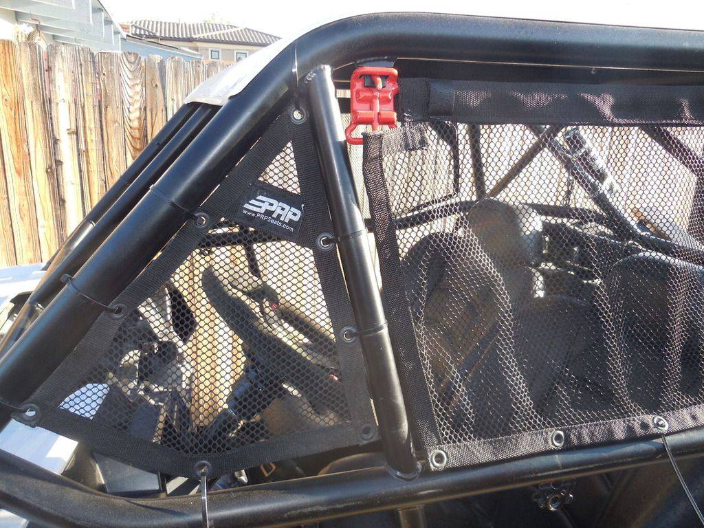

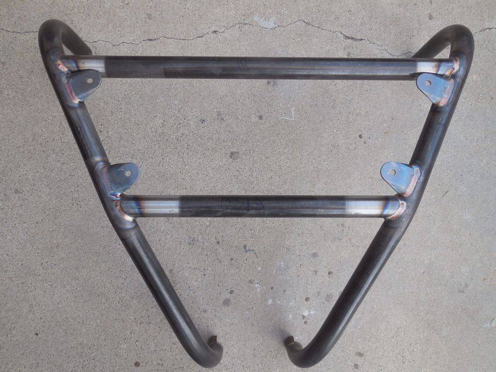

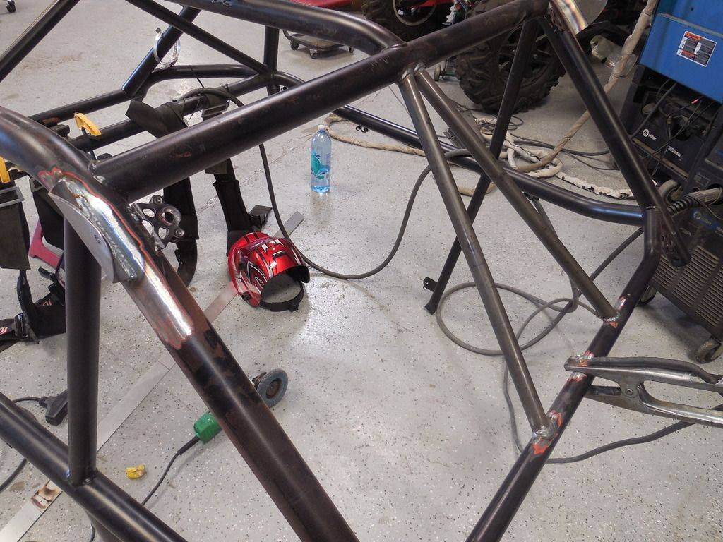

Light bar tabs welded in, single intrusion bar cut out, replaced with A bars and window net tabs cut off.

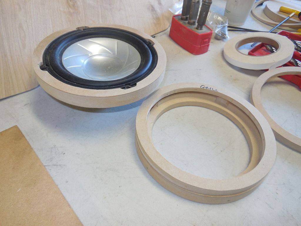

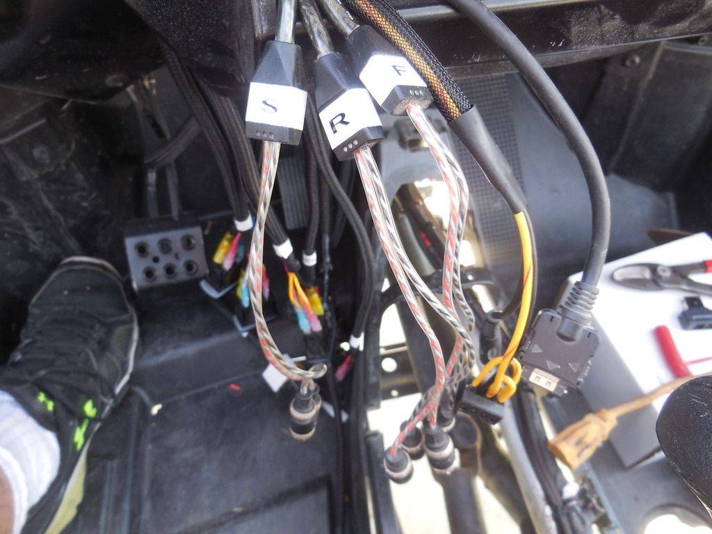

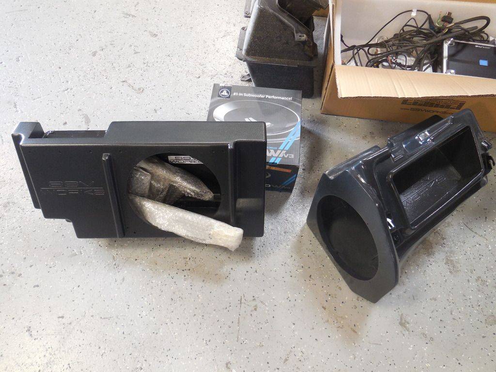

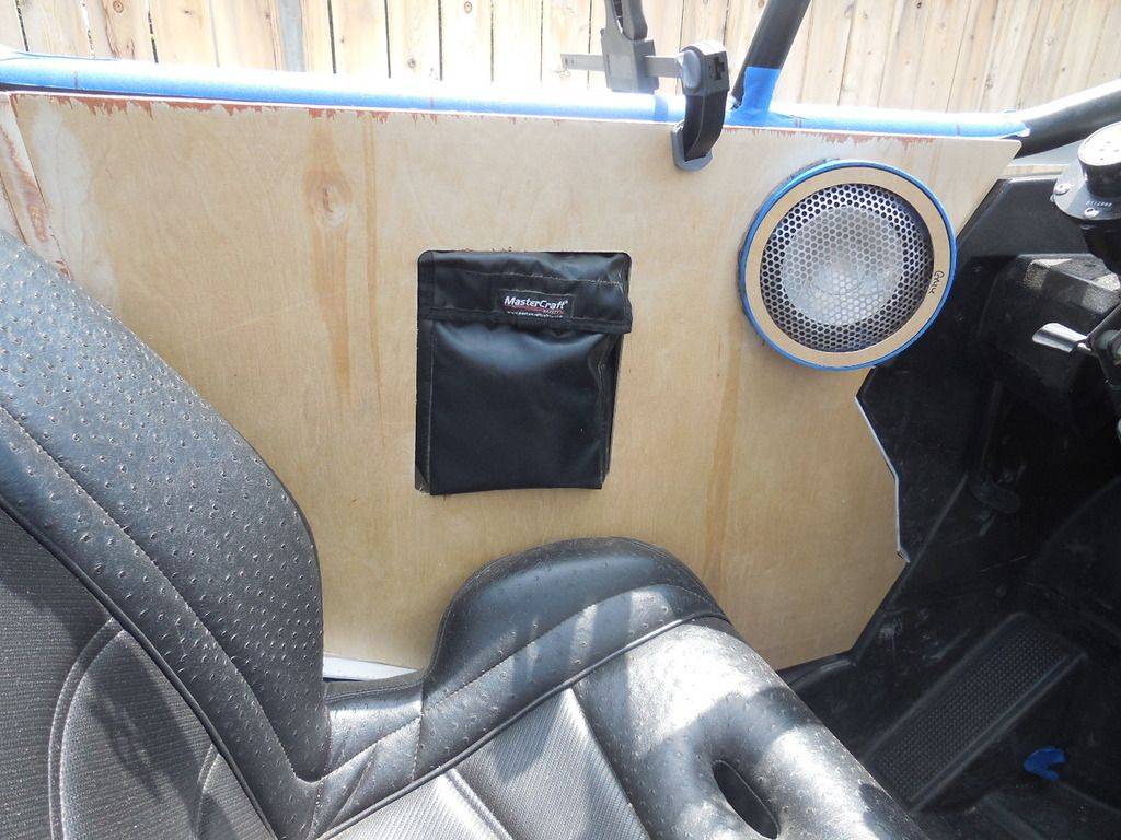

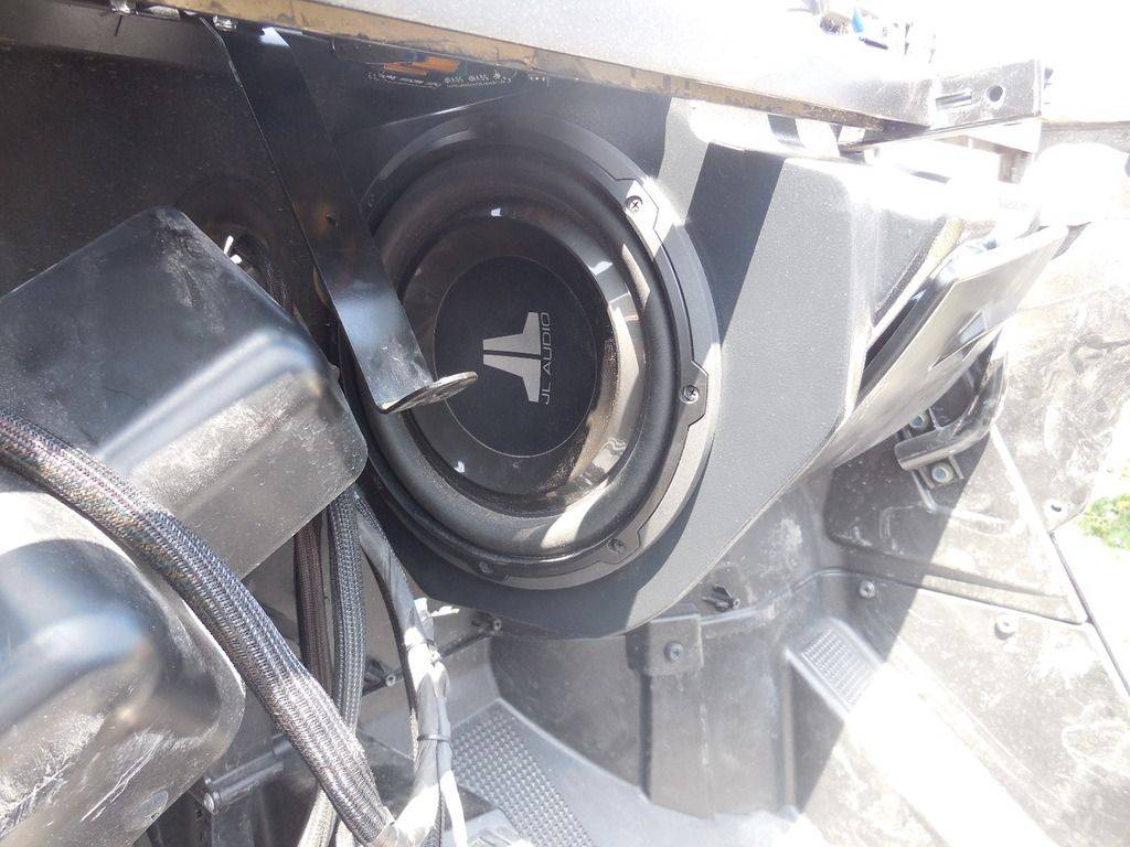

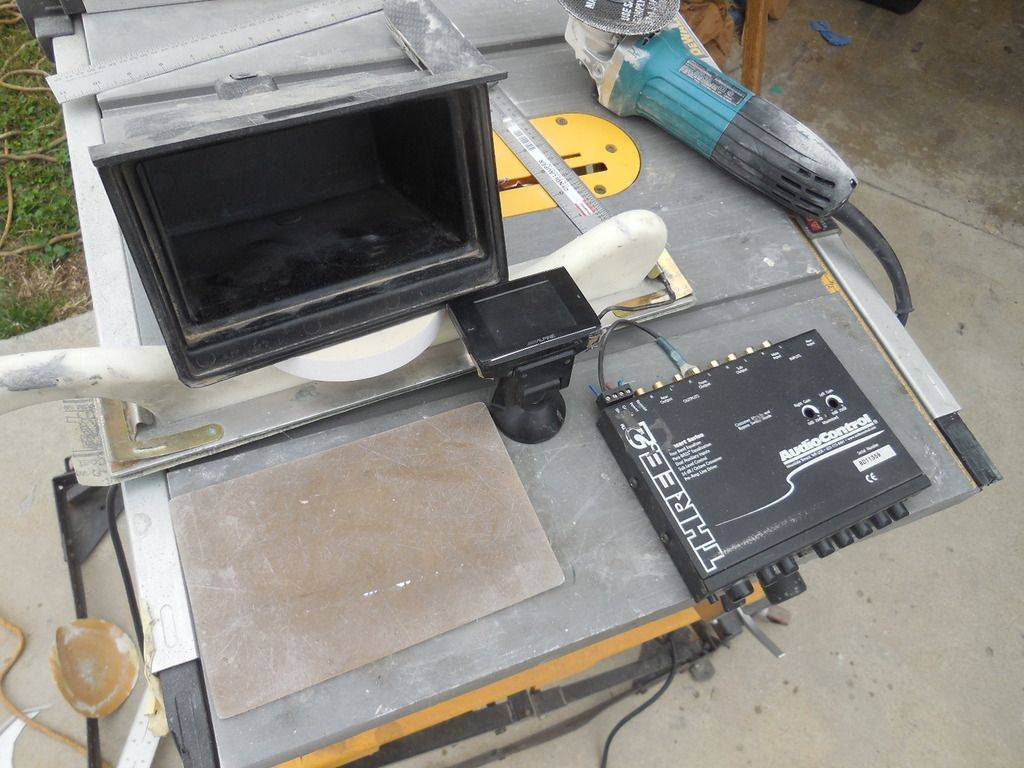

For the sound system I will be using some new equipment, everything from my XP900, and some stuff I have laying around collecting dust.
ALPINE EX-10-ipod interface with screen and remote

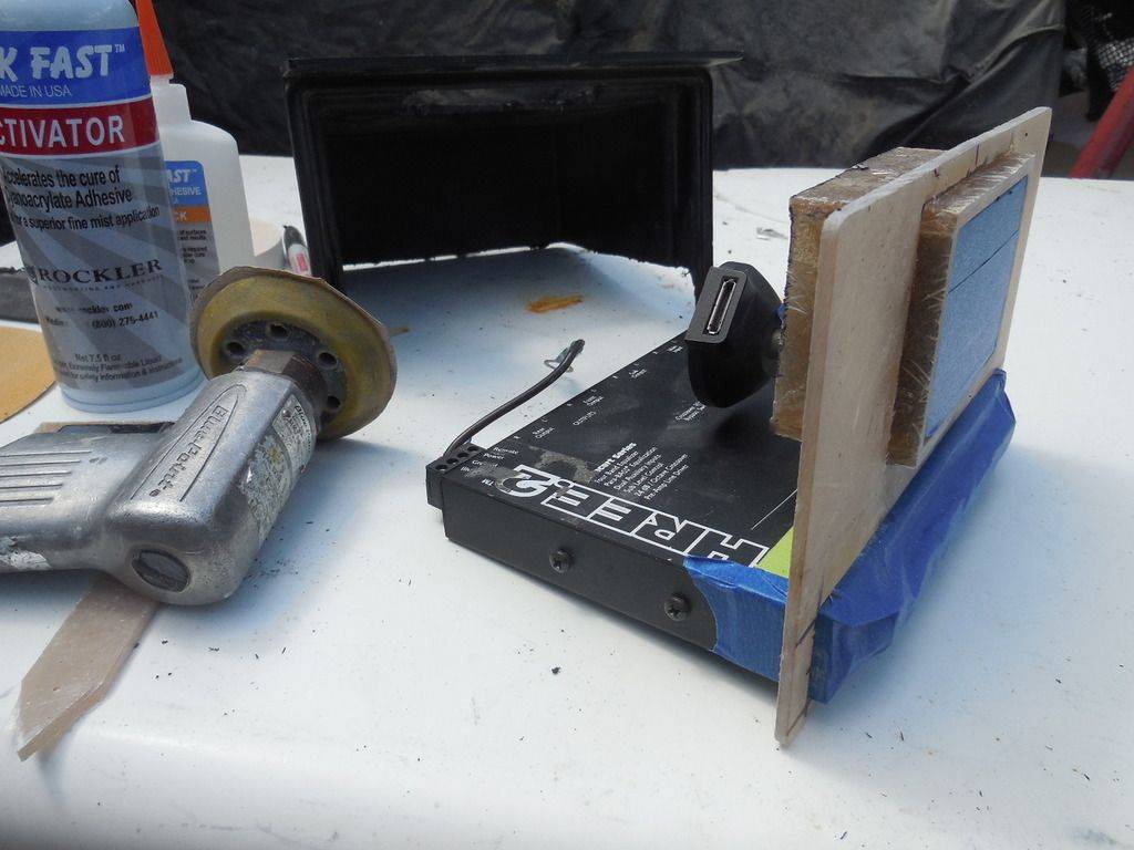

Audio Control Three.2 EQ

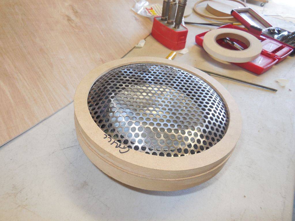

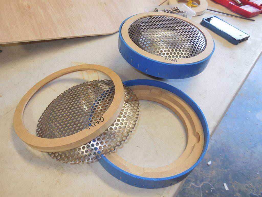

ALPINE PDX-V9 5ch amp biamped to ALPINE SPX-REF 6 1/2" componets+JL 10W3v3-2
ALPINE PDX-2.150 amp 2ch to ALPINE SPX-17MB 6 1/2" midbass
ALPINE PDX-M600 sub amp to JL 10W3v3-2

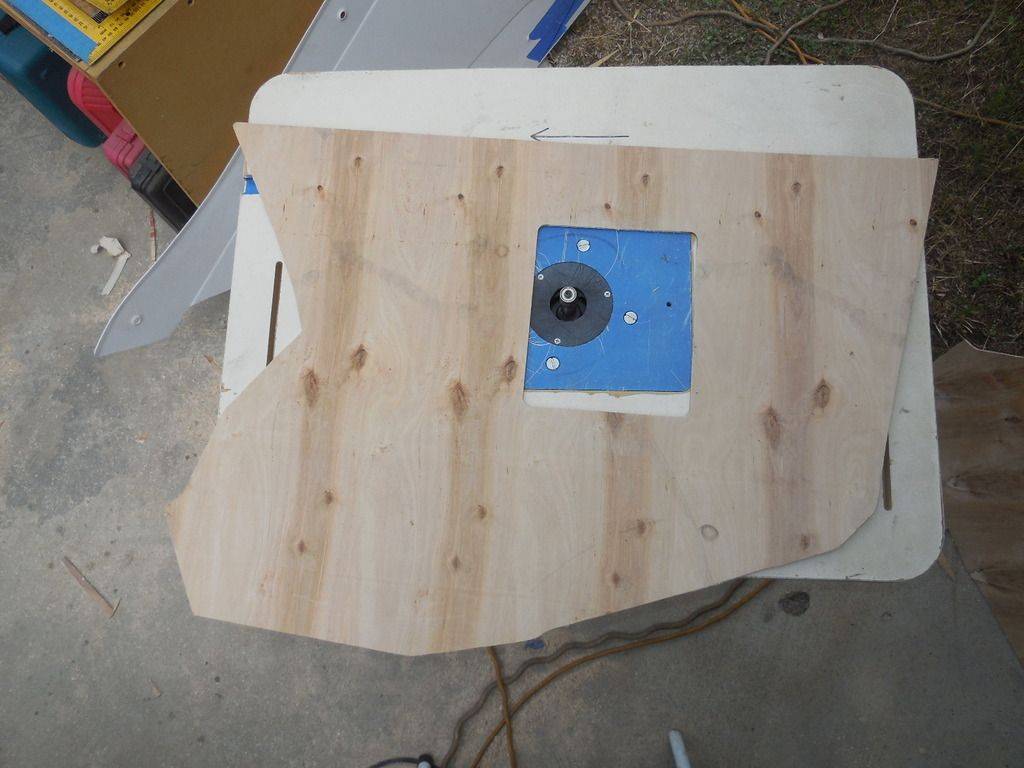

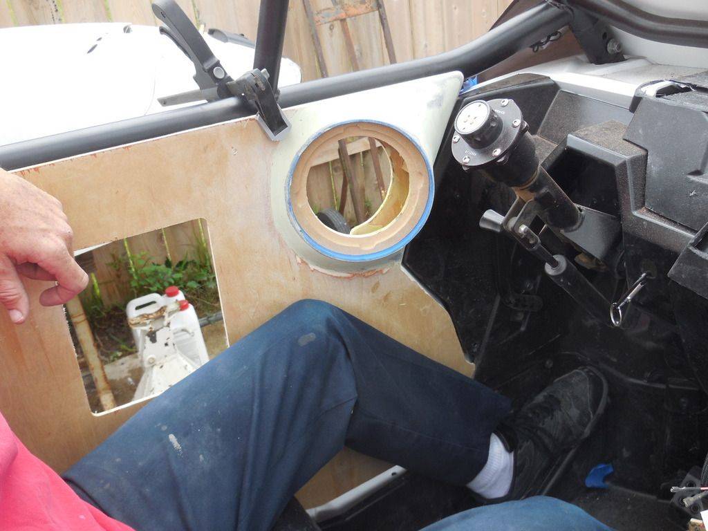

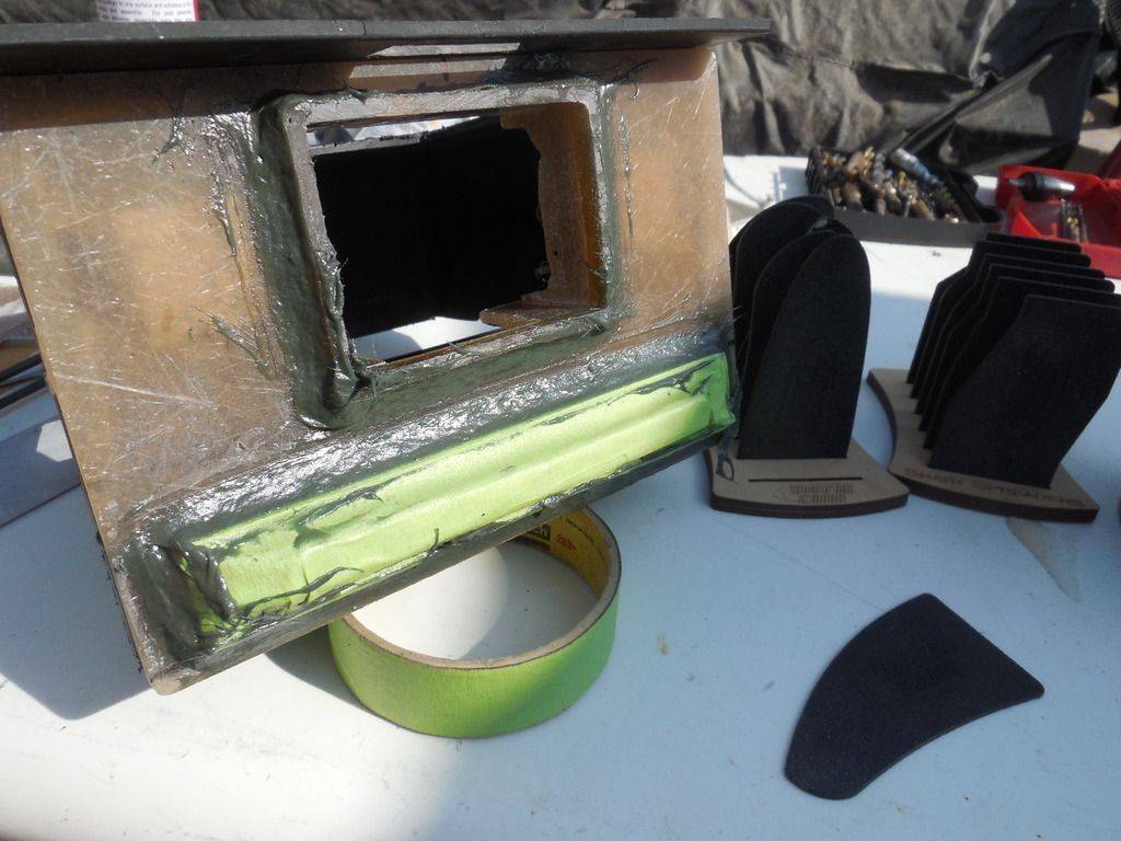

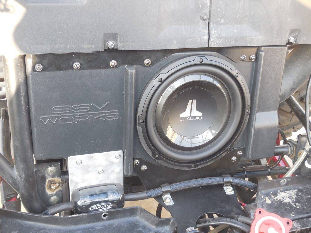

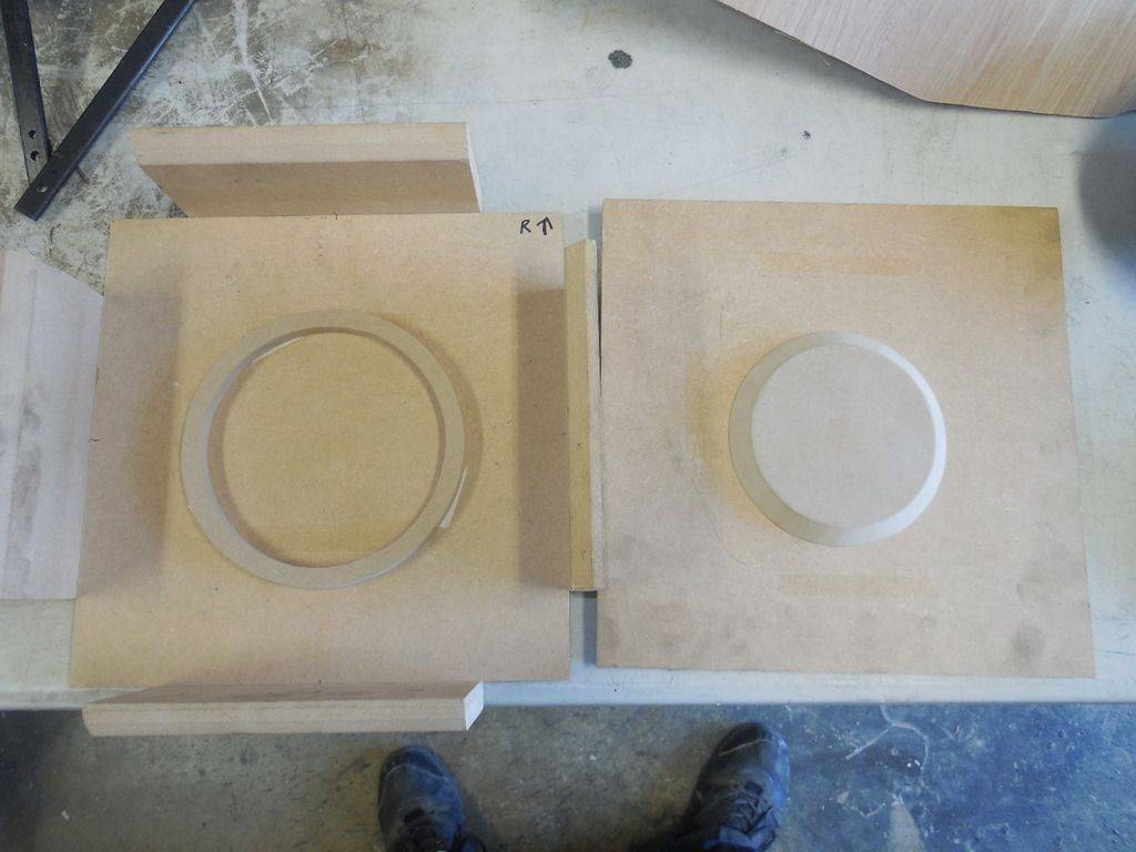

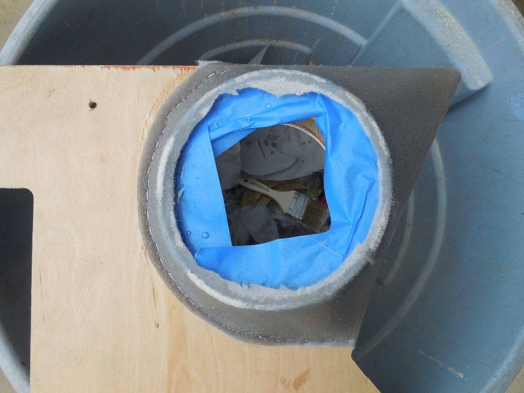

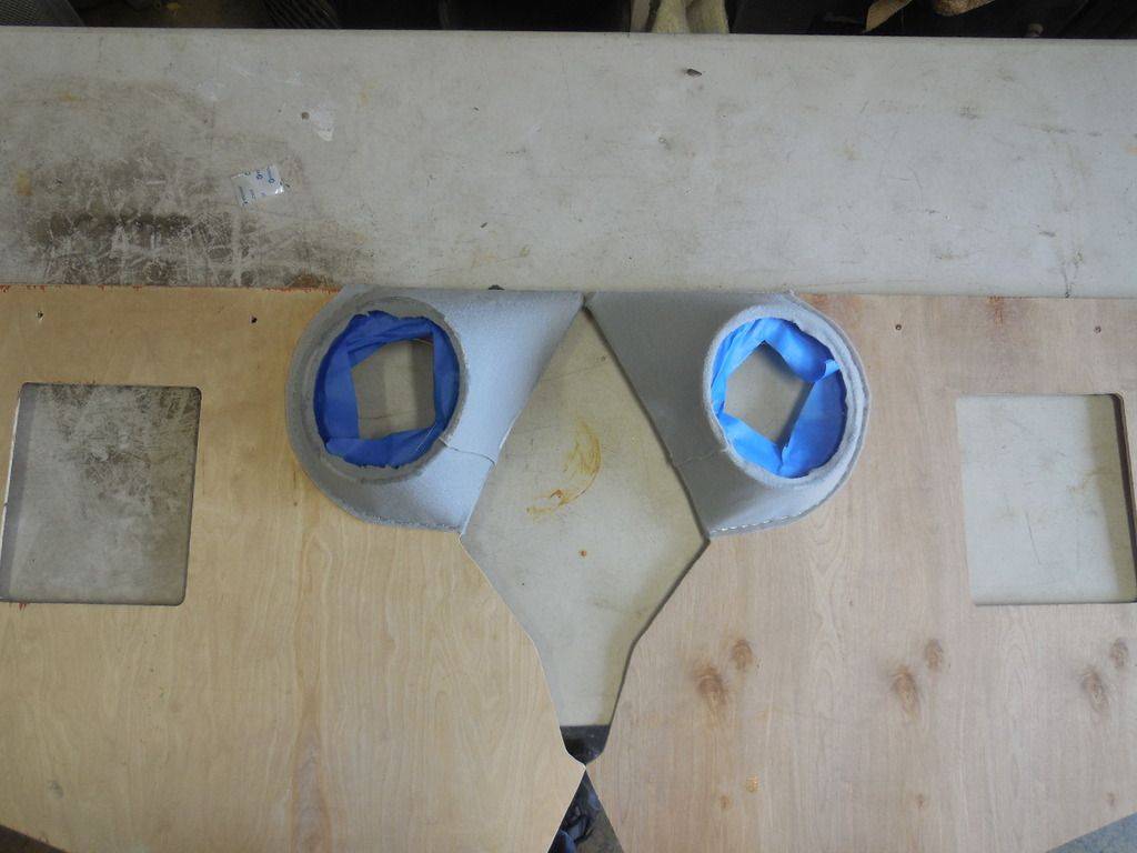

SSV WORKS Glove box sub enclosure
SSV WORKS behind seat sub enclosure

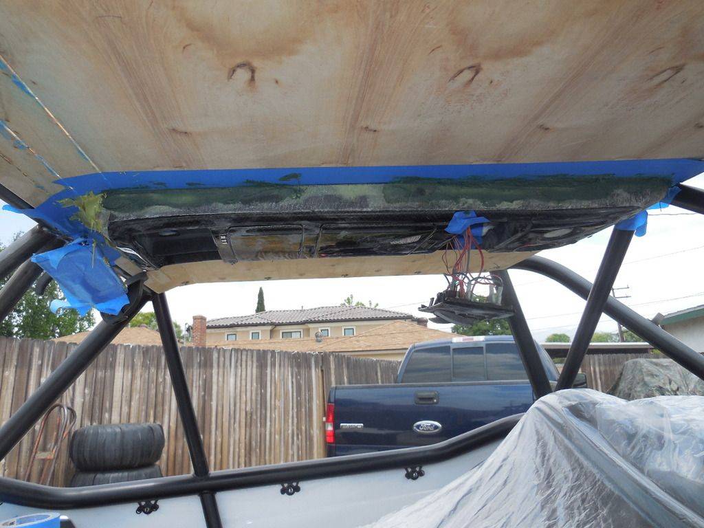

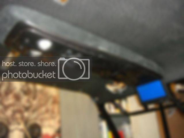

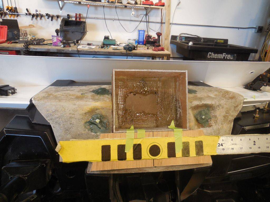

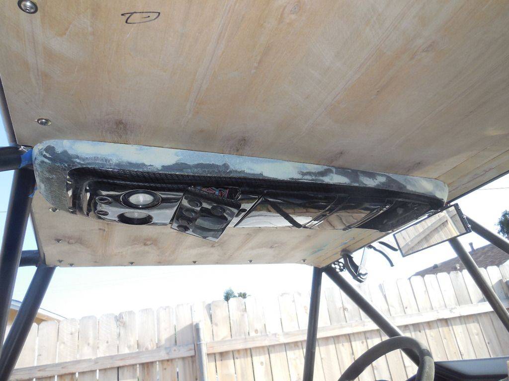

After some cutting, the rear led light bar fits perfect in the roof skin.

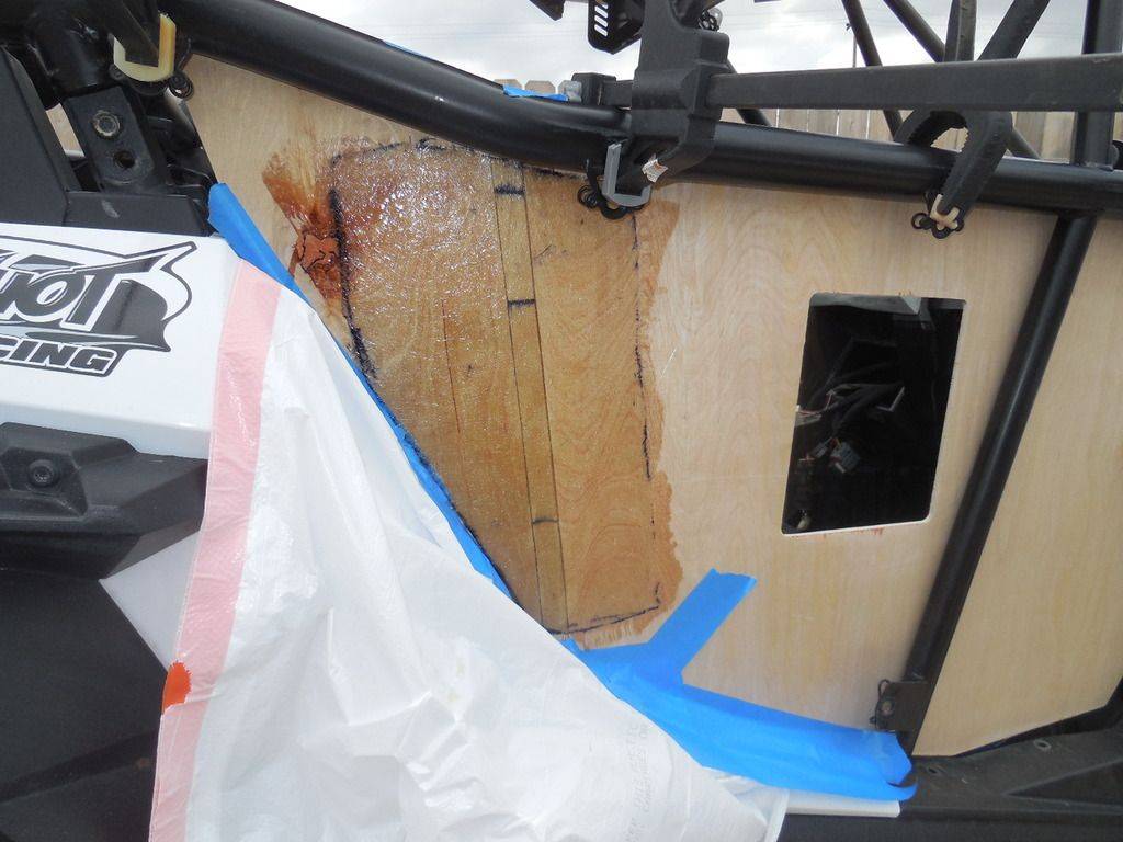

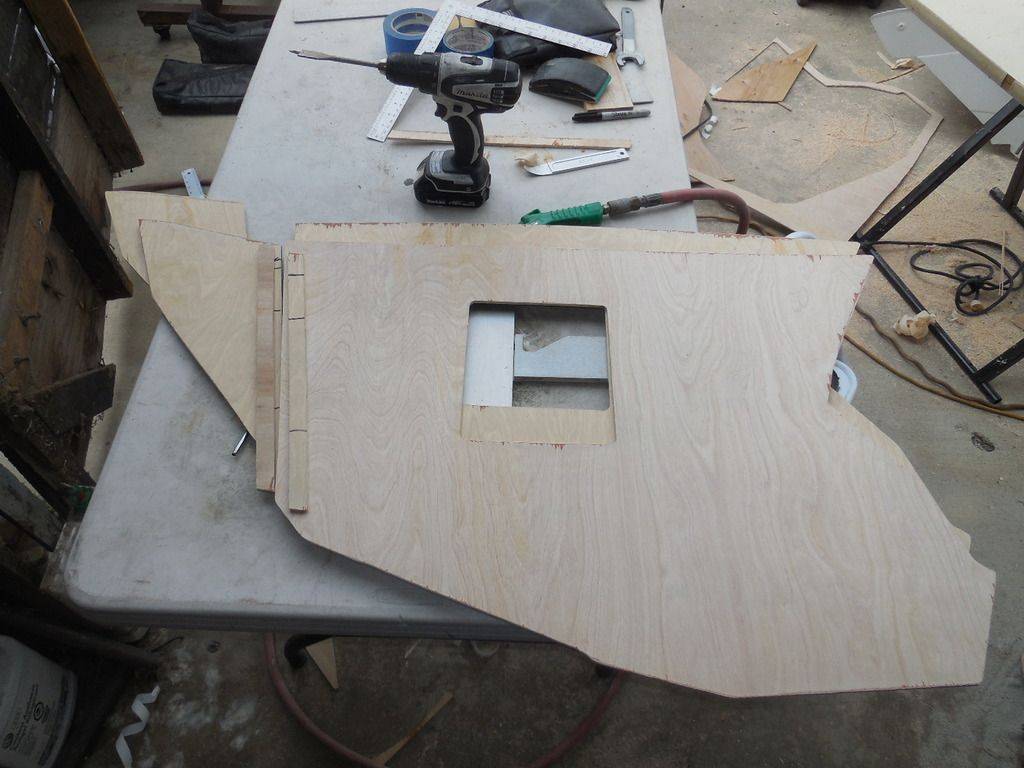

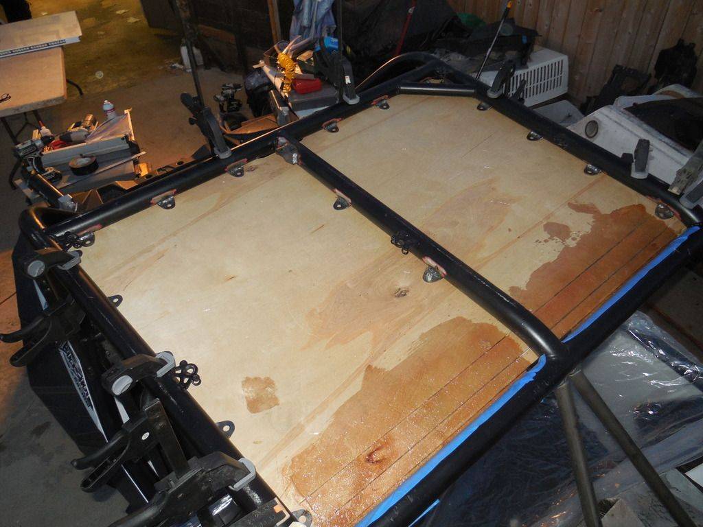

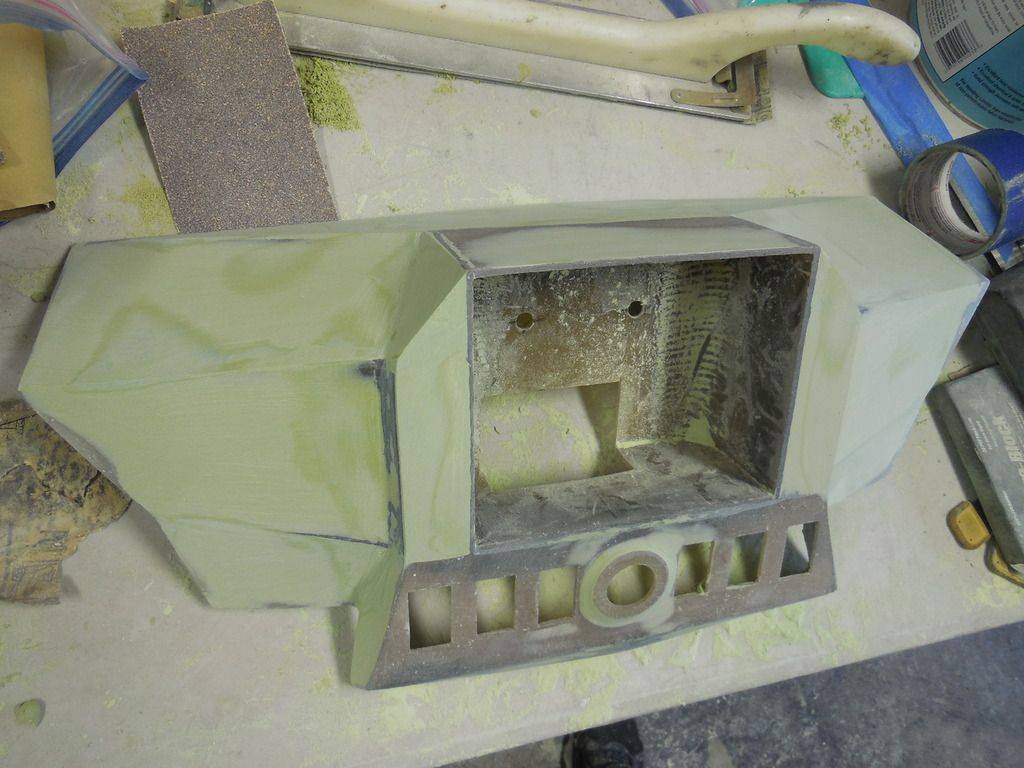

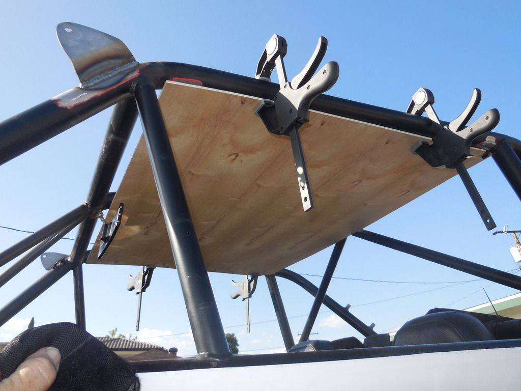

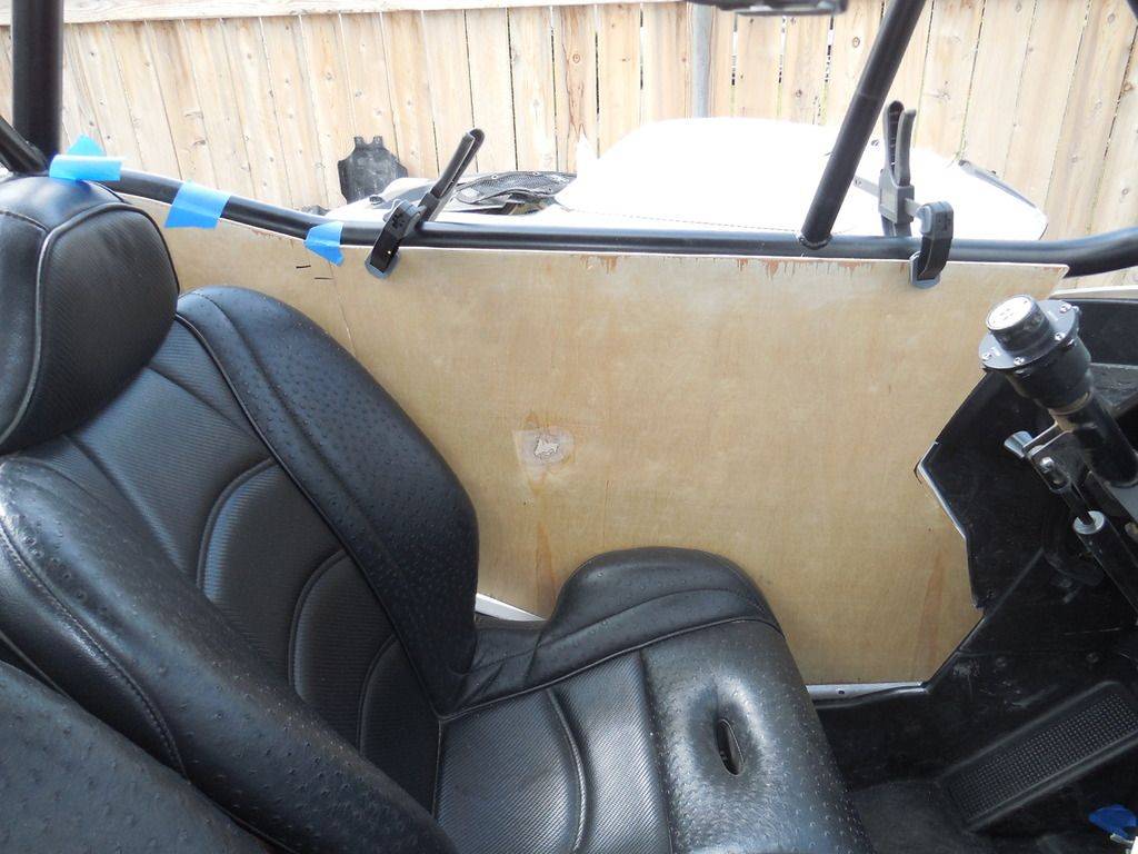

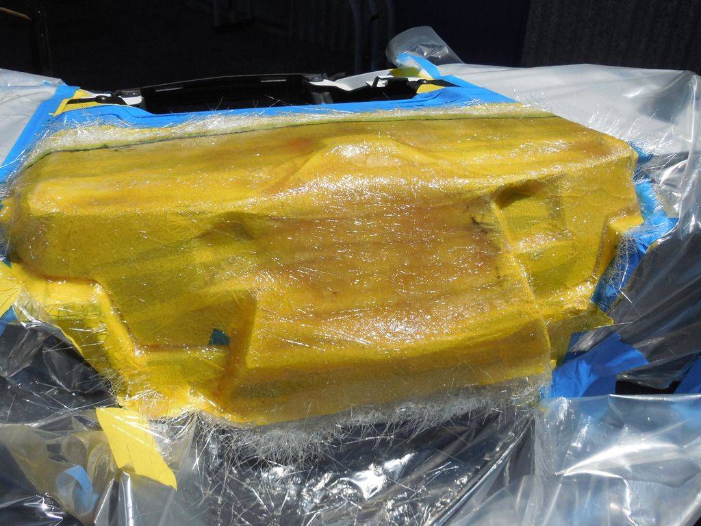

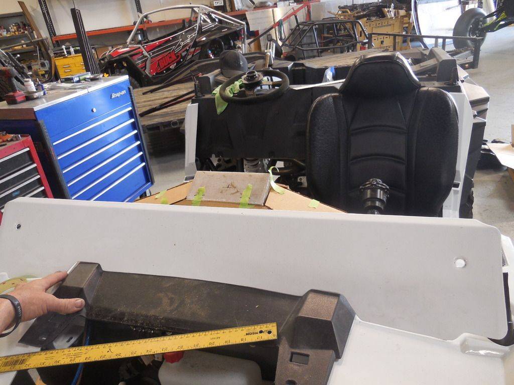

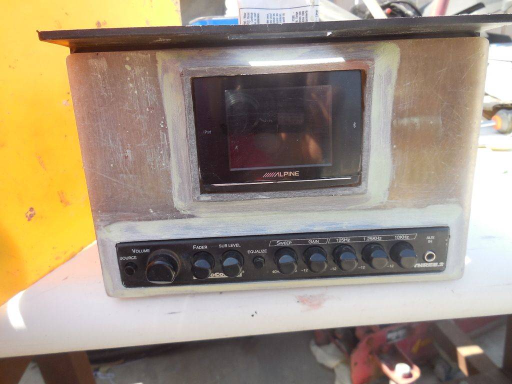

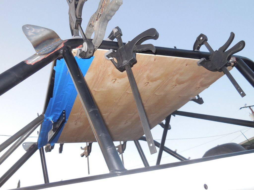

Fabbing the headliner, recycling my modified overhead Chevy console from my first RZR build. This cage has no radius so I had to grind down and clean up where it meets the headliner using Marglass, then ready to be wrapped with black suede.

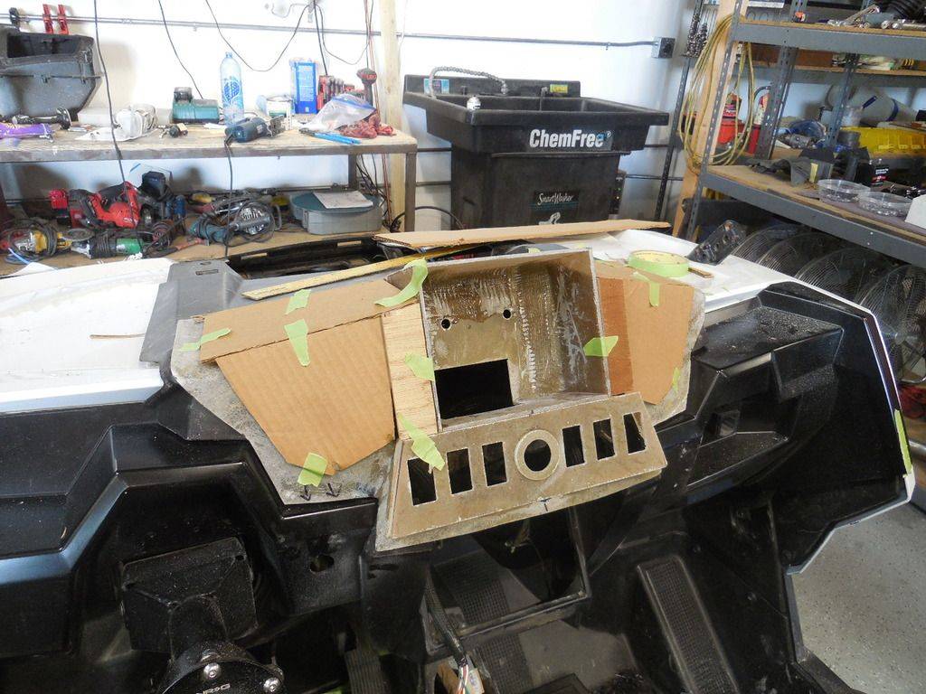

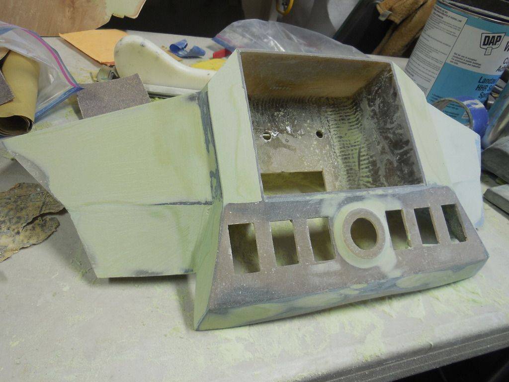

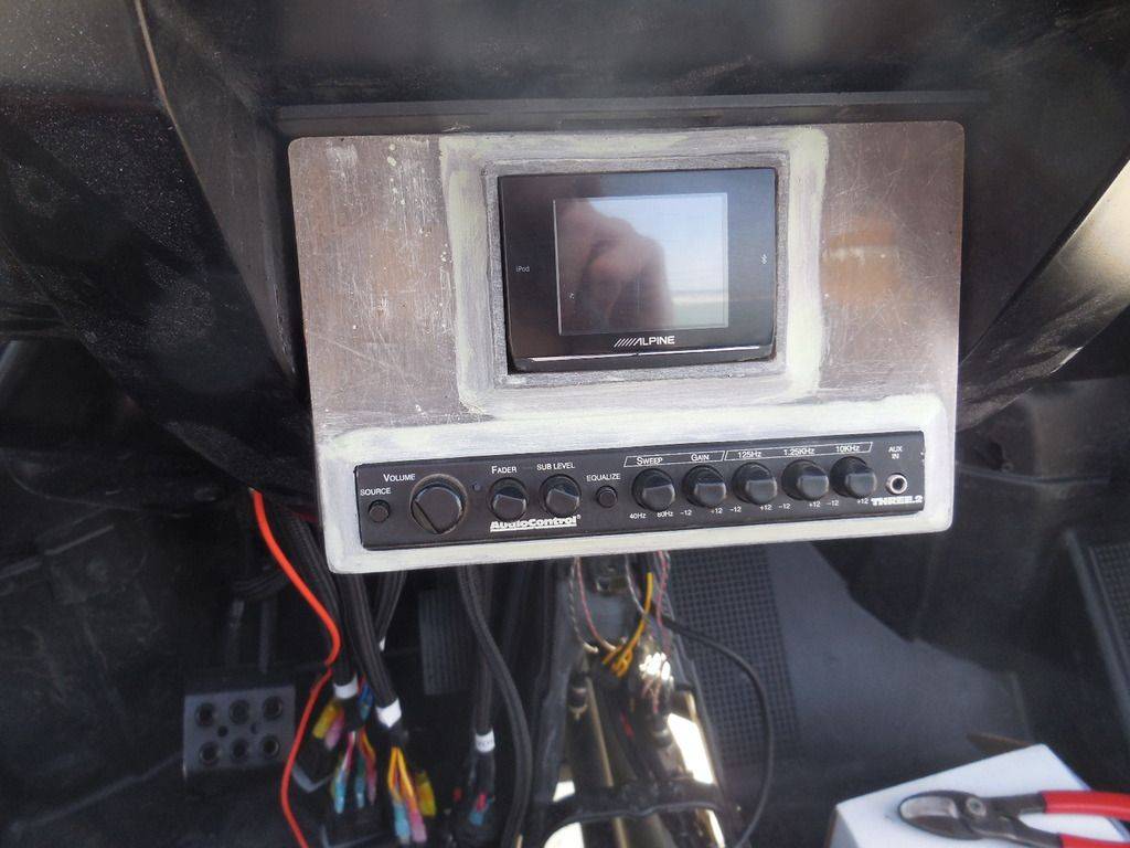

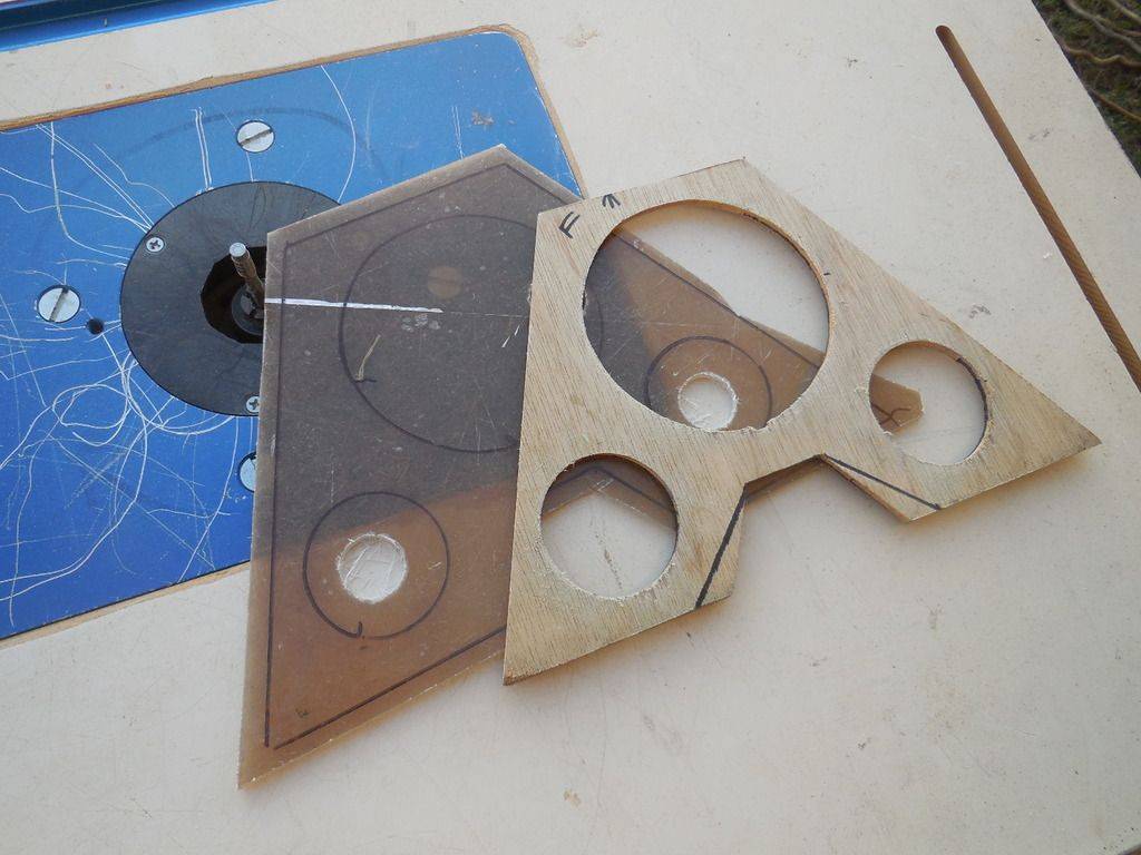

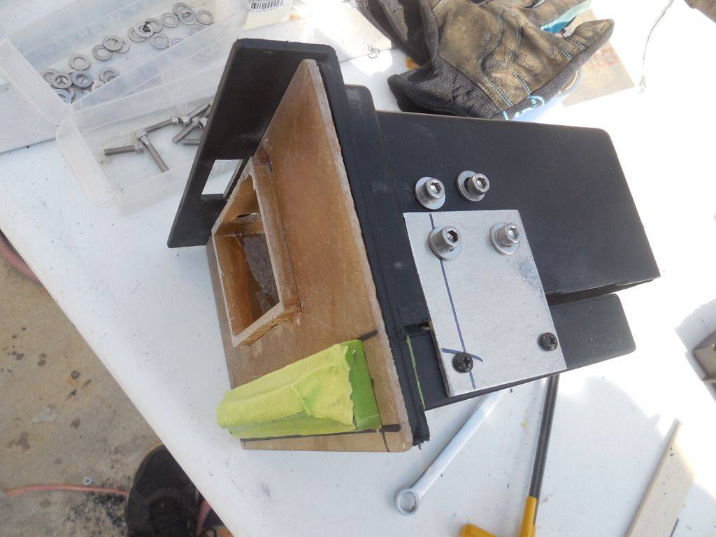

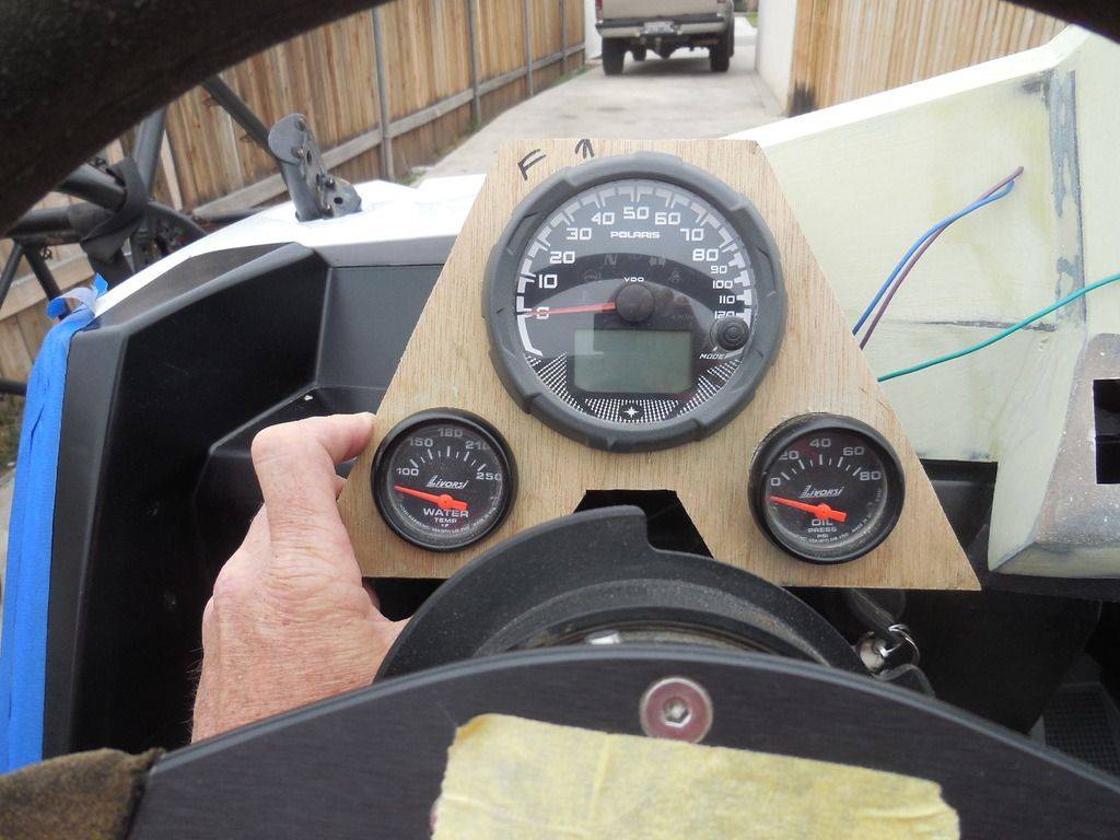

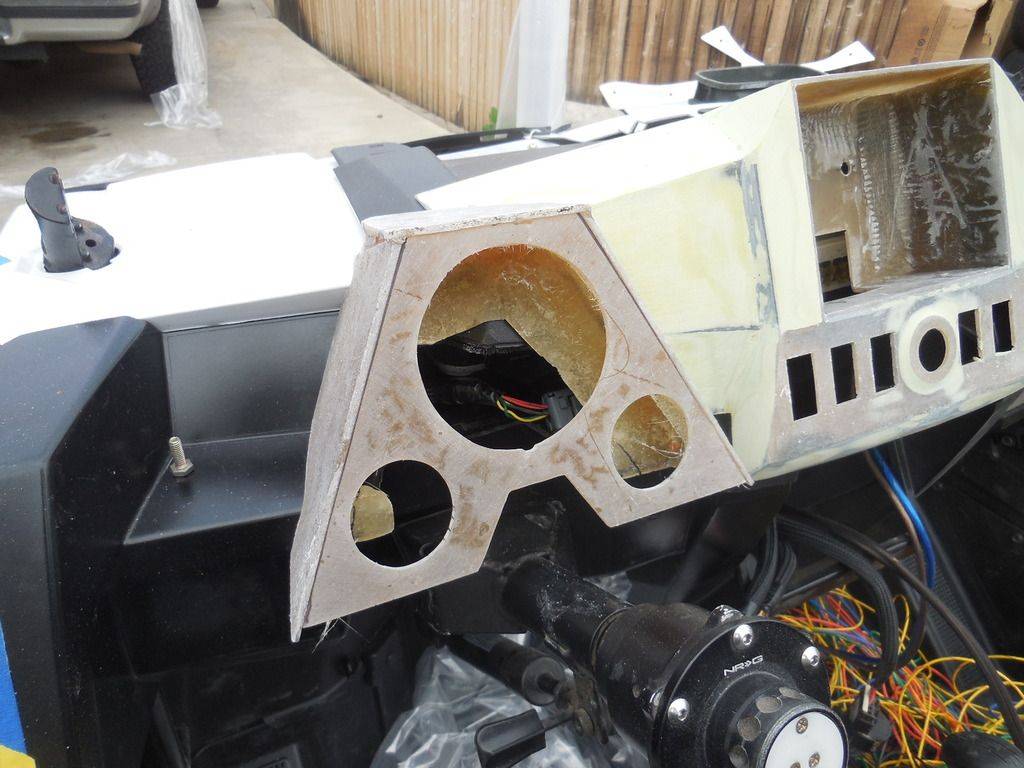

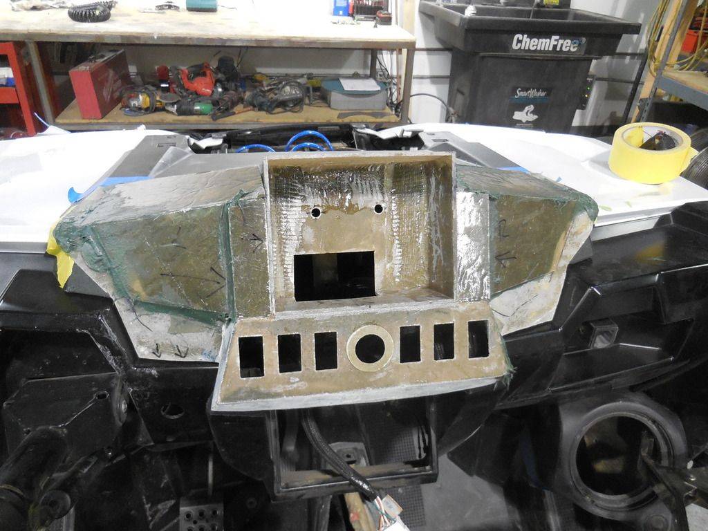

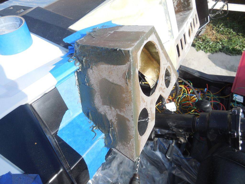

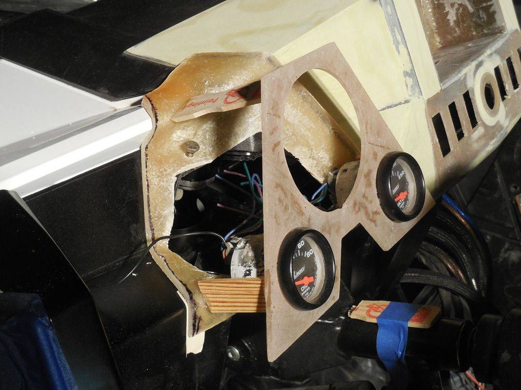

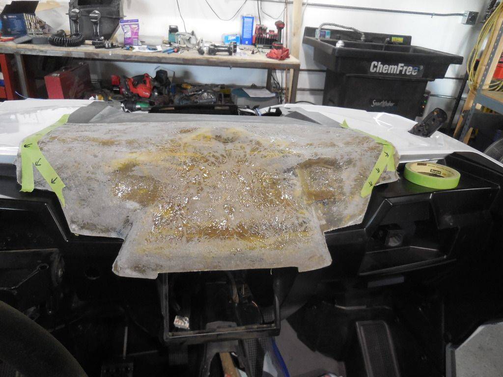

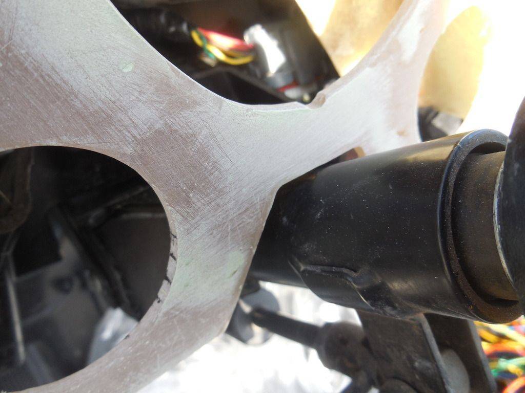

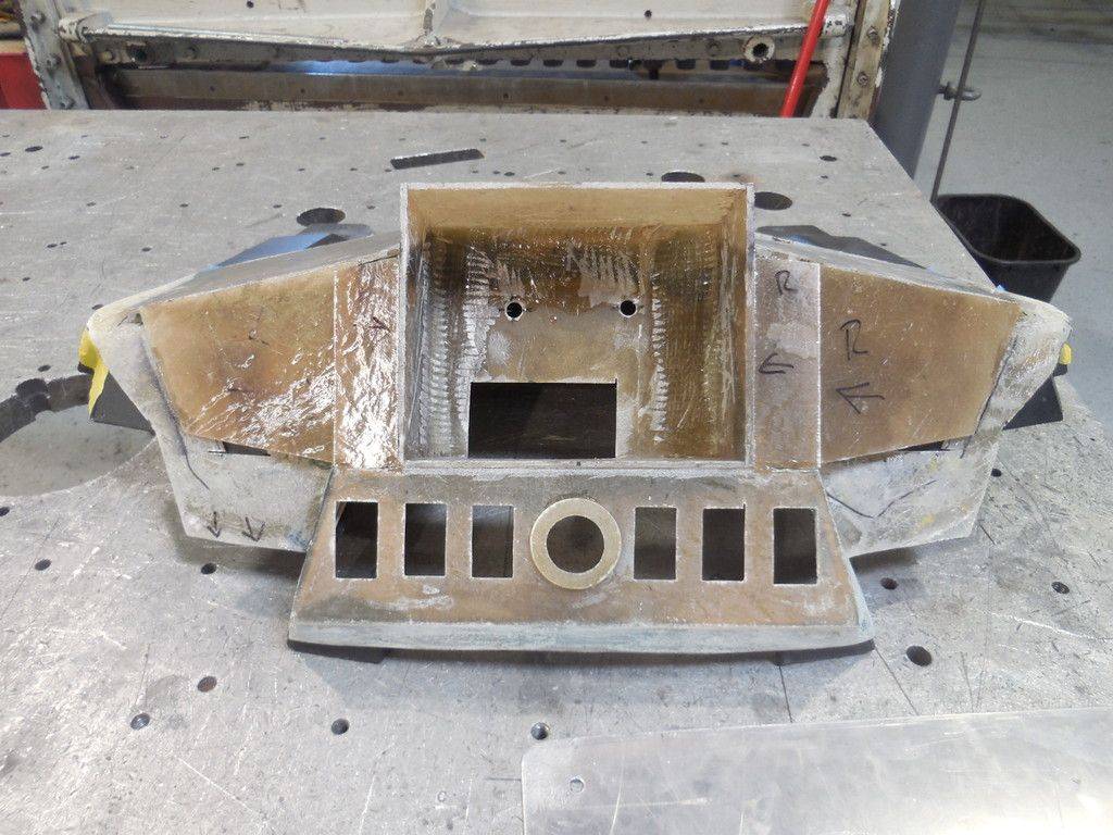

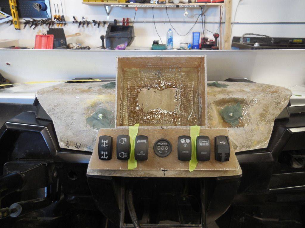

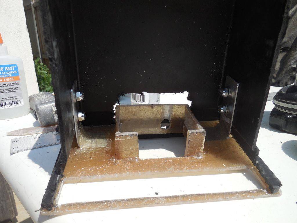

Fabbing the instrument cluster pod. I will be swapping out the oil pressure for an Alba CVT temp gauge.
Full tilt of the steering column is retained.

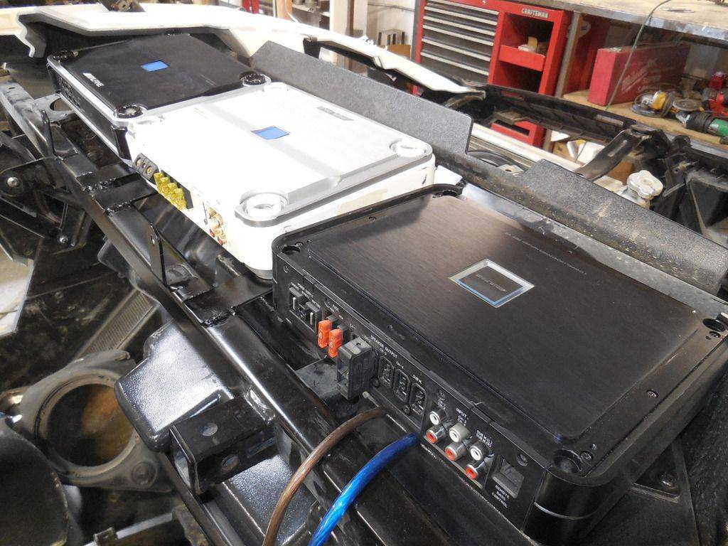

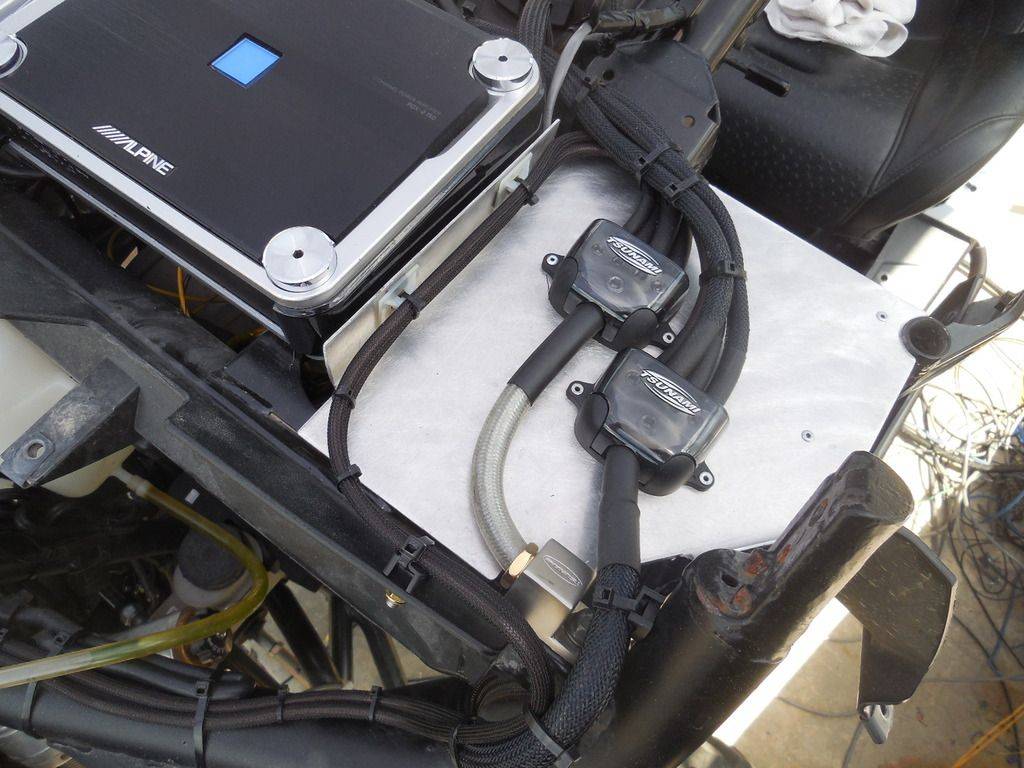

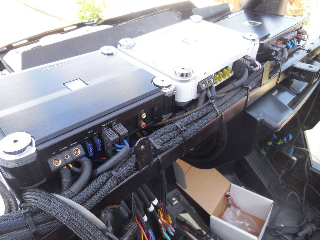

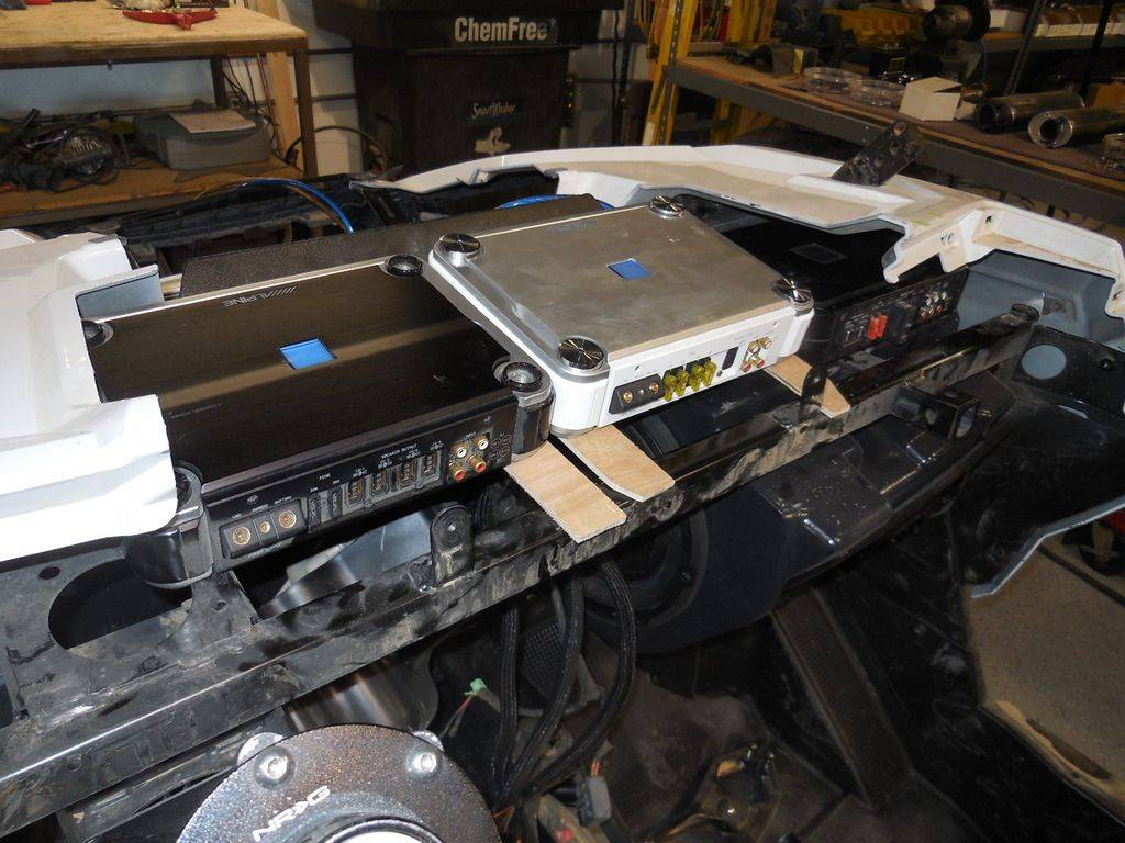

Mocking up the amps, welded in brackets.

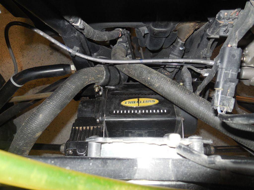

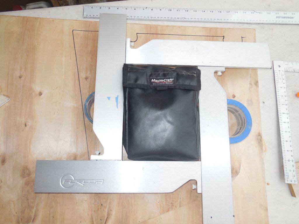

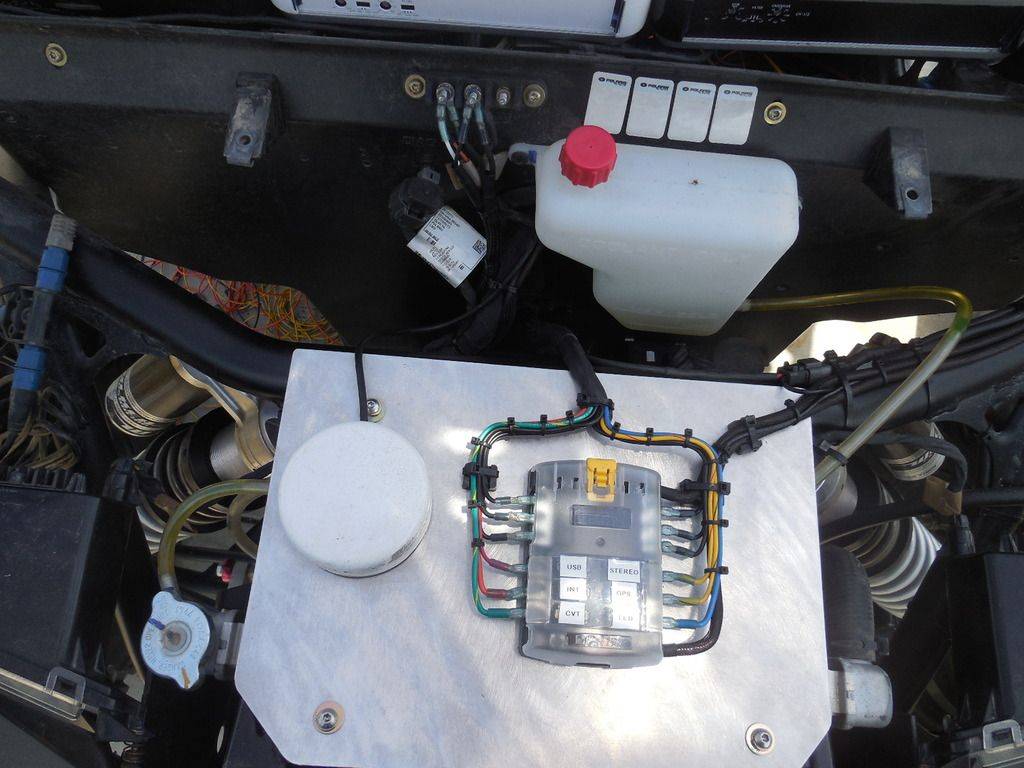

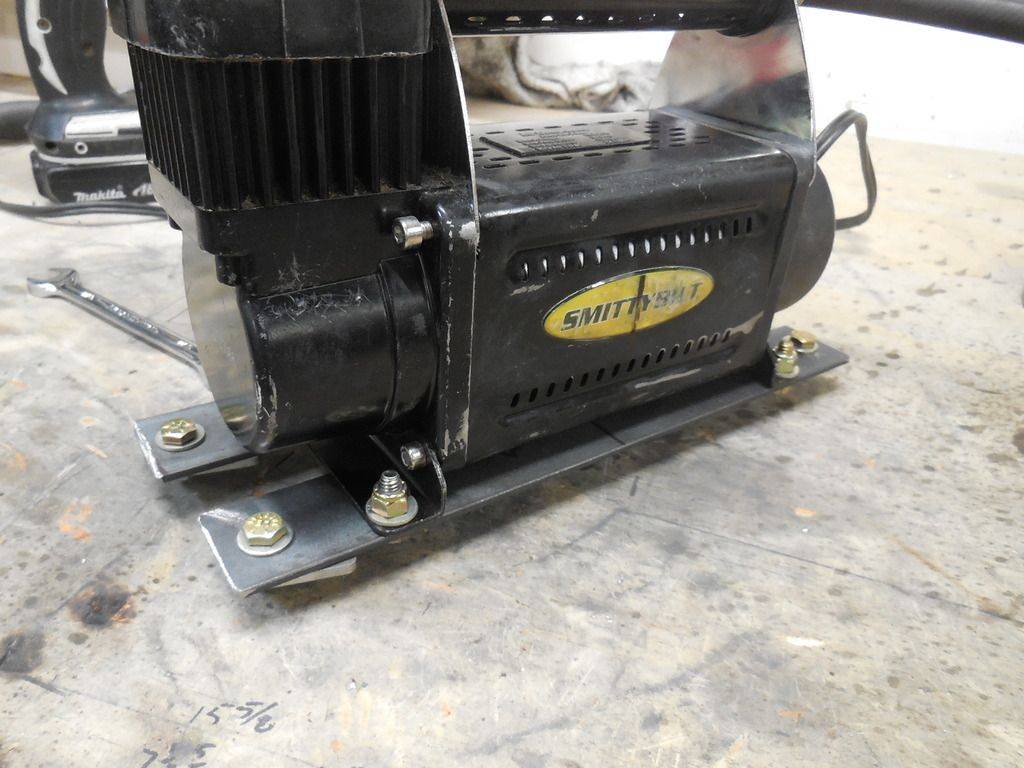

After strapping this compressor in the bed of my last 2 RZR's, I wanted to make this a true onboard compressor.

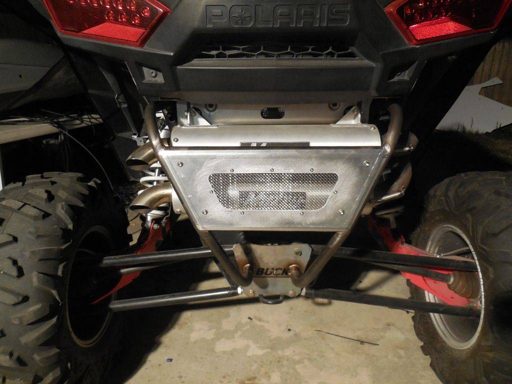

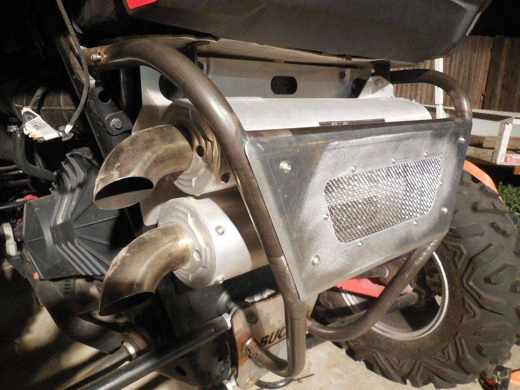

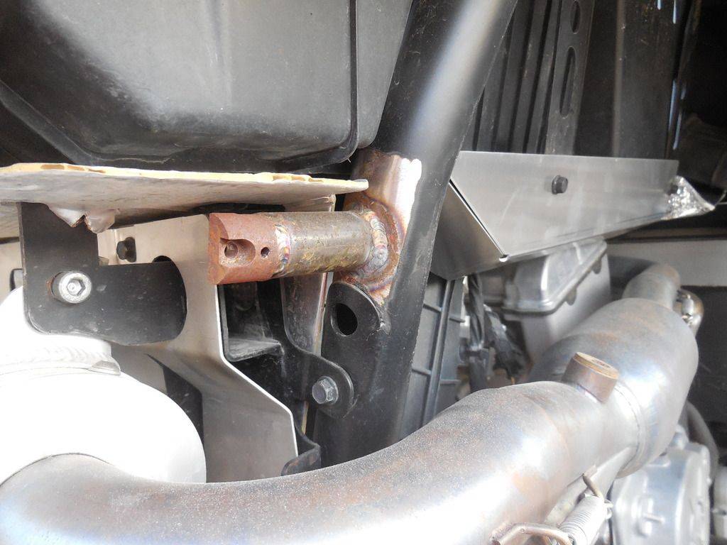

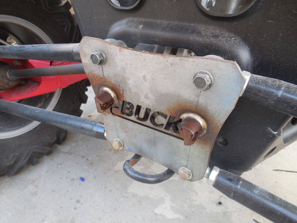

This work I can't claim. This was done by one of the guys at the shop. I wanted some protection for my Muzzy's exhaust.
