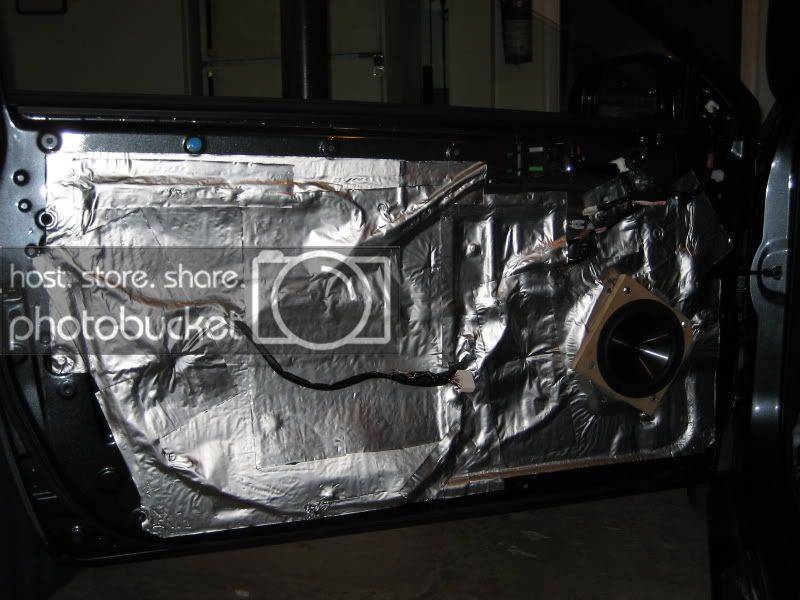

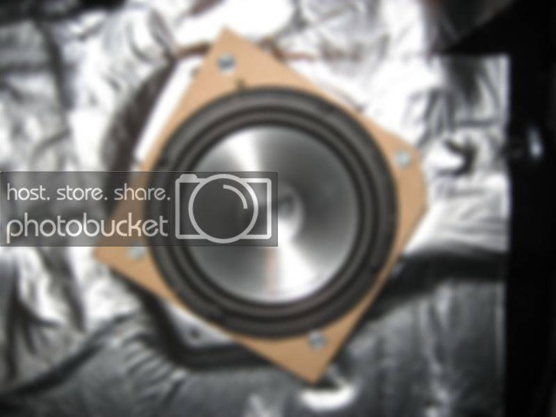

well today i installed a set of Phoenix Gold RSD 6.5" comps in my Scion tC. the install was fairly easy and painless for the most part. i installed the woofers in the doors and the tweeters i flush mounted in the stock kick panels. the set is being powered by a kicker zx550.2 amp with the gains set with a -3db 1khz tone to 150wrms per side.
once i got it all wired up, before i even had the tweeters in their spot i turned it on and made sure everything was good to go. the first thing that popped into my head was "wooooowwww listen to all that mid-bass". just like all the reviews say, the mid-bass is absolutely amazing. especially for the size of the driver and the price you get the set for. the woofers really don't look very beefy but they sure sound like they are. my doors and deadened and sealed though, so if you just drop them in w/o doing that the results might not be the same.

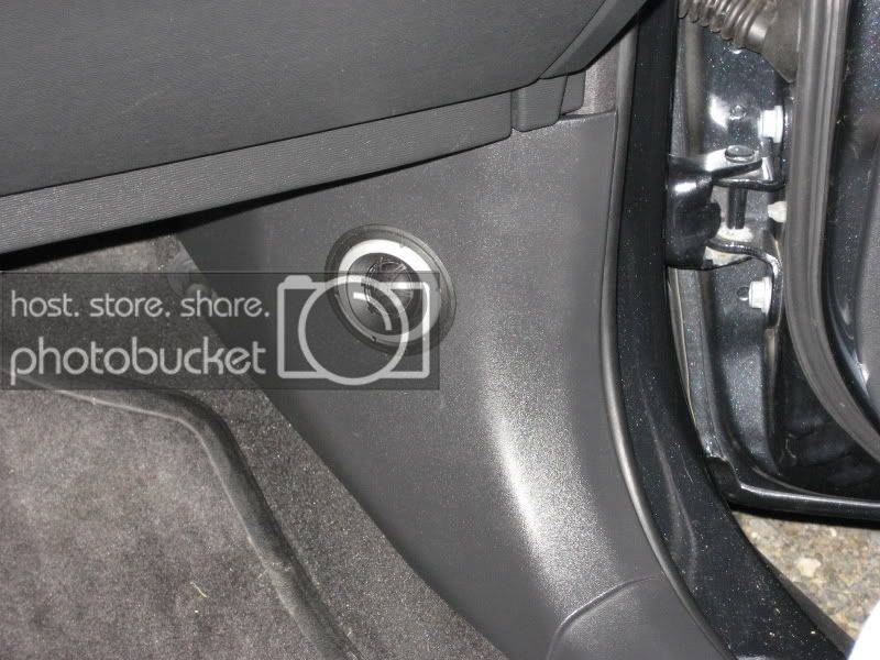

now onto the tweeter, at first i didn't know what to think. i had a slight imaging problem right off the bat. but the guys over at phoenix gold saved me with the sweet pivoting the tweeter offers. i first tried pointing the right side at me(the driver) and the left side at the passenger headrest. but that really made the stage sound weird. it sounded very to the right side of the car. but even with the tweeter mounted down in the kick panel i was able to easily make the sound stage sound like it was much higher than it looks. now when female vocals are played they sound like they are coming right from the center, kinda like the bottom center of the windshield or right at the top center of the dash. everything sounds very good and very centered.
