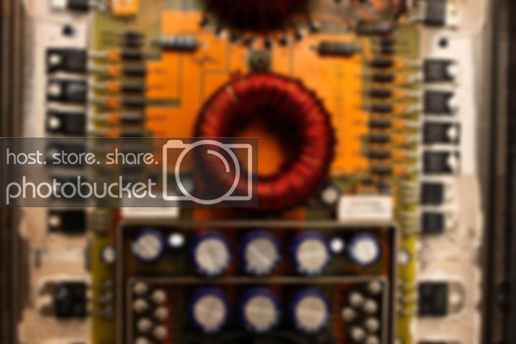

A/B There's a lot of efficiency gain to be had with modern class D. Also electrolytic capacitors degrade over time. At around the 20 year mark you may start running into trouble. Assuming failed caps don't take down anything else an amp like that is still probably worth the price of repair when it does happen.

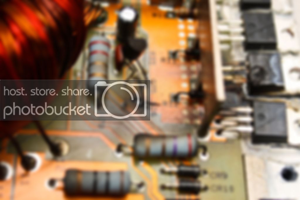

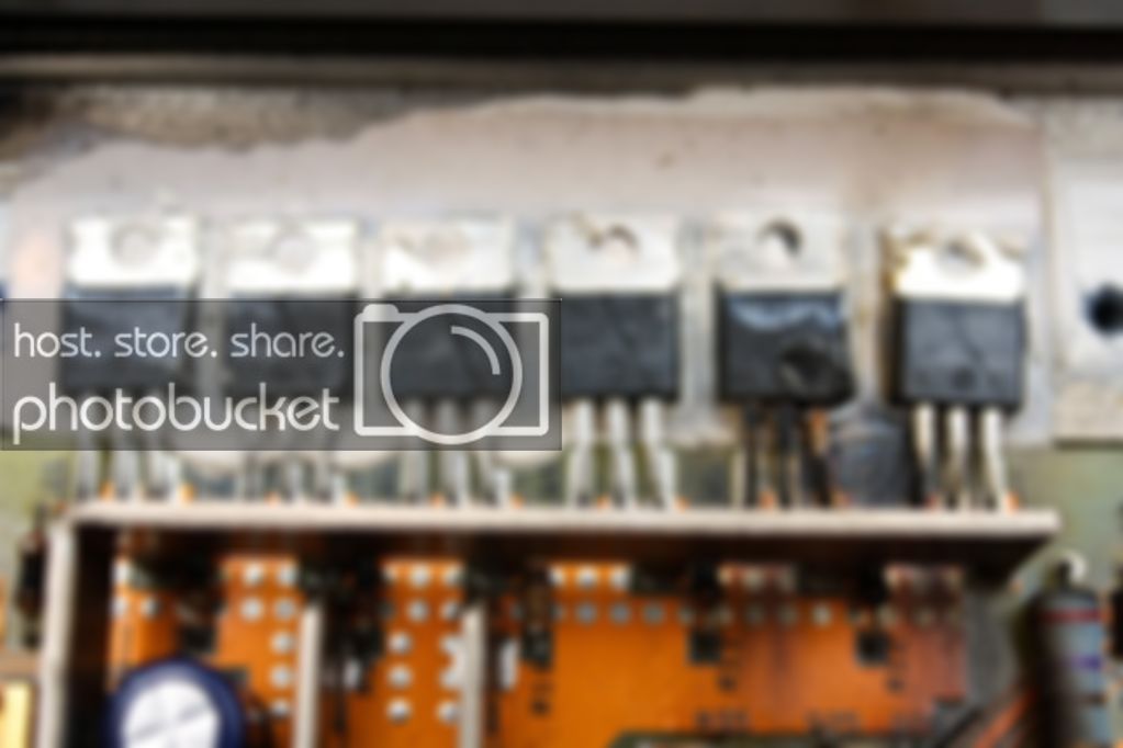

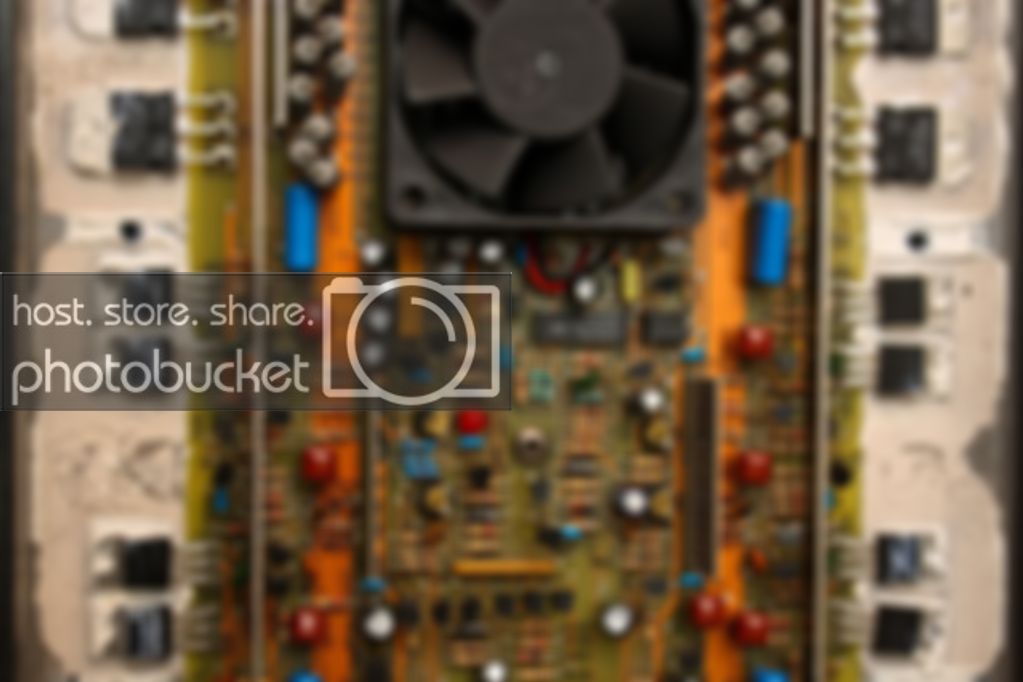

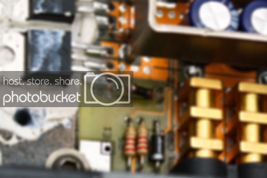

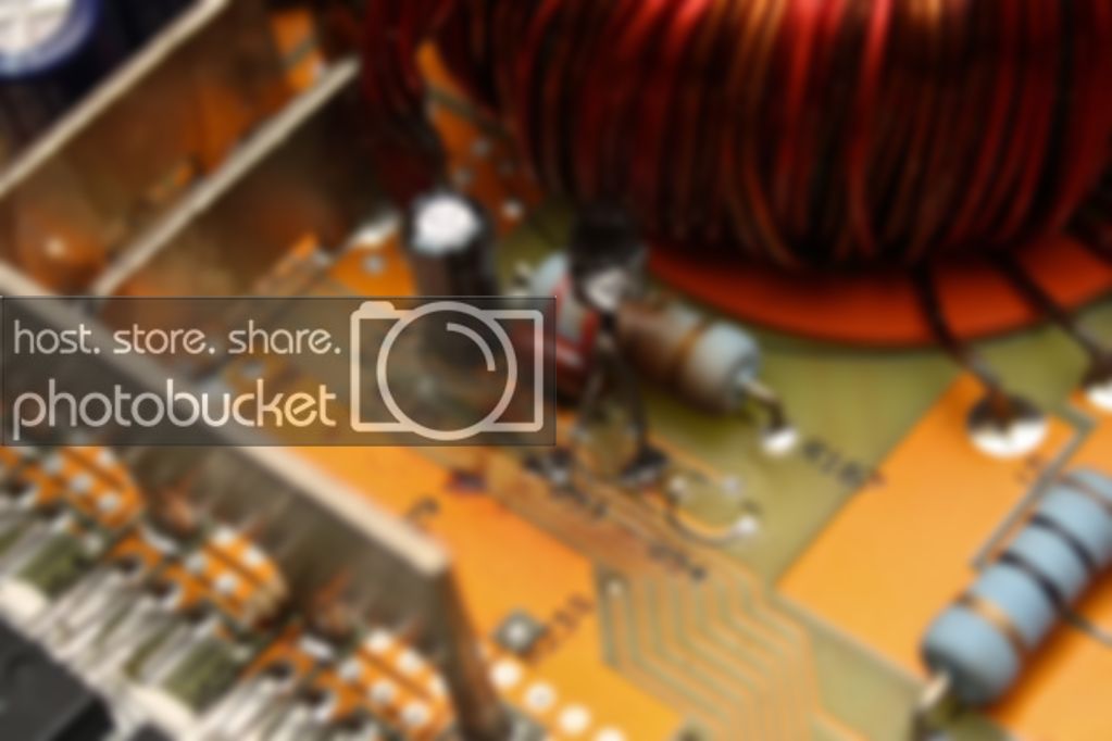

It's actually on its way to the repairman right now. My friend blew it up.
Are there any parts I SHOULD have replaced to avoid future troubles? Like the caps?
With older amplifiers, its more of a waiting game till she fails,or min output received. I still run several old school zeds, pretty hard at times. I really enjoy old A/B under rated classics. By your pics, looks as if your friend ran that amp pretty damned hot! Like @ an ohm load it wasnt capable of(1 ohm).?or lower?Just guessing..lol.I run a pair of class D mono amps most of the time,on my subs,and like to switch out to A/B amps most of the time.Seems like it took me a few years to finally find a sub amp(new class d) that met my standards/expectations for the money.
The clown was beating the shizzy out of it, I heard. I wasn't there. It was hooked up to an Alpine R1042D@2ohms. The cone was stuck at XMAX.
