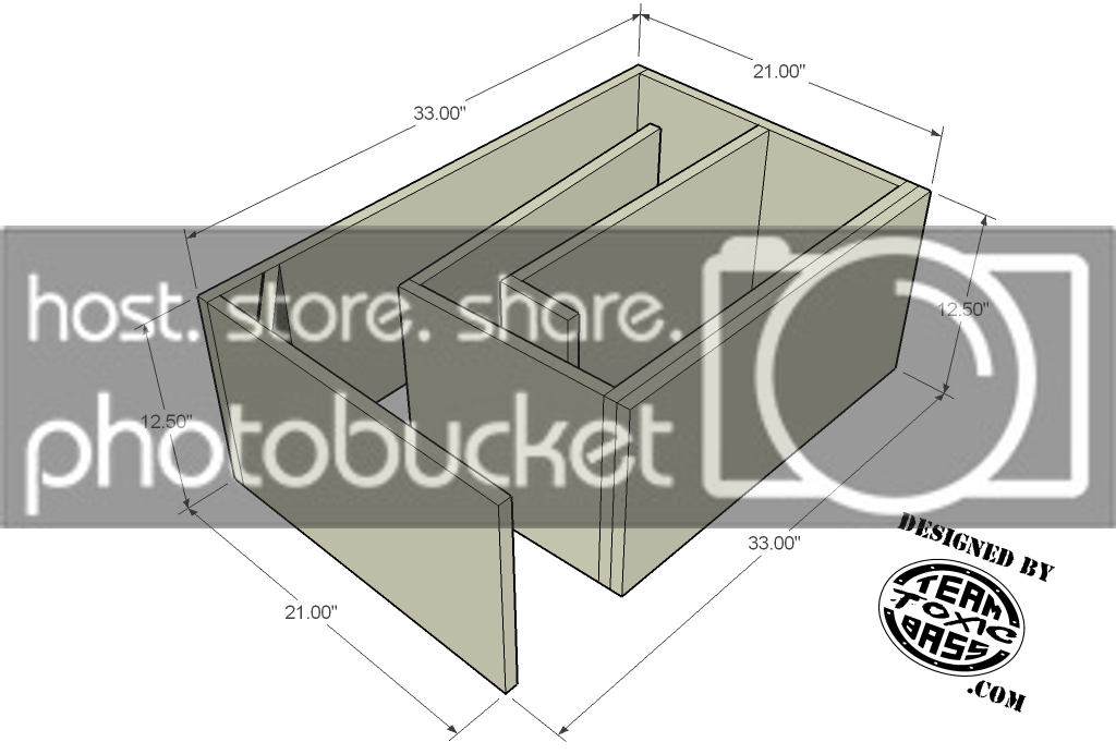

My new ABC box plans - whatcha think?

so wuts the deal of two chamber and small port everywhere?
To you and anyone else who is wondering, this isn't some crazy design they made up. It's been around since the 50's in home audio. It's called a DBR (double bass reflex). Essentially you have two tuned chambers, and one chamber fires into the other, while both are ported out the front. Never heard one that I liked, but they do get nice lows. While it is a little different, it's still a DBR at heart.
One diff though is the pic your showed has only 2 ports, whereas an ABC has 3.
AHHH! He's right. Someone told me that they were just "modified" DBR's. Lemans is wrong again //content.invisioncic.com/y282845/emoticons/frown.gif.a3531fa0534503350665a1e957861287.gif
