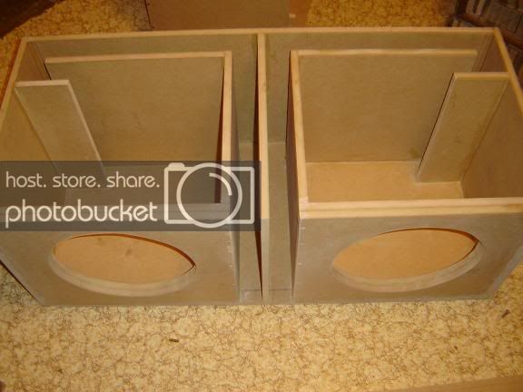

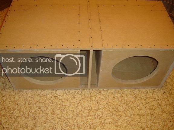

Ok guys here's a few pics I have of the current box I just got done wit hfor the mag's. 3.5 cubes after port and displacement tuned to 28hz //content.invisioncic.com/y282845/emoticons/biggrin.gif.d71a5d36fcbab170f2364c9f2e3946cb.gif
On a side note this was built with a circular saw and a jig with the aid of a 3/8 dewalt drill. Next time I'll get ahold of my friend with a cabinent shop.
