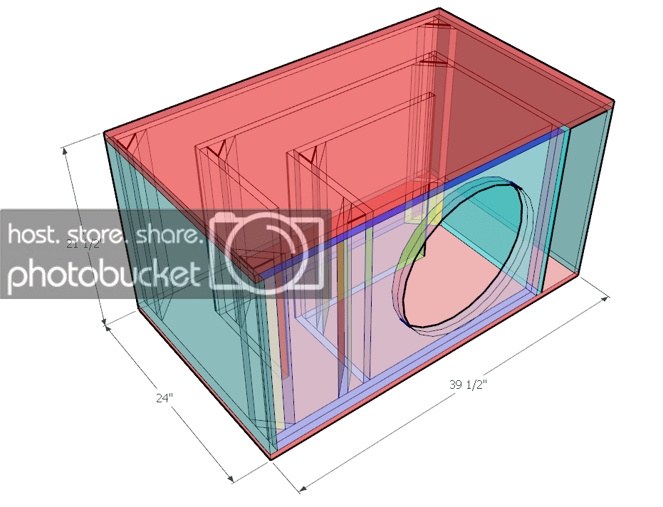

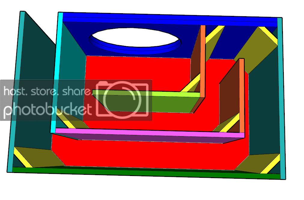

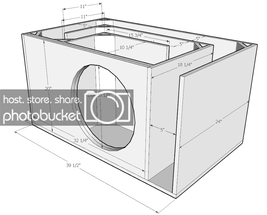

Going to be starting an interesting transmission line build sometime this week probably.
heres the design thanks to immacomputer
Thought i'd start a thread now so i dont forget later.
That should pound. Assuming dual 2s. Let me know if you are interested in a mate for that I have a mounted SSX18 but never powered that I could make you a hell of a deal on. PM me if interested.
what airspace and tuning if i may ask?
Well, tuning is relative but if you're asking for the 1/4 wave length frequency, it's ~31hz. It puts the sub in about 8 cubic feet of airspace but that's a pretty meaningless spec here. It should be able to dig down into the 20s and have pretty nice output up to the 70s or so.
