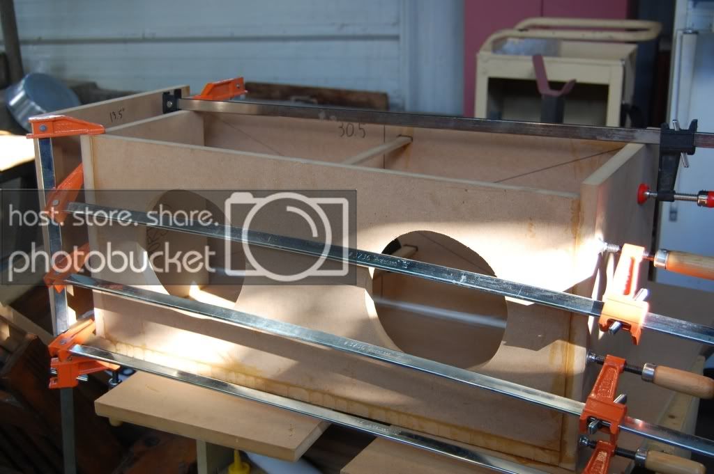

I'm already on the final stages...
2 cubes @ 40hz (hopefully)... the port width from the rear of the box to the port wall is gonna be shorter than the port wall to the side of the box by 1/8" >_
One question I have though before I continue on... if the port bends 90 degrees after passing a corner of the box and then ends, would my end correction be .425 + .425 + .307, assuming 2 flanged ends and 1 free end, or should I just assume a total of .732?

Is there going to be another port wall? I'll post a picture of how to calculate end correction with one end being a wall.
That is how you measure the end correction. Measure down the middle like always, then add half the width of the port to the line length you have.
The left port has a length of 19.75" and the right port has a length of 16".
Ahh I see. Thanks man! I'm gonna start cutting the port and glueing it in.
