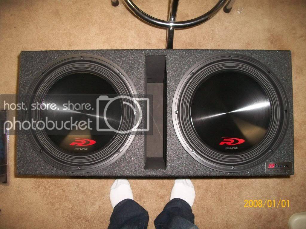

2 Alpine SWR-12D4 5th gen subs, in a Atrend BBOX shared port enclosure. @ 1ohm

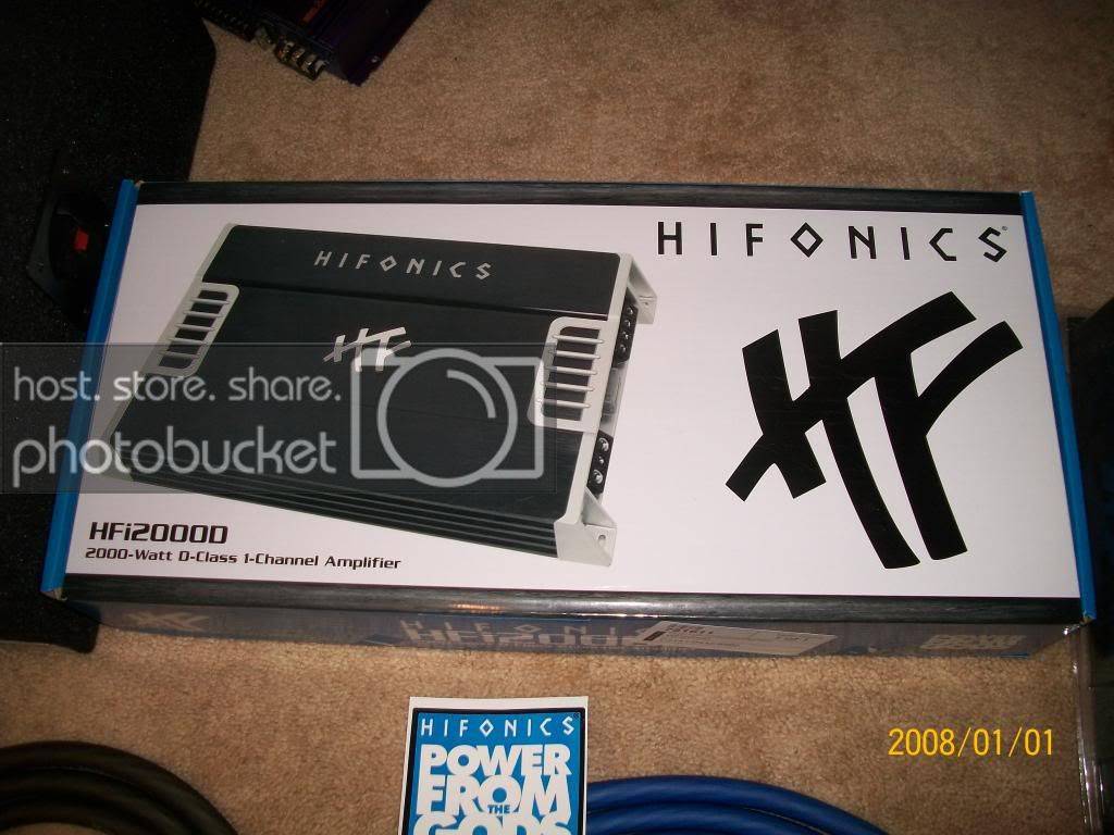

2000watt RMS @ 1 ohm Hifonics Hfi2000d Amp.

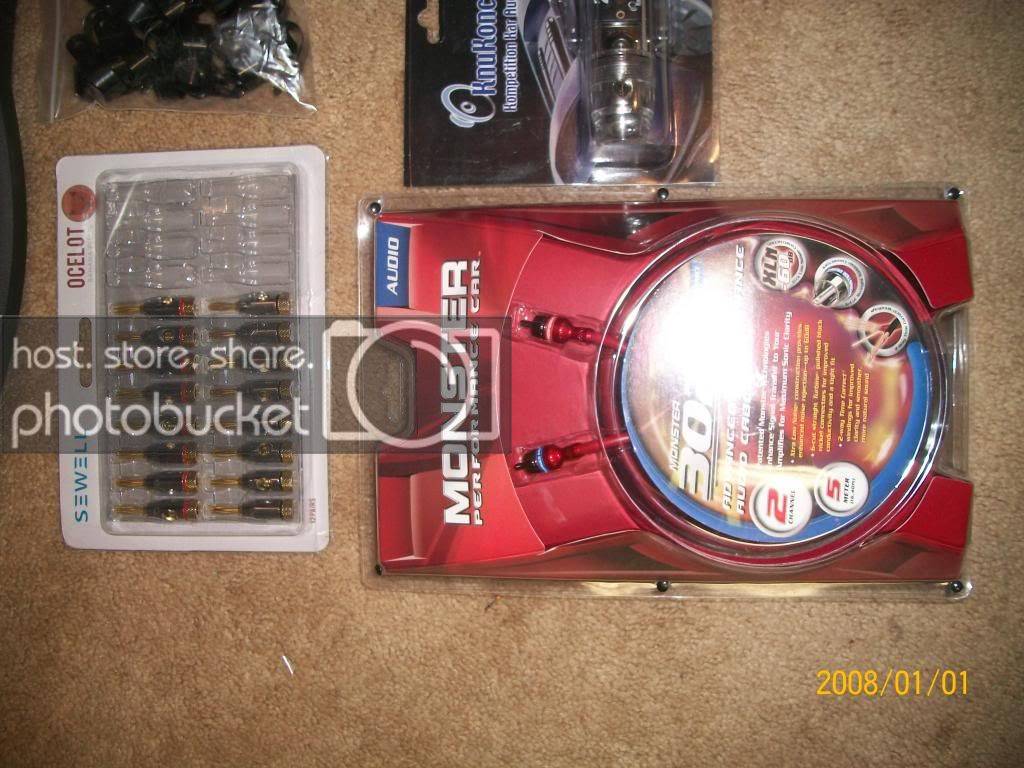

Complete O gauge KnuConceptz Kolossus Flex Wiring supplies, picked out all my own stuff. didnt buy a kit. Monster 12 Gauge Subwoofer Speaker Wire For sub leads.

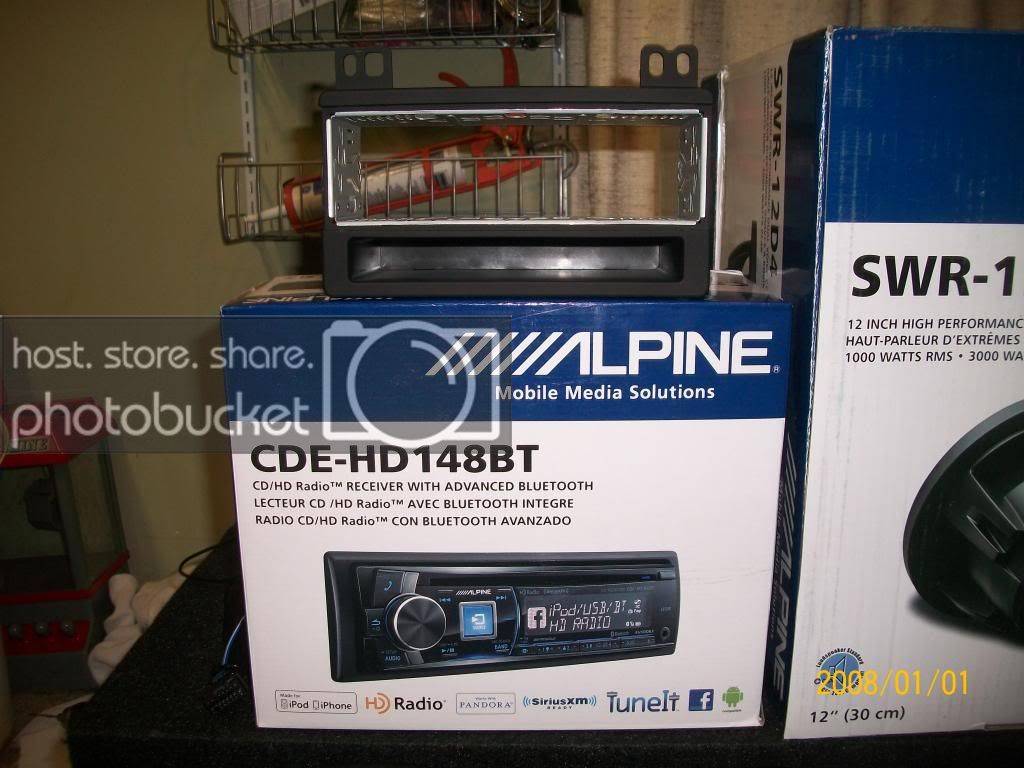

Alpine CDE-HD148BT Bluetooth Source Unit

thanks! and i will. what do you mean by a "dirty" signal? id say the weakest link is my amp which isnt the best i know but its the only thing i could get near the power that the subs are rated for at a decent price. my RCA's are these: Amazon.com : Monster MPC I302 2C-5M Extra Low Noise 2-Channel Car Stereo RCA Cables (5 meters) : Vehicle Amplifier Stereo Patch Cables : Electronics

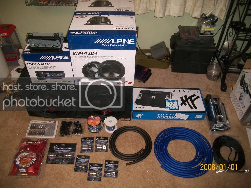

got some work done today. not as much as i would have liked to, but with all the christmas activities i just barely got started, but like i said im taking my time with everything and doing it right the first time. Pics up within a few mins so people like ~ Only The Best ~ will actually believe i have this stuff, and what is a build thread without pictures? Merry Christmas Everyone, although it is technically the 26th, its the first time i have had to get on here. //content.invisioncic.com/y282845/emoticons/santa.gif.e1ec9cf2e0a0dd232ad35aa594a126d0.gif
Also while my photos are uploading to photobucket, my subs say that their tuning should be from 35-37 Hz in a Vented Enclosure, but my box is tuned at 39. Since this isnt a huge gap im not terribly worried about it. but since my amp has subsonic on it, which should i set it at? at first i though 38 because its right in between, but then i thought since my box is no longer going to perform optimally anymore below 39, i was going to set it at 39 or a bit higher to be safe. Anyone have any input on that? ill bump this thread in the morning also since more people will be on during the day rather than 130 at night.
So here is my giant pile of fun.
the subs werent mounted in the last picture, just sitting there. the next post will show the first thing i did, which is mounting, and building harnesses and wiring the subs into the box.
