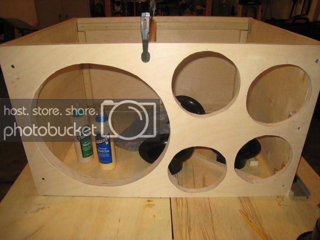

My first box, 4 4" PSP Aeros and baltic birch imported from russia :) *pics*
cdimic25
Me and my step dad are almost done.
Tuned to 40hz with all ports, then plug to 35.
Baltic birch was 70 bucks for a 5x5 sheet....
BTW its 4.8 cubes after allll displacement. We are going to glass the whole inside of the box as well.

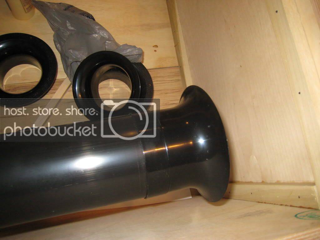

The port will work fine
a flared port doesn't have to be 4'' away if its 4'' in diameter
It looks to be 2/3'' anyway, I've done tons of installs where the port had to be pretty close to the rear to get the tuning down, worked just fine
Gotta remember it isn't like a slot port where just one area of the port is being loaded

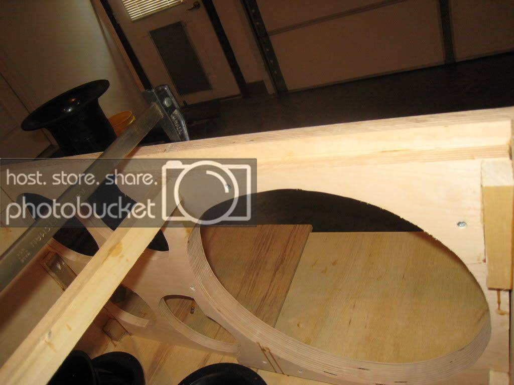

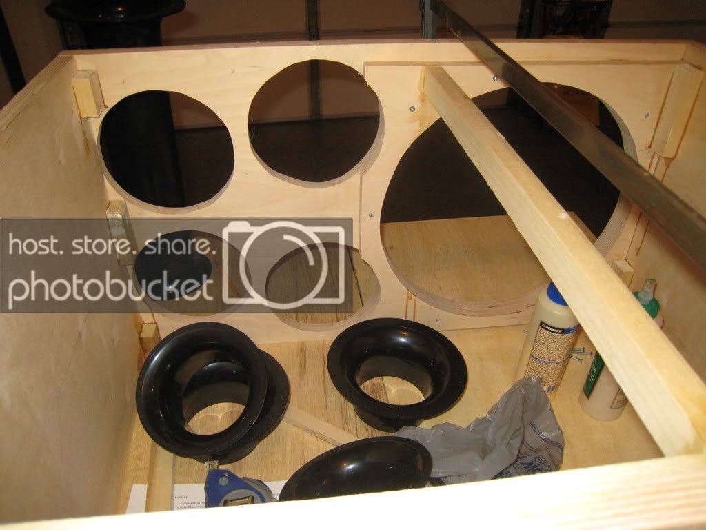

looks like you screwed your self on the baffle ... sub looks like it will have to over lap the port or the port need to be cur a hellla lot once there both in there
