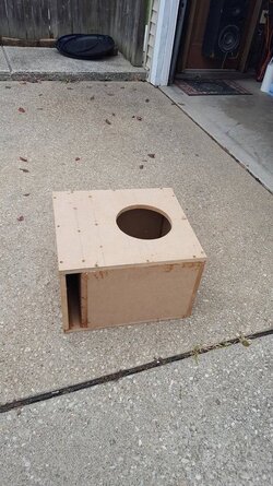

So I've built around ten boxes before and have designed many for my buddies they always were very musical and hit hard all around. (always had 15s) But I've built my first ported enclosure for a 10" skar vvx and It sounds goob except that it really lacks in the punch the really quick bursts of bass that really hit hard and on point. you can hear them but not loud like normal, the rumble really over powers them in this build, unlike others.

box is 1.4ft^3 I didn't account for displacement because I wanted it a little smaller. tuned to a 35hz I assume the box got smaller due to disp. so probably tuned a little lower

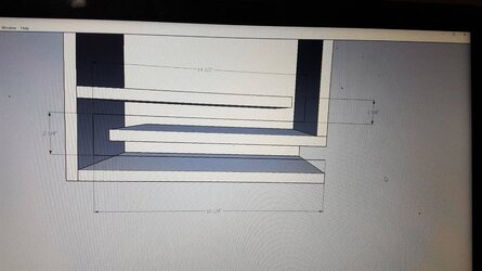

in theory this is what I was going for.

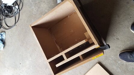

port area 12×2
port length 32
box without disp. 1.4 cft
I used sketch up and a port length calculator. I tried ajdesign also. the calculations were very similar between the two
well here is the measurements from sketch up it was actually 35.something, I didn't have access earlier, i was at work. But either way it's just not the same as 15s man especially going from two RE double x 15s
You know what guys I went out and changed the crossover on my excelon a little bit it sounds a lot more punchy and picked up what it was lacking i dropped the LP to 90hz instead of 120 and the drop off to 24bd instead of 12bd. boosted 160hz 1db. sorry bout that forgot to tune that damn eq
So if the 1.4cf is correct then its tuned to about 34hz. Airflow through the port is choked and turbulent with all of those bends but you have 1/5 the cone area of those 15s so there's going to be a difference in output.
so to decrease that turbulence should i go with a port with less bends and closer to a 1:1 ratio for port L×W if possible
